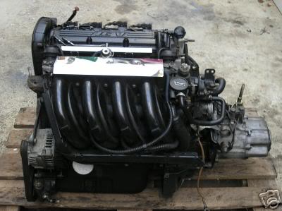

Andrew this is not the engine I found on the PR-net as any 2.0I 16V ?
My problem is that PR-net shows ALL the 2.0L engine variants with the oil dipstick at front.
Any engine looking like your picture - and with a rear located dipstick - would be either a 1.6L or 1.8L engine :?
What is the exact engine code on your engine ?
This is ultimatively important to get the correct parts.
Down the block on exactly the side viewed on your image usually is casted a code referring to the engine type/size.
On opposite side a tin plate or self adhesive sticker is found on the block with the engine code.
Certainly looks like your Xantia engine has been replaced some time over its life !

andmcit wrote: LOOKING INTO THE ENGINE BAY THE ACTUAL DIPSTICK IS ON THE REAR LEFT OF THE ENGINE NOT THE MIDDLE FRONT!! [piccy shows the driver's eye view!!]
Surely the dipstick pictured is in the front right of the engine rather than the rear left ;)

Something is odd -
Lets get a close up picture of engine with the dipstick clearly visible.
- and find that engine code please !

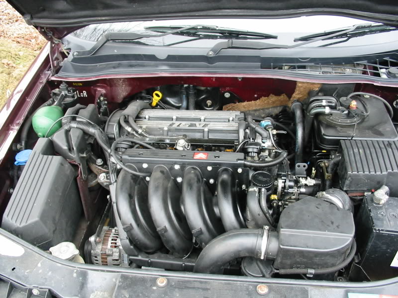

The engine is MOST DEFINITELY A XANTIA ONE - I've got 3 of em and they're not converted - trust me [I'm in advertising...:wink:]
I've even taken a picture of this apparent mythical beastie but it's currently downloading off my full digital camera!!
Ok, this is the engine in question, and look where the dipstick is...
And the breakdown illustration where I get part number:
05 1174 17 ENGINE OIL GAUG - INJECTION XU10J4 AND WITHOUT AIR CONDITIONING, is on this screen;
I must have been removed off PR net about 10 times now, but it's been interesting logging back in today though!!
The way I see it, the time I'm wasting on PR.Net will save time at the local Cit PRATS counter on tuesday...
All the best,
Andrew

117417 ENGINE OIL GAUGE £7.24 £8.51 with VAT
Posh name for a dipstick mind. Let's see what this brings me...
Andrew
andmcit
Posts: 4299
Joined: 03 Mar 2005, 17:59
x 30
Unread post by andmcit »
COMPLETE WITH THE WRONG DIPSTICK - AT THE BACK LEFT!! BTW, it IS a dipstick pipe REALLY - I did check the owner's handbook.
Yes, OK - I know, it IS a skiddly effort of a battery isn't it. I did only get he car on Monday evening...
I'll happily accept there's evidence the engine MAY [just may mind] have been out of the car, as the 112k miles may have seen a new clutch but all the car's SH is lost forever! There are signs that someone has taken the trouble to reconstitute the sort of clips/plugs'n brackets that get a bit 'distressed' when it all get's ripped out for a clutch job.
This doesn't explain the other two L & M reg 16v 2.0i's I've got AND ANOTHER spare engine that all look the same!!
I've got 3x of the later silver banana manifold 16v's to know what they look like too...
It just may be possible I've got a decent dipstick on the spare engine I have, but there's the vague recollection that it had been smashed up a bit when the engine was moved about when I collected it...
Hohum
All the best,
Andrew

Okay Andrew - so we agree then :lol:
I was completely confused by the rear (drivers eye) view on the engine.
You certainly had me tilted for a couple of hours there :lol:

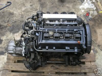

Apologies for inadvertent mind-bending Anders!! I've been getting nowhere with imageshack today and was about to post the following as well, but they didn't like it - photobucket do though;
may have helped, but I thought the position of the gearbox would help things...
Simon; I've got the part number, as I've said already, I can but try it with them. Problem is, they do like to make a fuss and suck on their teeth and tut etc.
It's a BIG DEAL if you want something that isn't for a C3...
All the best, Andrew
