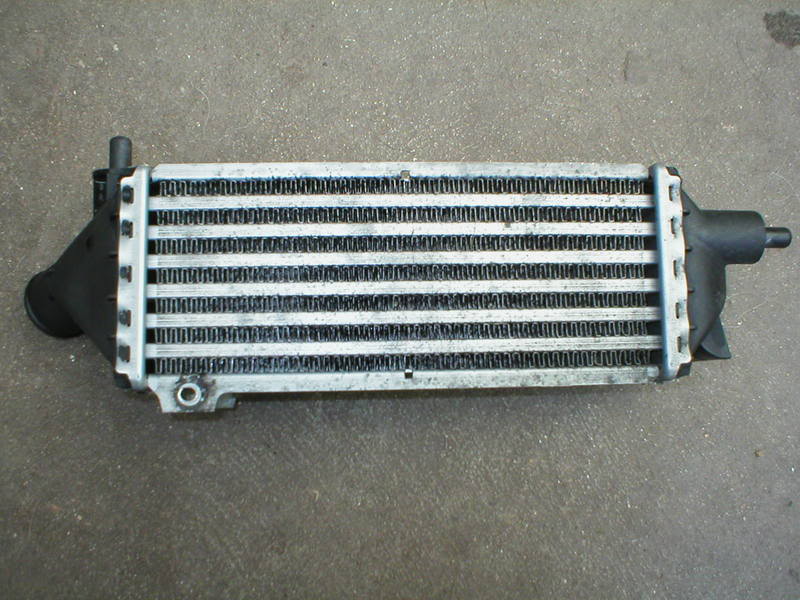

Hmm! must get hold of one and offer it up , theres a lot of space in front of the rad, trim the bumper a bit, fans relocated in front of intercoolers, pipework under the bonnet looking like a darth vader octopus, i cant wait...

I would have to say that the intercooler you have would be superb sitting in front of the gearbox, with a duct from the front airdam. Remember what you want is a pressure differential accross the intercooler, not just flow onto it. Of course it is also cooler down at the gearbox than in front of the hot rad as well in traffic. My Charade has the i/c in exactly that position as standard. I have moved it to the front previously and found no benefit. You could benefit on your small cooler in that position by running some tumbledryer ducting from the back of the cooler to the wheelarch as well to get an even better flow.
I never liked the design of the xantia ic. It seems that all the flow at lower boost will just go through the top 10% of the cooler. Plus it is a funny design, and I think the cooling fins might even protrude into the airflow inside the bars. It cant be that bloody big for no reason (apart from width restriction reasons).
I would stick with a single pass (i.e. no u-turn at end tank, pipes on either end), compact cooler. Best thing is to bodge the ic you have in and measure temps, move it and try again. What size are the inlet/outlet pipes on the blandeo ic?

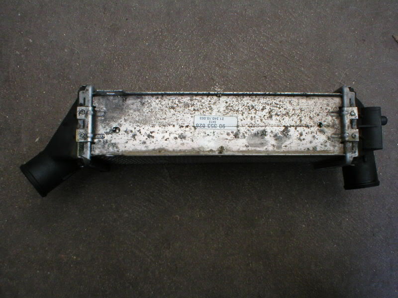

The in/out pipes on the mondy 'cooler seem to be about 2 inches, which I thought was a bit small, but looking at Allards website all of their performance coolers have this size pipes. I tried a rough placement for the cooler yesterday, I can just get it to fit, the only pipe that gets in the way is the inlet for the air filter, this would be easy to move though. The advantages with it being down by the gearbox are a) easy to place without major mods b) plenty of airflow and easy to duct air towards it c) no need for lots of expensive stainless steel piping to be made up

Every OEM intercooler (apart from a Rover 218td!) I have ever seen has plastic endcaps. Most of the tubing from the turbo is plastic anyway, so some plastic endcaps aren't going to be the end of the world.
<hr height="1" noshade id="quote"></blockquote id="quote"></font id="quote">
Intercooler on my 220sdi had end caps made from metal (alu?), shame its been scrapped now - I think in terms of size it was quite a bit thinner than the mondeo one you have, would have fitted no worries- try looking for 420sdi and 620sdi's in the scrappers- all have same i/c) Id be interested to see any pics once you have finished your project. Quite tempted to do something like this myself- bet the insurnace co' would try and have my pants down tho [:I]

Yes I did see a 220SDi, but already had the mondy cooler in my hand when I saw it! I would need to find a 110HDi in the scrappers tho, for the manifold adaptor and the pipe that runs from the turbo, under the engine to the intercooler. I dread to think how much that will all cost from a dealer! Trouble is, as soon as the breaker my way gets them in, he removes the engine and sells it!

out of interest, how much did you pay for the cooler? the end tank sizes at least <u>suggest</u> it will flow enough air. If youre going to all this bother, why not just lift all the intercooler gubbins from a hdi that had it originally? You will still end up making alot of pipework for your conversion to the balndeo ic surely?.

Well I'm not definatly going to fit it, it was just an idea and I got the intercooler to see if it could be implemented. I paid a fiver for the cooler, so even if I don't fit it, its not as if I have lost hundreds.
It would be nigh on impossible to fit an intercooler from a 406 110 or a Xsara, as the radiator is the full width of the front of the 306, whereas on the Xsara and 406 etc the intercooler is fitted beside the rad, as it doent cover the full width on these versions. I would use some parts from the 110 versions like the high pressure piping from turbo too intercooler and from intercooler to manifold, so its not really much of a job to do, I would just make up some pipework to join intercooler into the system.
