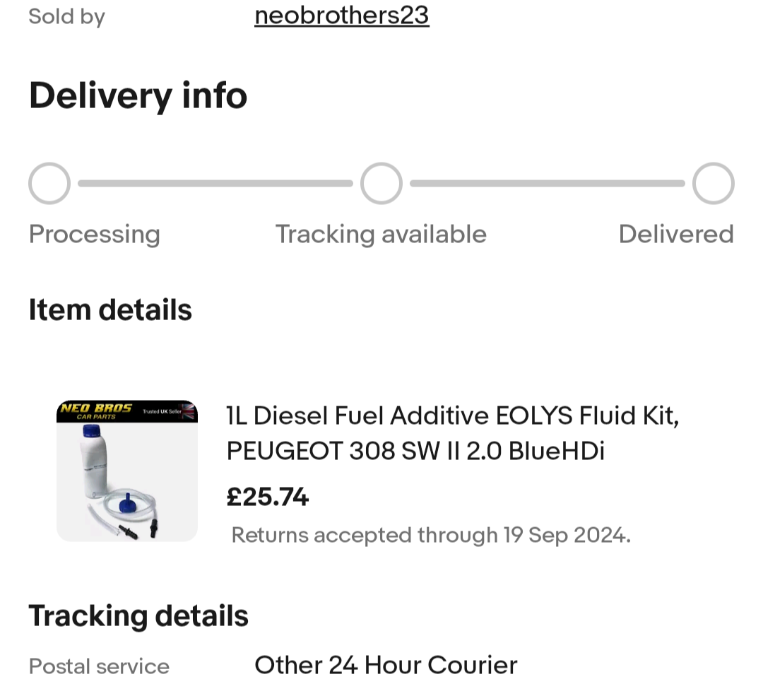

MattBLancs wrote: 18 Aug 2024, 08:54 Information kindly provided by Marc,
GiveMeABreak wrote: 17 Aug 2024, 13:42 Hi Matt - oops, sorry about that, must have missed your post.
You have a reservoir tank, not a pouch system, and require Powerflex additive.
Top up 1 litre minimum, official capacity is 1.4L, but shows actual is 2.0l.
Item (16) here: part number is: 1610115580.

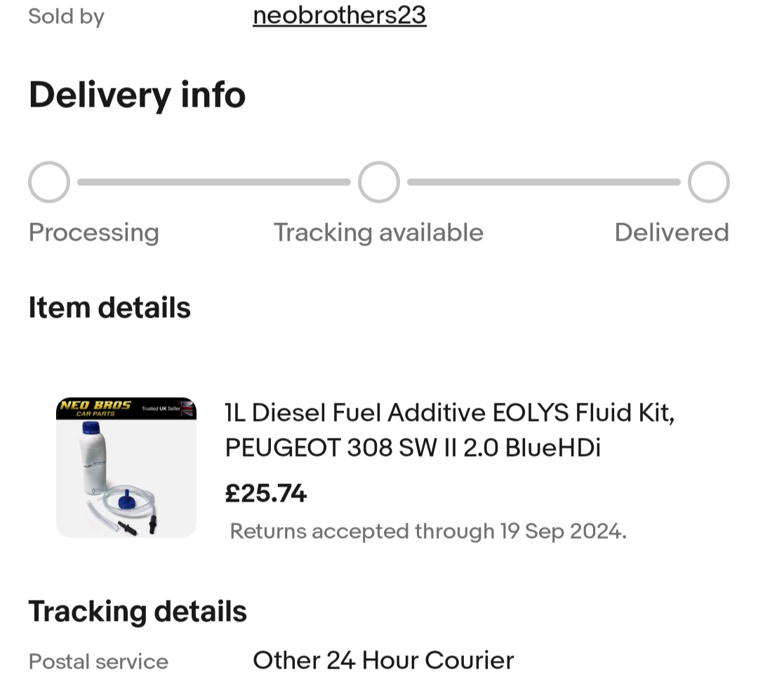

As it's powerflex (same as the other 308) I've gone for the same stuff I used on the Grey one:
EDIT: actually, different stuff to the grey one, nevermind. States compatible (with my specific model) in the description, so hopefully all good.
Was glad to read it's not a silly, vulnerable, pouch but a proper tank!
A few trips into the office next week, don't think the stuff will arrive before then, so fingers crossed it does not throw a code before next weekend

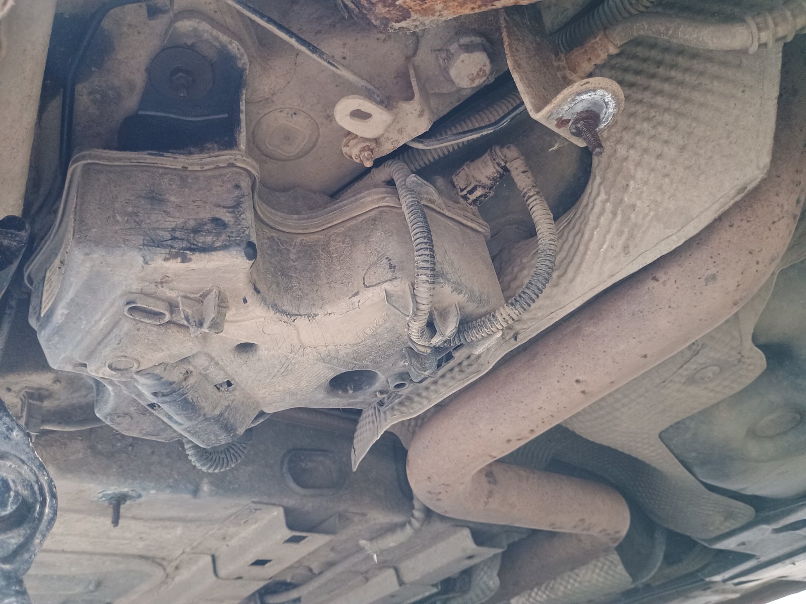

A couple of pictures before bed, DPF additive added to the Blue 308 this afternoon/evening.
Cover 3x M6 flange head nuts, then tank revealed.
Tank (formerly hidden behind cover)
Flexible hose disconnected and clear tubing of the refill kit plugged in to the end. Second short length of hose pushed onto tanks spigot and bottle onto this for any over spill.
The full 1 L of the bottle went in, no overspill, so seems the ecu's estimate of zero milliliters left is correct.
Software reset side of the job will be tomorrow's task.

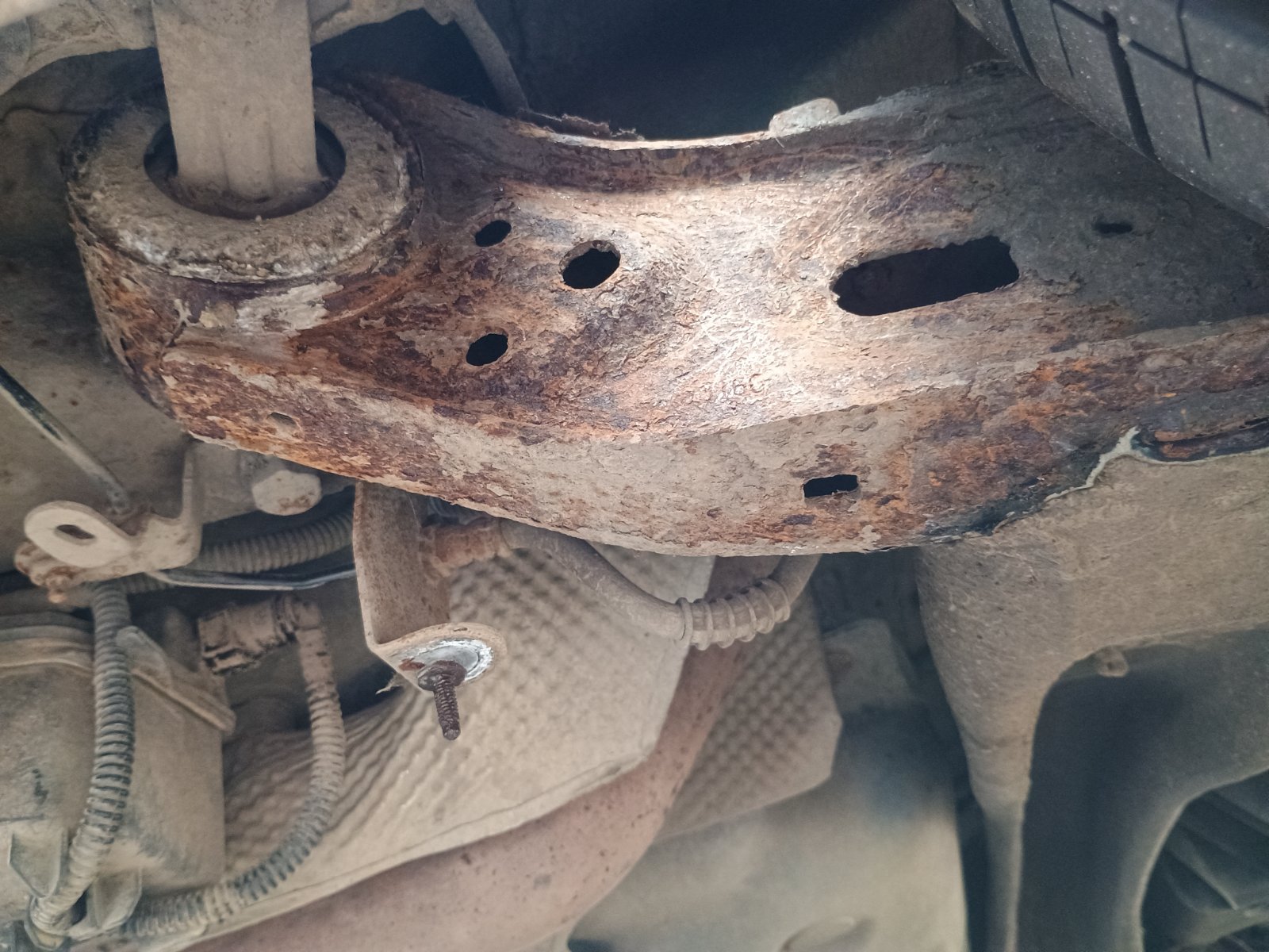

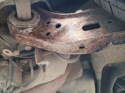

Rear beam surprisingly rusty so wire brushed and phosphoric acid applied. Coat of paint then coat of Tetroseal to follow tomorrow.
Crustyness
Crustyness

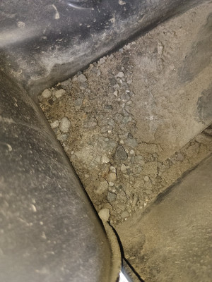

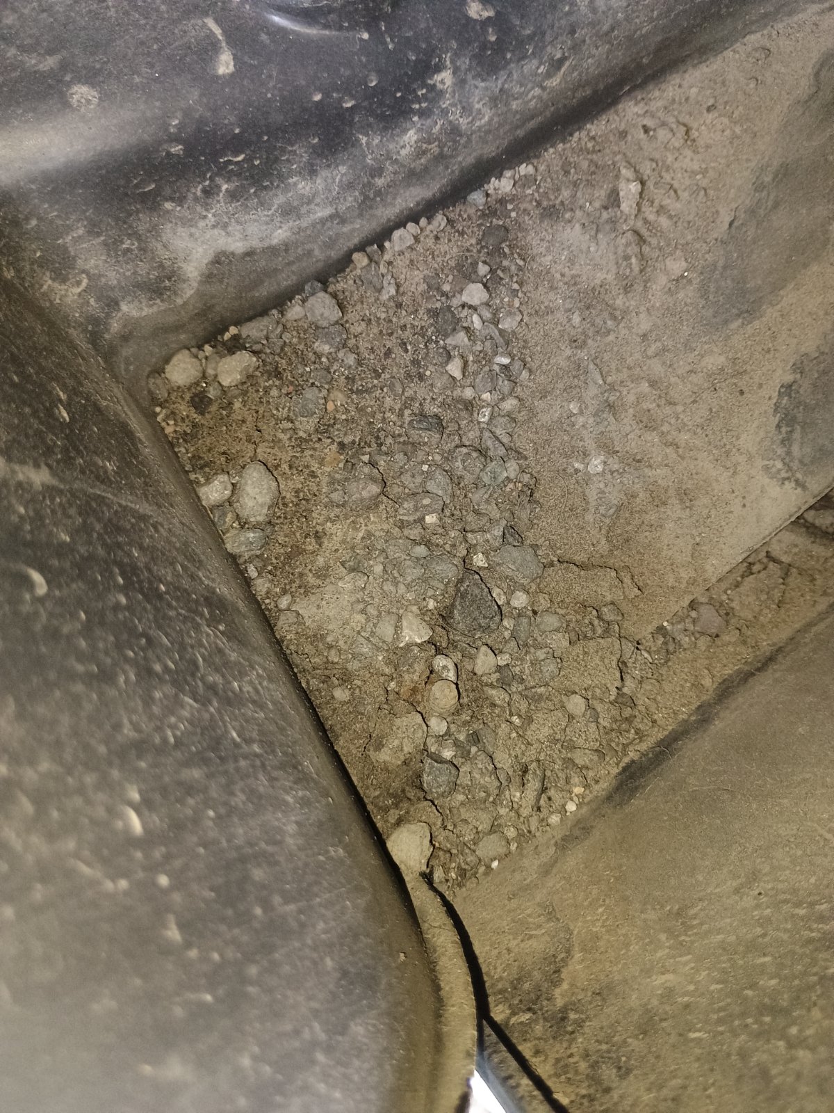

A few spots mostly rusty spots in the inner arch also needing treatment.

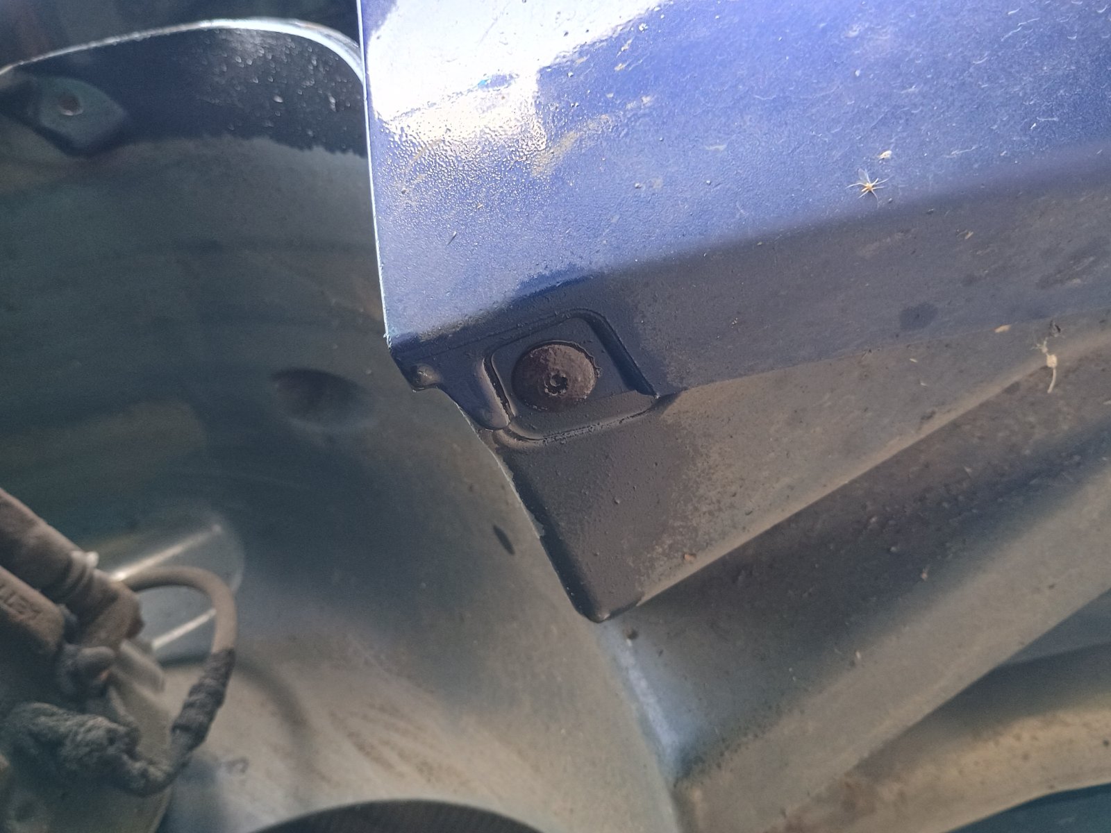

Plastic wheel arch liner needs wrestling off one fixing to edge of bumper putting up a fight still.
Hardly surprising given it seems to be living in a bed of accumulated mud!
Another fixing put up a real fight but thankfully overcome eventually
Don't think I'll be using that again!

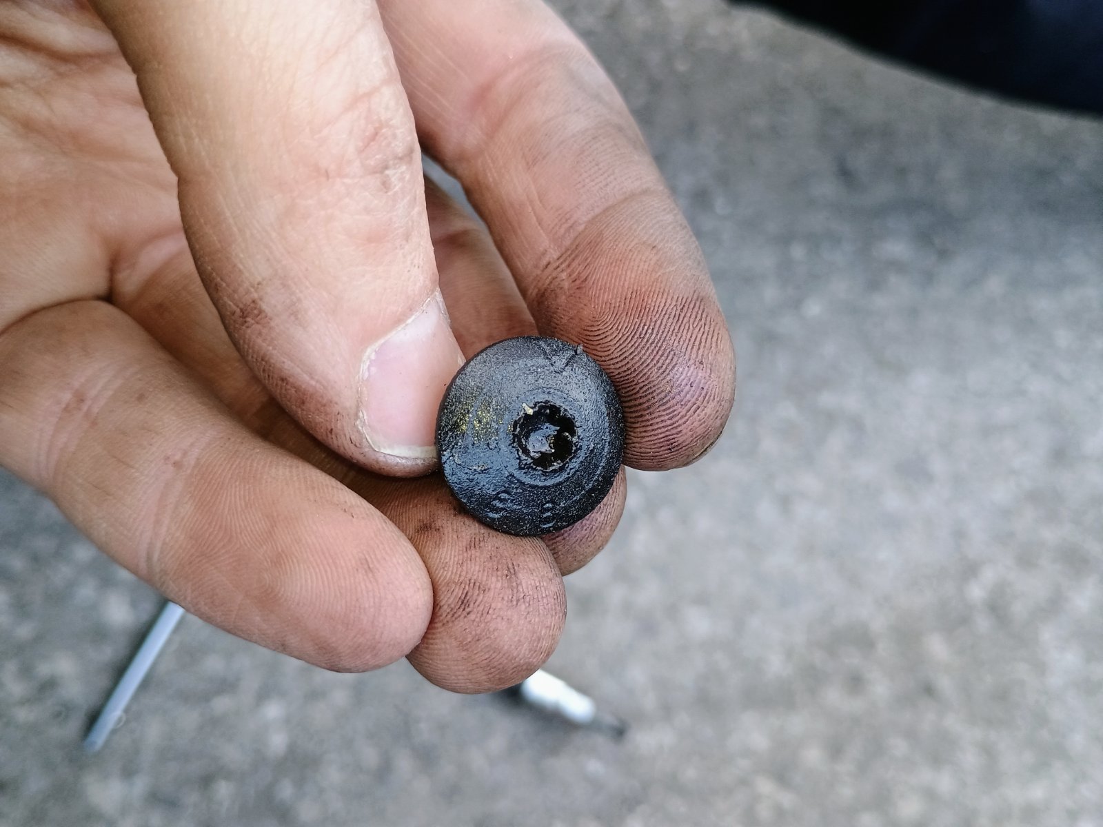

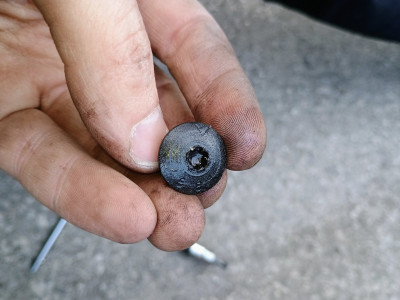

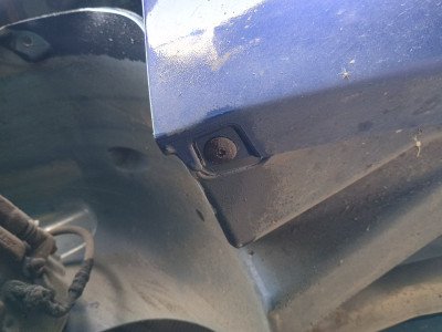

Not obvious / not anymore, but that's supposed to be a T30 Torx head bolt!
