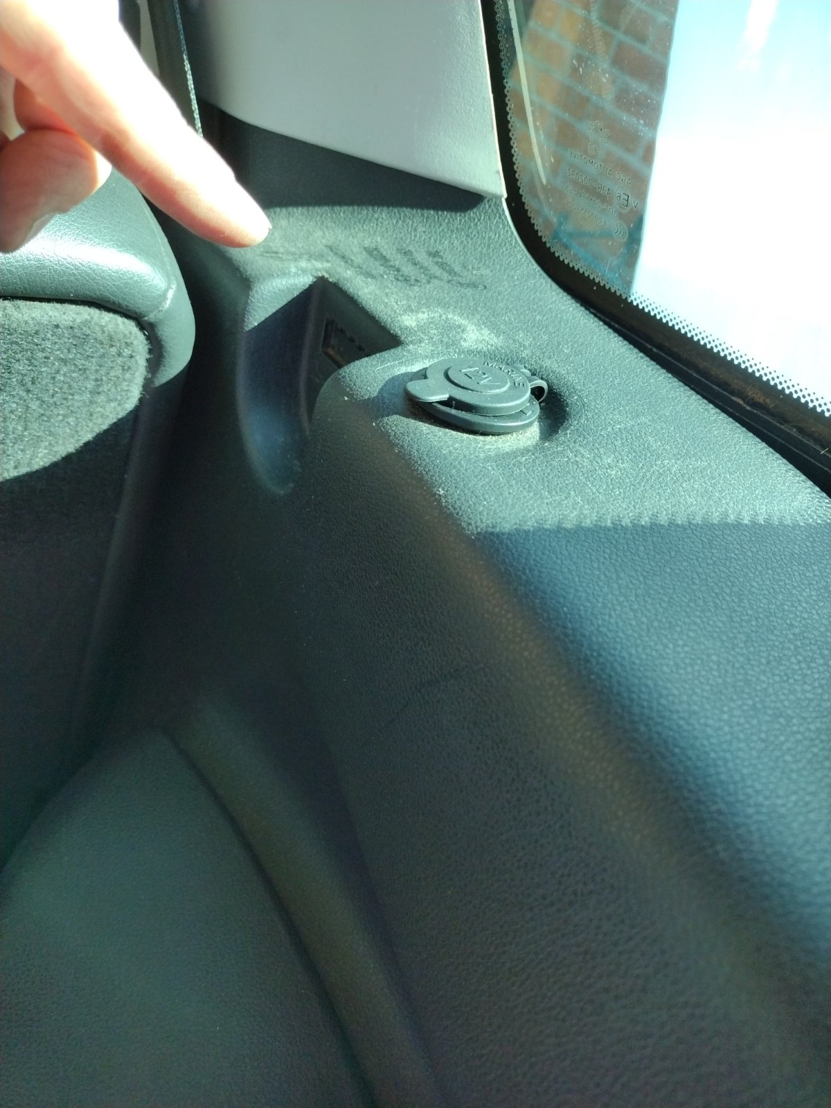

Sorry, for clarity 12v outlet, right rear quarter panel in boot

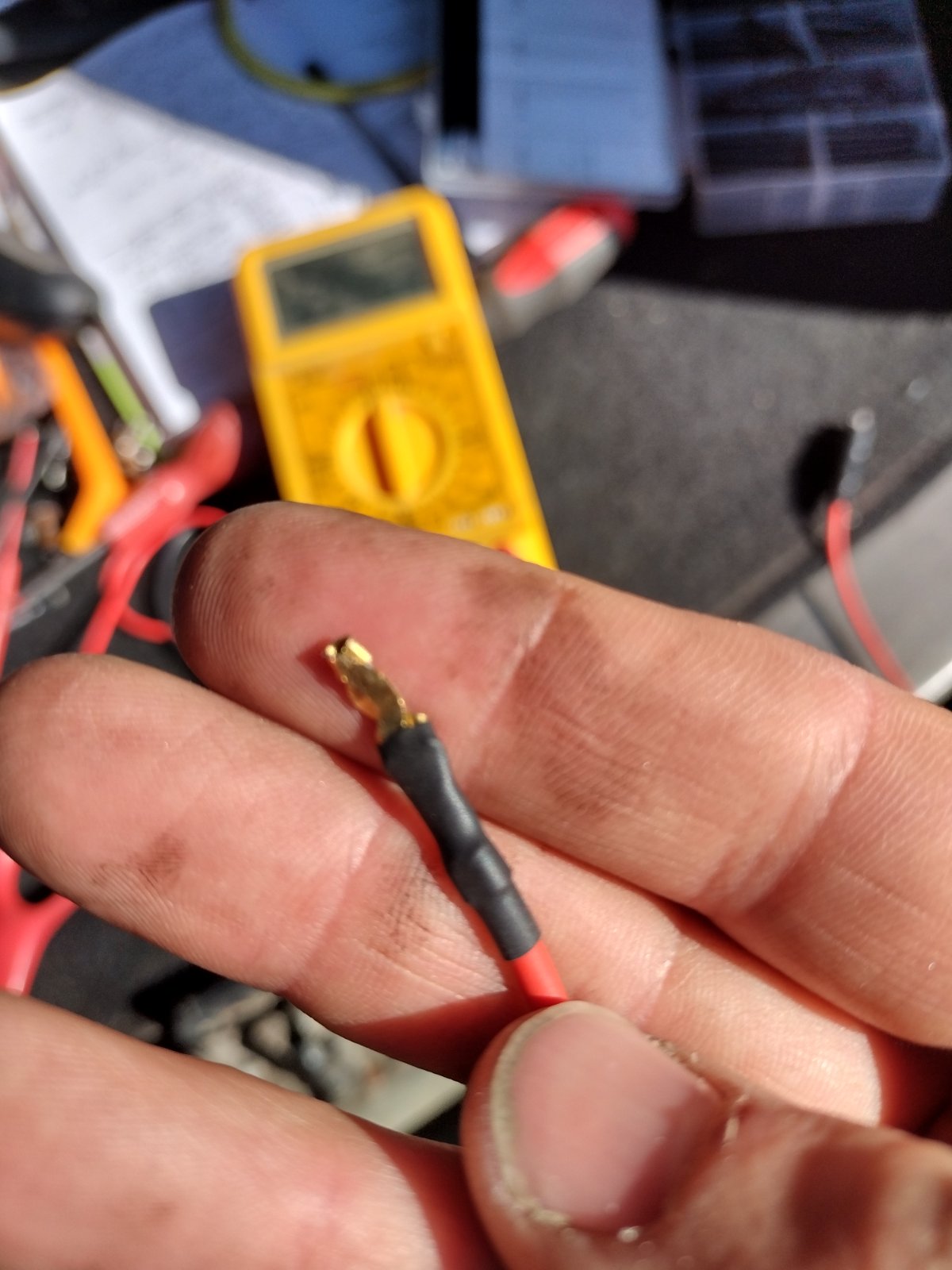

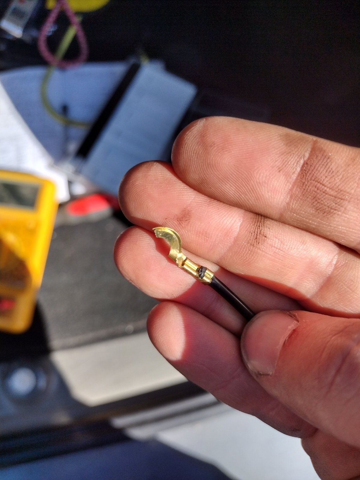

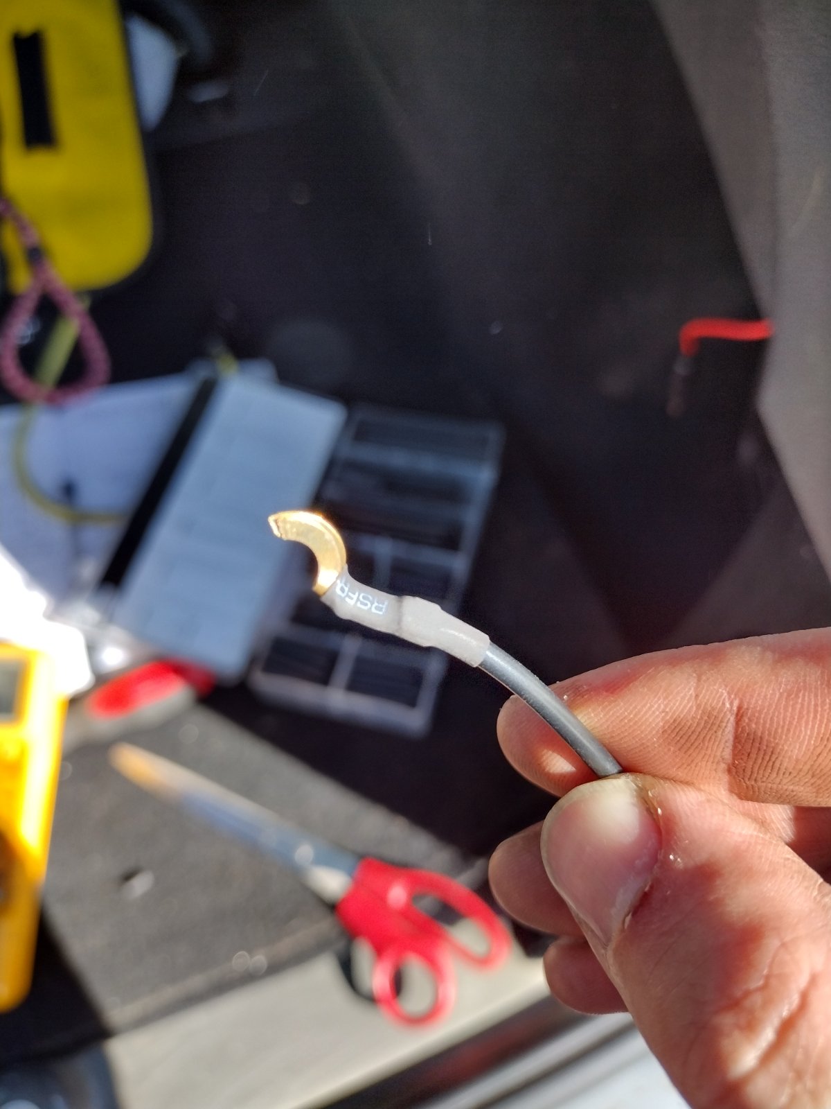

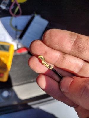

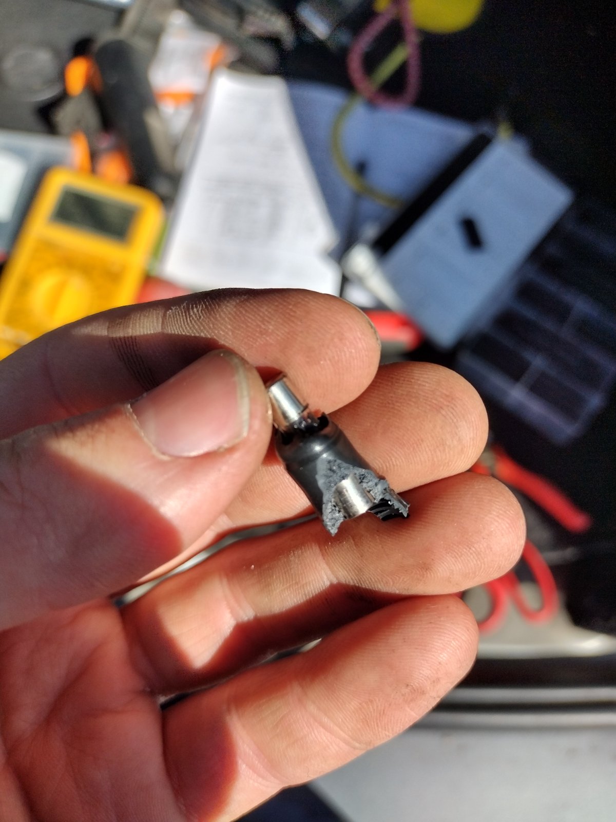

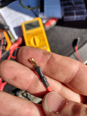

Fuse holder has been a bit molten at some point!
Bit of heat shrink at least getting rid of the bare "terminals" appear to be err, adapted ring terminals!

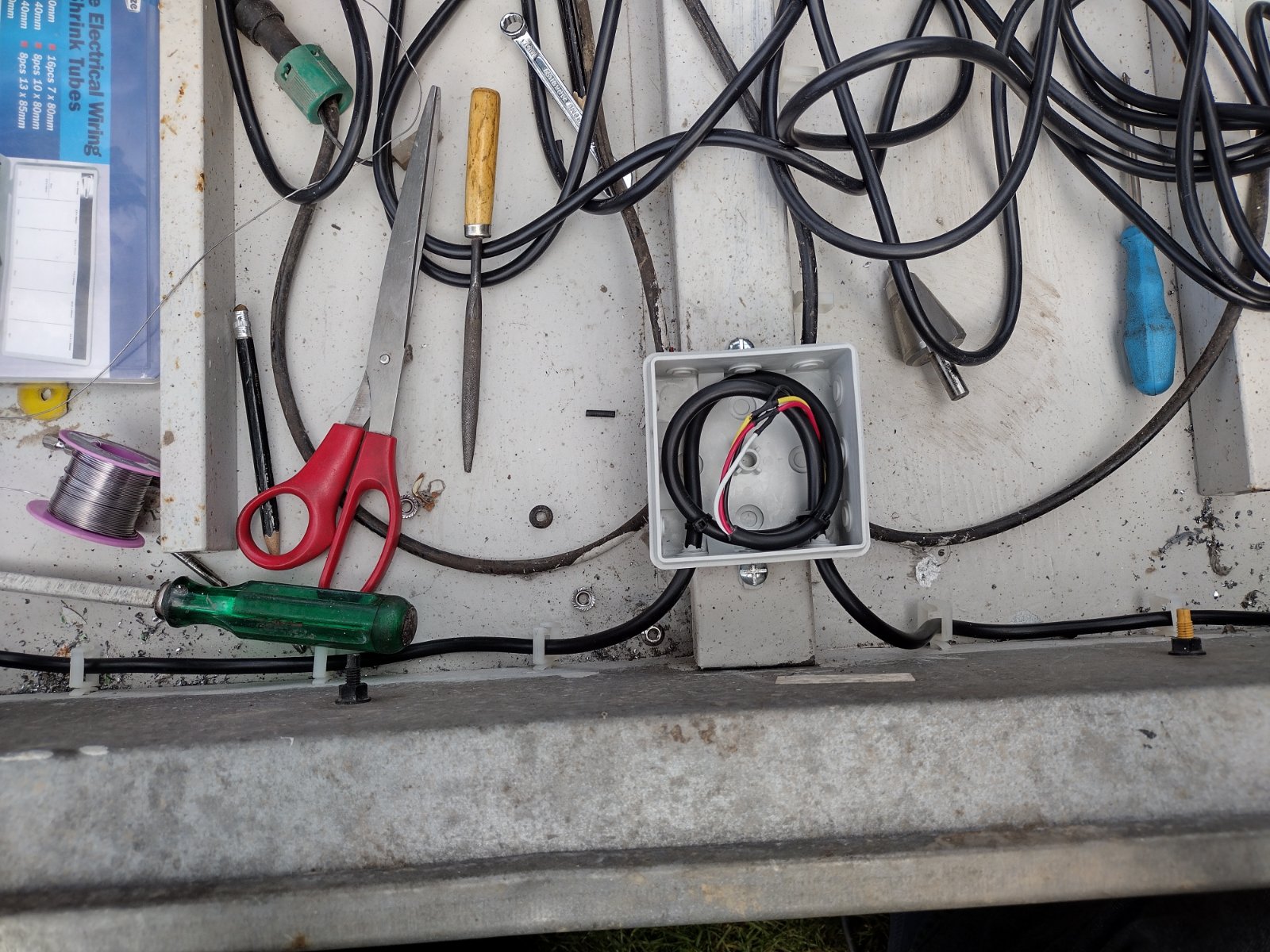

Towbar wiring got weirder and weirder!
All back together and...
... No tail lights.

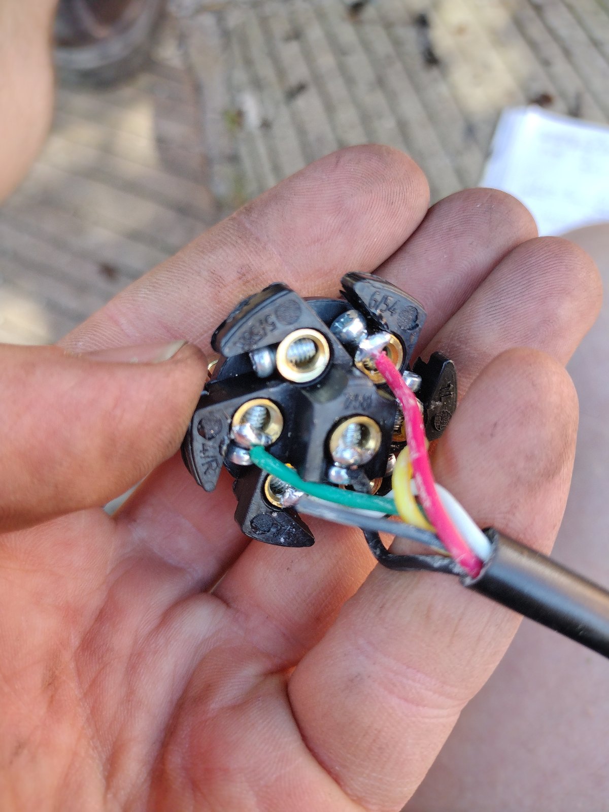

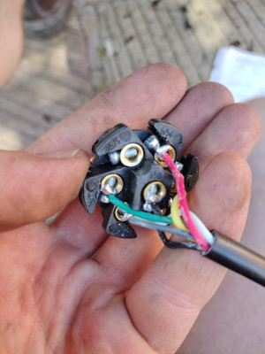

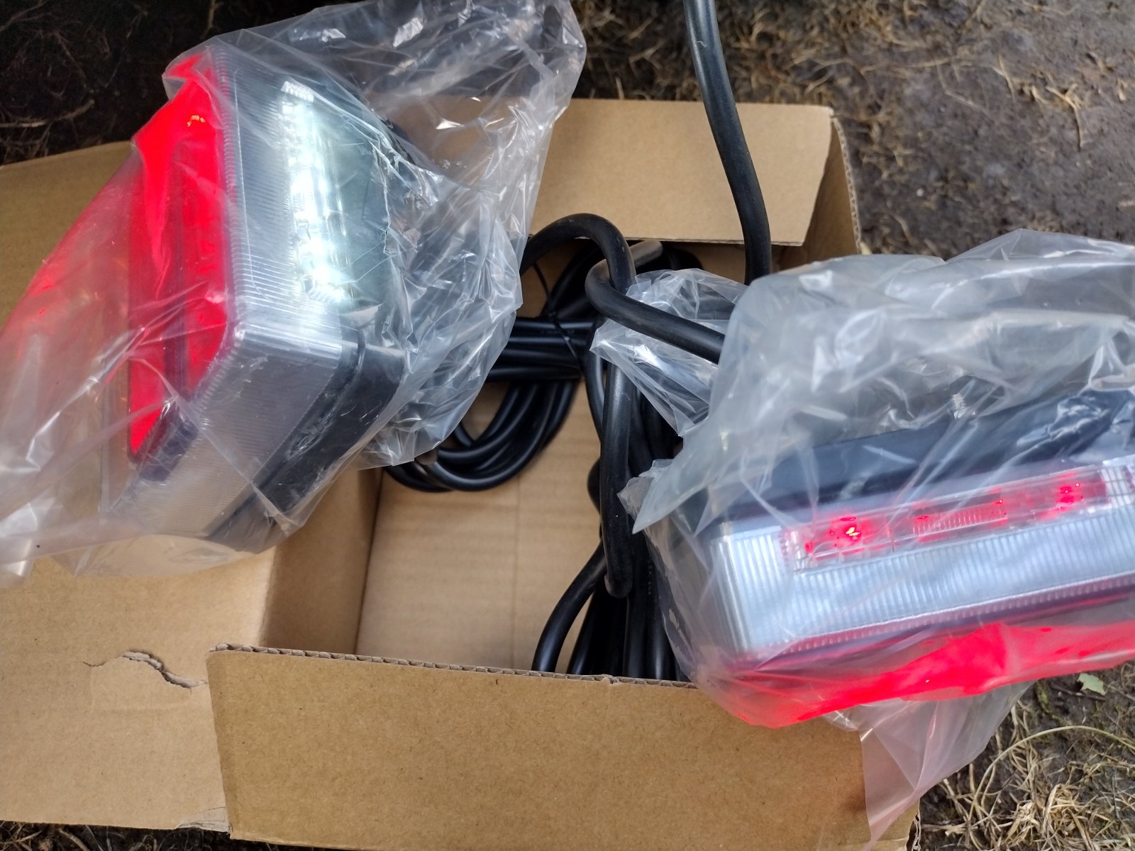

Investigated the new LED lights trailer plug Unsurprisingly, the Chinese have done it rather differently!!
Screw terminals= nah, just solder on directly!
Seven core cable = nah, there's no fog light, couple the tail lights together (both off the left feed) = make do with cheaper 5 core!
But all ok.

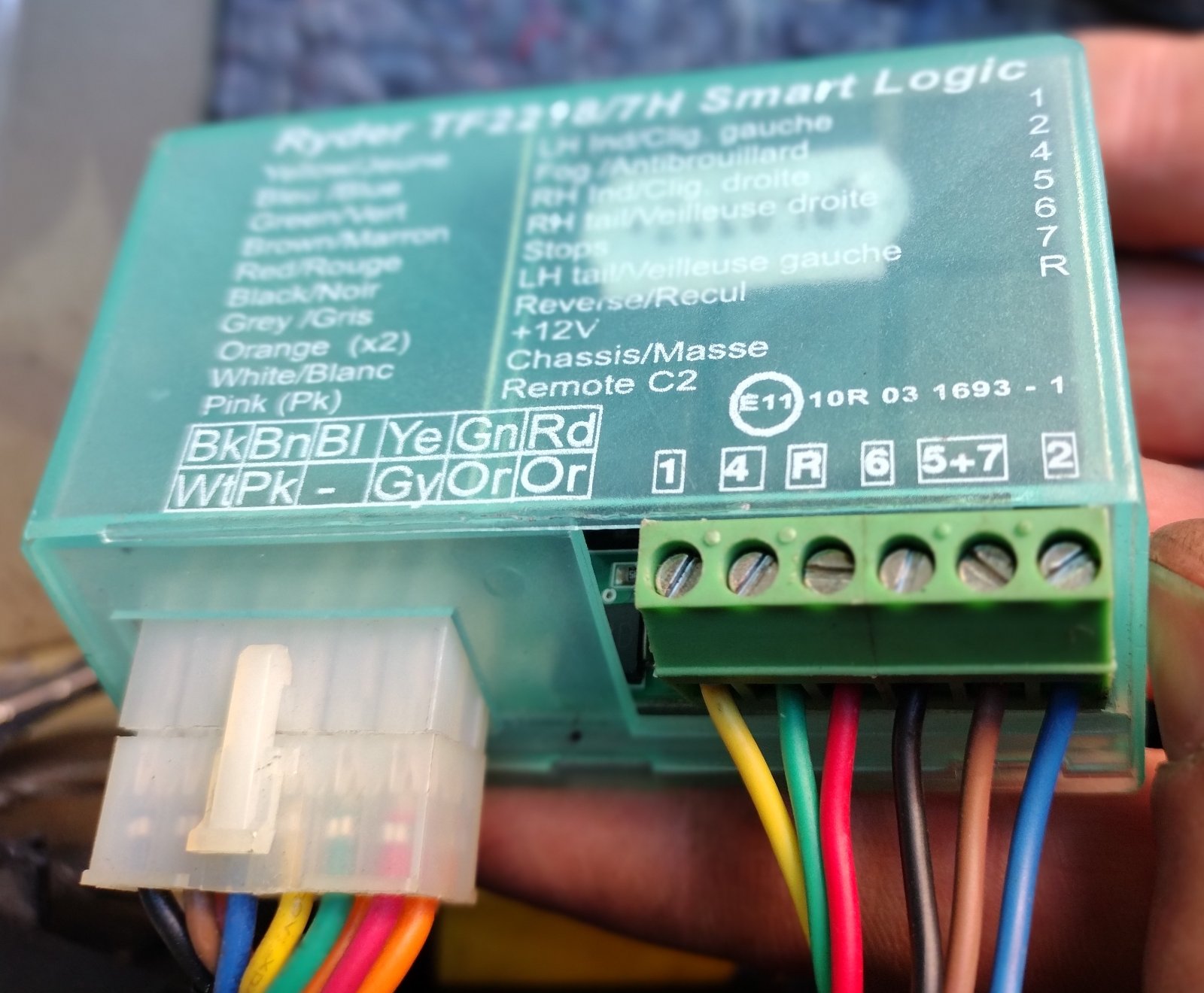

So, tested the output from car with the meter.
Left tail terminal never gets 12v. Right tail terminal does (but not utilised in the LED set)

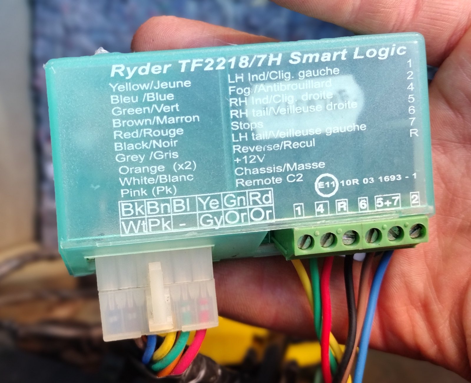

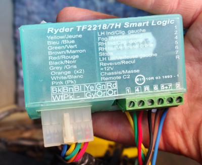

Retraced my steps and pulled off the neatly-ish glued into place trailer bypass relay.

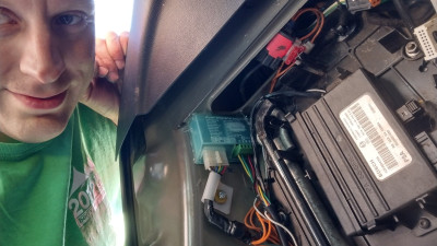

This is in its untouched state.
Standard wiring convention is:
1 Yellow = left indicator
2 blue = rear fog
3 white = earth (doesn't pass through relay, hence skipped)
4 Green = right indicator
5 brown = right tail
6 red = brake lights ( or "Stops" !
7 black = left tail
R = reversing lamps, other permanent feeds etc = all associated with "Twin electrics" when a second grey 7 pin plug runs the other functions. Caravans etc need these.
On this image you'll see both 5 and 7 are labelled up to feed from same terminal on the relay.
You'll also see the above is not how it was set up!
Red in "R", Black in "6", Brown on its own in "5+7"
Moved the cables to where they were supposed to be = all is well!

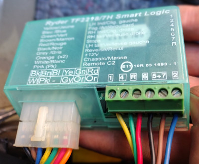

2 blue = rear fog
7 black = left tail

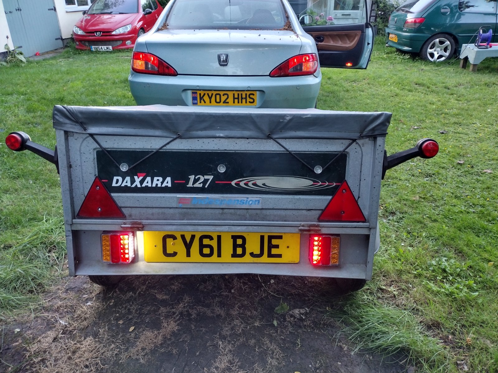

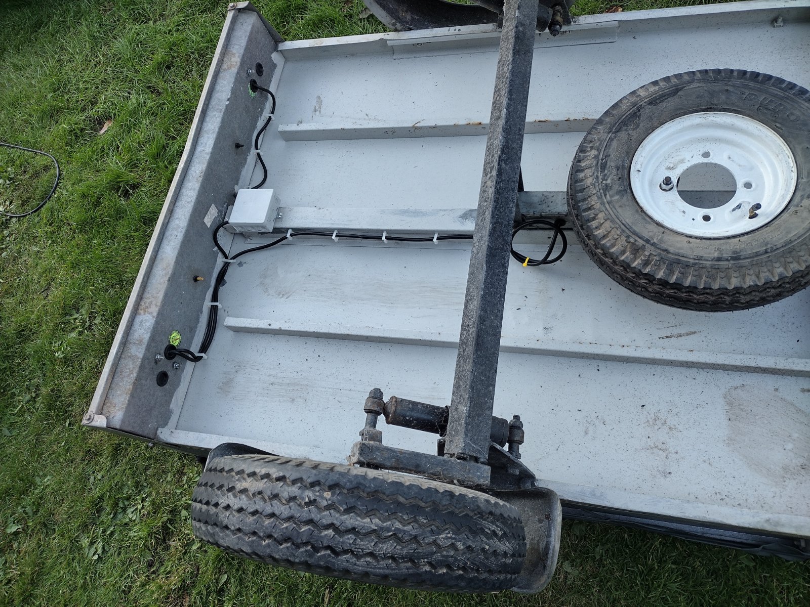

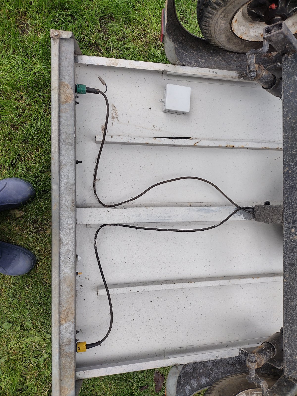

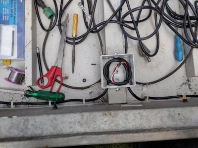

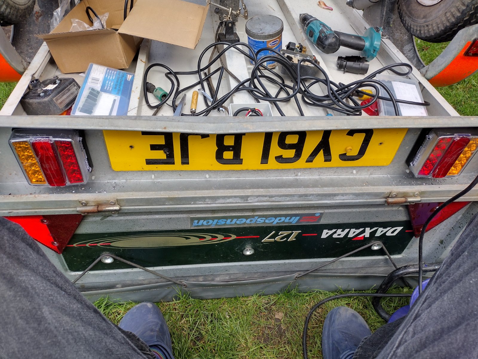

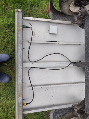

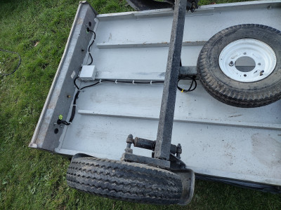

Trailer lighting job went ahead yesterday, now sporting the snazzy LEDs
And a few images of the progress and end result:

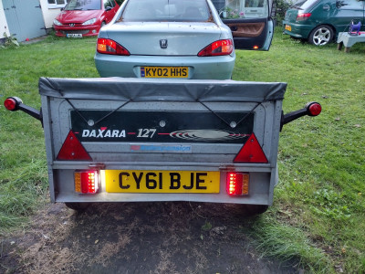

Ah, images hadn't uploaded,

Excellent! I like the outboard marker lights Matt!
- Posts: 5335
- Joined: 25 Apr 2022, 09:03
- x 2354
Yes, they are just reflectors at present (as not wired up) but I put them on as an aid to help reversing: the little trailer is a pain to reverse, particularly when had the C4 in that by the time you can see it in the side mirrors you are already too close to jack knife to do anything about it!
Ultimately I found jacking the seat higher than I normally have it gives me just a touch of visibility when reversing. Plus a load more practice towing since I had the C4.

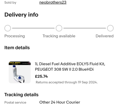

Information kindly provided by Marc,
As it's powerflex (same as the other 308) I've gone for the same stuff I used on the Grey one:GiveMeABreak wrote: 17 Aug 2024, 13:42 Hi Matt - oops, sorry about that, must have missed your post.
You have a reservoir tank, not a pouch system, and require Powerflex additive.
Top up 1 litre minimum, official capacity is 1.4L, but shows actual is 2.0l.
Item (16) here: part number is: 1610115580.
