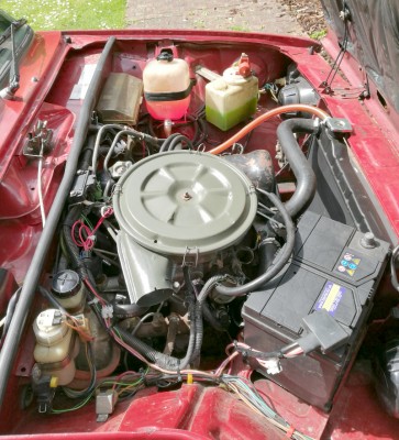

Bit of progress today.
[] Sorted out the battery feed wiring so it now reached properly. It's just got screw terminals for now - because my soldering iron is currently in hiding somewhere - but will be soldered and heatshrinked once I find it. Used a couple of bits of ex Lada wiring loom, so they are pink and brown leads which match the existing palette. Not that you'll see them once they're all loomed up anyway.
[] Attempted to do some sound and vibration damping around the fuel pump to cut down the horrendous racket it makes. It has definitely helped, but it's still noisy. The line is still rigidly fixed to the body in a few places though, so once rubber sleeves have been added there will see if that helps. May also throw some sound deadening in the void in the rear wing where the pump is as it may well be acting as a big resonance chamber.
May just end up getting a new, quieter pump at the end of the day... I'm using this one purely because it was one I happened to have laying around - and it's got 112K miles of wear on.
[] Poked the non-working check engine light. If I'm interpreting the diagrams right, it should provide a ground path for the light (much the same as the oil pressure light in most cars). Basically, it isn't. Not a wiring fault either, as I've probed the pin on the ECU connector - will double check from the pin on the board just in case it's a faulty connector too. My guess though is that the transistor associated with that function though has either died or been killed. It's not a hugely complex board (only double sided) so should be pretty easy to trace out the signal path - and cross my fingers that I find a transistor rather than it vanishing into one of several proprietary Delphi branded ICs.
Will see whether I can track down a second ECU - both to test my theory, and because let's face it, having a spare isn't a bad idea anyway. ... especially when I inevitably start fiddling with the firmware!
Not with a view to fiddle with it, but one of my next tasks will be to make up an interface cable to connect to the ALDL bus (just pre dates ODB2 sadly!), as someone has written software which allows quite extensive monitoring (and I believe logging) of real-time data, which to me just seems like a really useful feature to make use of.
Likewise the CEL, it not working isn't really an issue until next MOT, but given this thing does so much in the way of self diagnosis, it seems stupid not to take advantage of that ability - especially when that can save you from damaging the cat or even the engine.
The CEL itself is currently wedged in the ashtray. Having said that, the wiring loom is cable tied to the dash and passenger seat base just now, and the fuel pump supply is just running under the front seat and over the rear one. ...suffice to say "tidy up the in-car wiring" is high on the list just now!
One other thing I've not 100% decided on is whether to stick the intake horn and warm air intake back on. It's essentially unnecessary given there's no carb to ice up (bearing in mind there are several hundred watts of heater built into the inlet as well). It will be carried and definitely added for shows. Day to day though I'm not sure if the larger inlet diameter is actually more useful...really should test if it makes any odds.
Plus it currently produces some highly entertaining noises - the sort of hard edged bark on a blip of the throttle that you normally would associate with something running a rather tasty big Webber or similar carb...the novelty might wear off eventually...maybe!

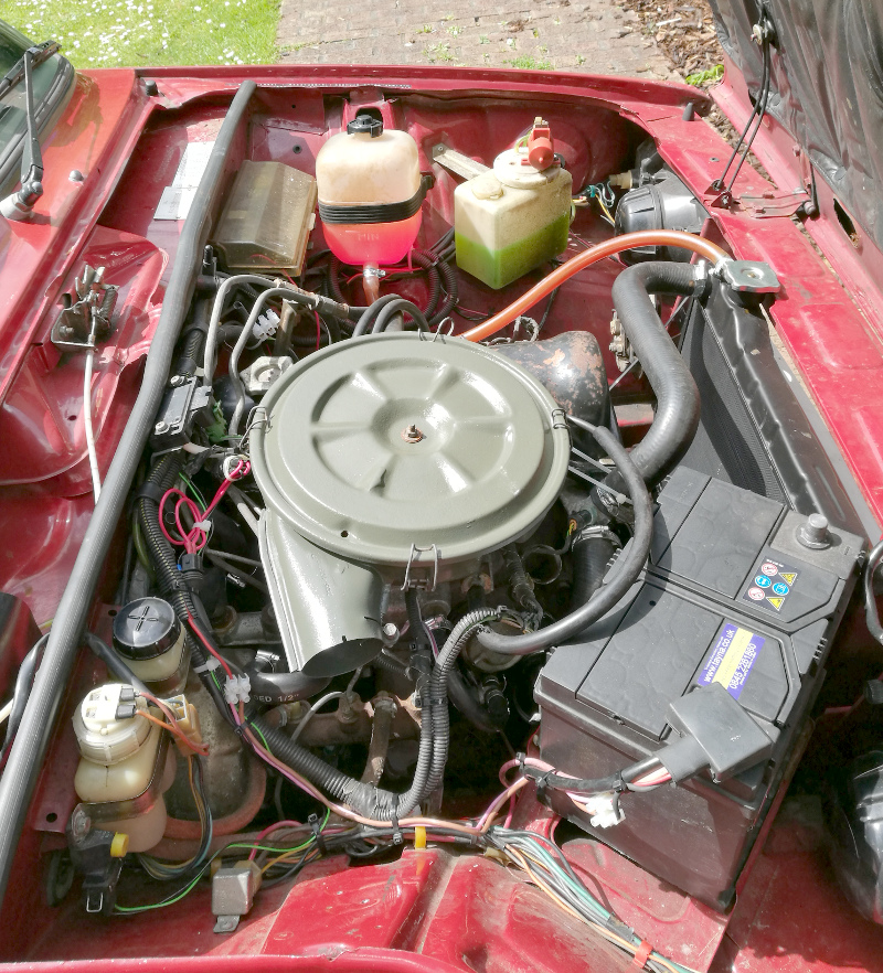

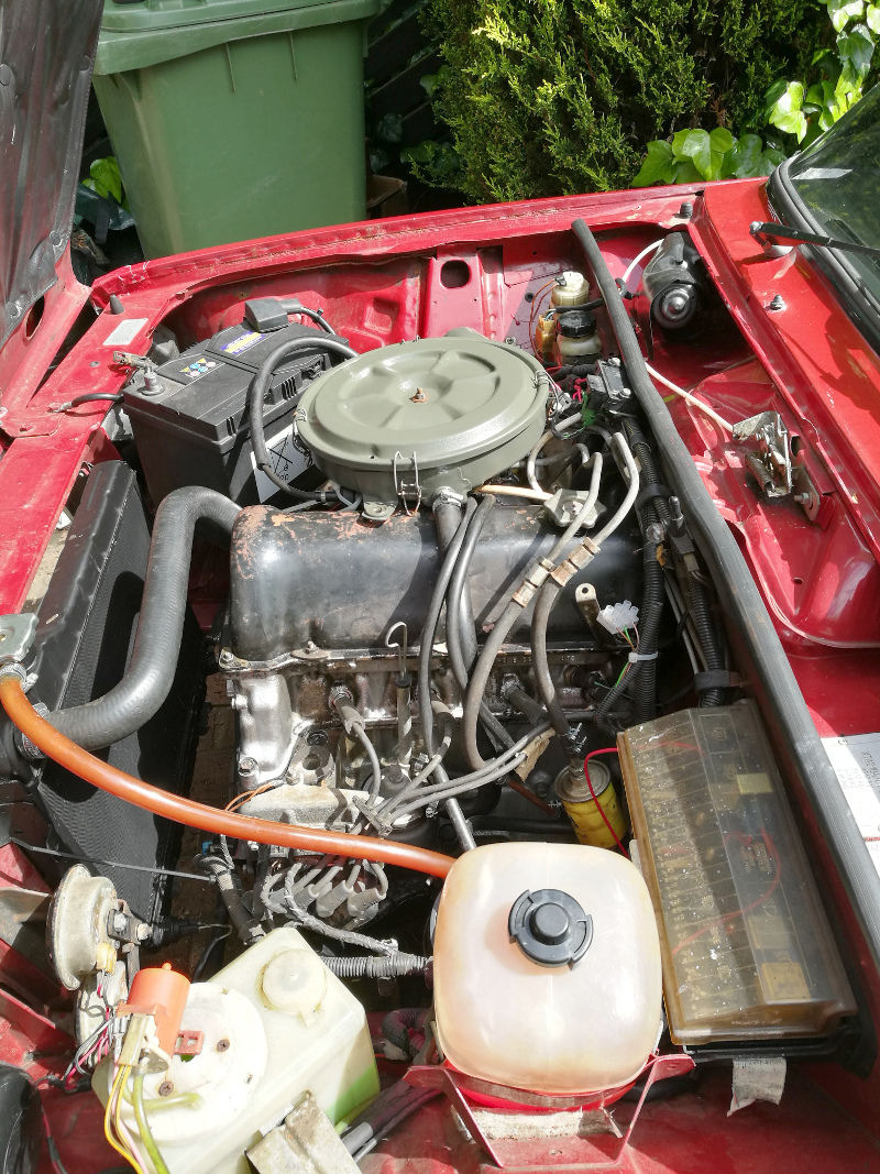

Nothing major here, just a couple of photos to show where we are just now.

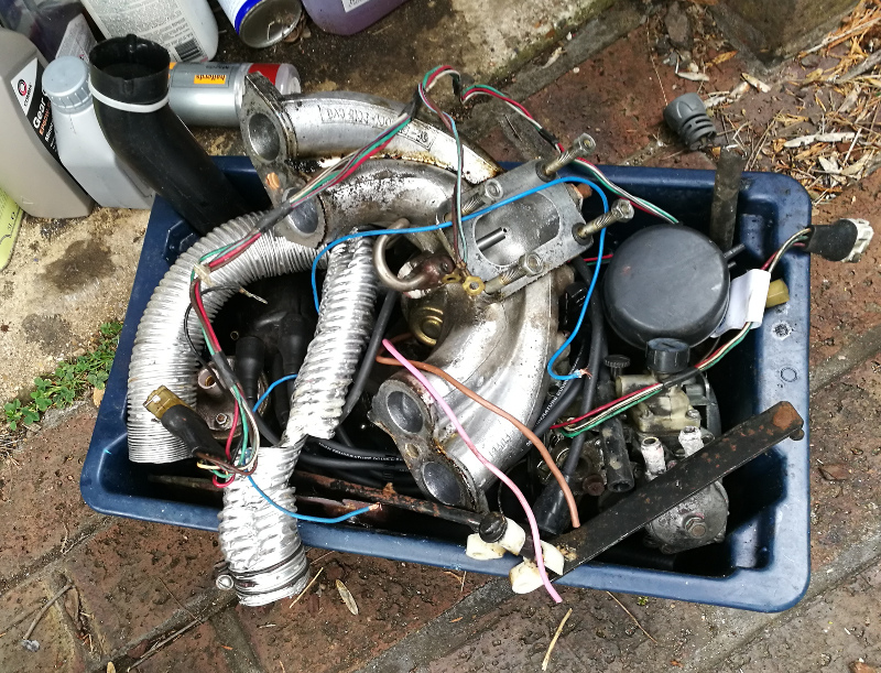

Here's the box of "leftovers" that have been taken off the car.
This is the current state of play in the engine bay.
Note that the bundle of red wires by the bulkhead are the "adaptor" to connect the Lambda sensor, and will be banished once the correct sensor is fitted which will instead plug in neatly. Likewise the screw terminal blocks will all disappear in the near future. The ones in the power supply line from the battery are simply because I didn't have my soldering iron handy to solder and heatshrink those connections, and the ones near the fuse box are being a placeholder for the vehicle speed sensor.
Speaking of temporary things - the cable tie connecting to the top radiator hose is also temporary - that's bracing the "bracket" currently terminating the throttle cable...
Yes, still a few things to do, but it's starting to look like an engine bay again!

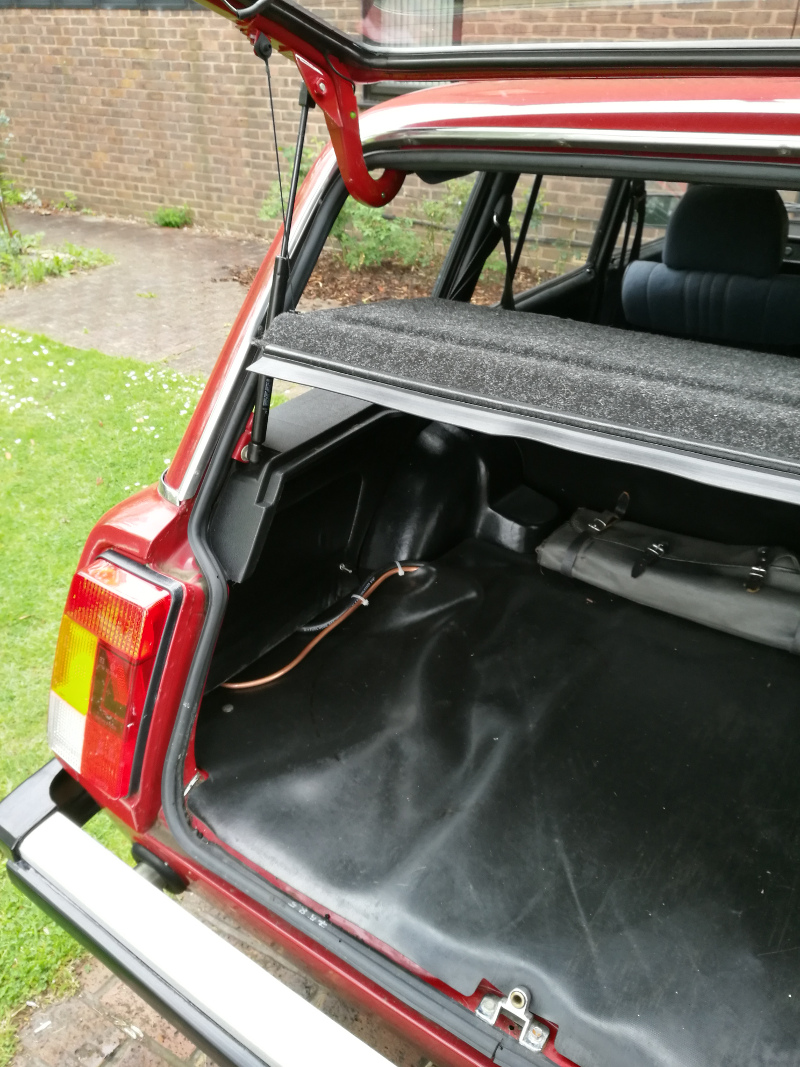

In the boot it's not hard to see where the fuel pump lives...The rubber line is the suction feed from the original tank pickup, and the copper line is the HP feed that runs down under the car to the engine bay. Currently these are just going through the access panel in the boot floor, but I'll drill holes through into that void from under the car in due course (there are already a couple as that's where the fuel tank vapour separator and vent hardware lives). That way I won't be left with anything visible inside the car, but the pump will still be both easily accessible to servicing, but still inside the car so protected from the elements.

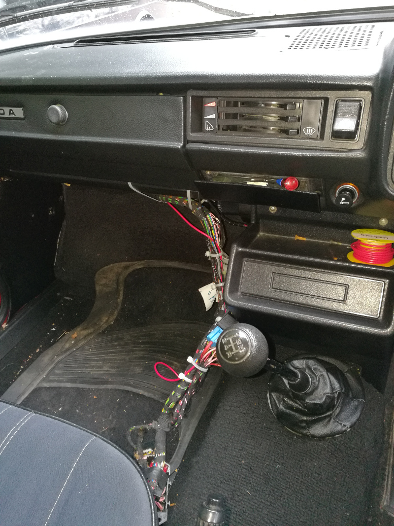

Finally for now, we have the interior...where I'm currently rocking the "rally car exposed wiring look" until I get around to tidying it up.
I can actually sort this lot out now that I know it works! Made sense to make sure it worked *before* faffing around routing things under the carpets and such. Need to get the nearside carpet out anyway as I need to remove the existing ECU for the old carb system...it's just taking up weight now! I *will* keep hold of it though in case for any reason I do reverse this mod at any time (can't see that happening given the *massive* improve in driveability!), as the AFR modules are pretty hard to get hold of these days - especially given their tendency to fail if you so much as look at them wrong.
