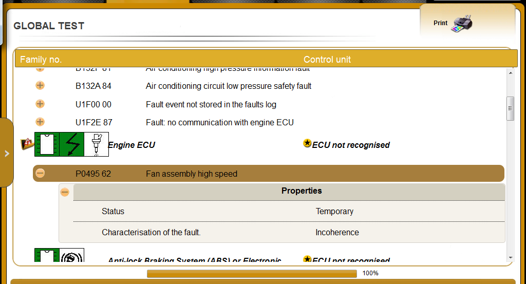

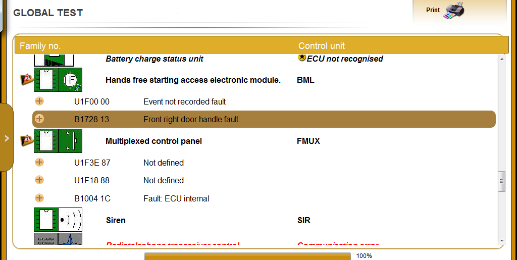

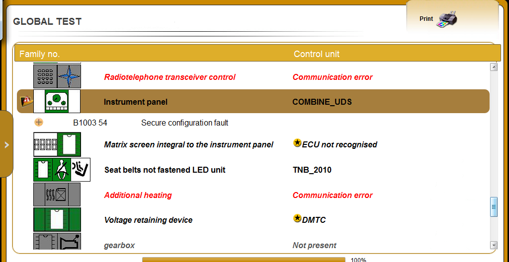

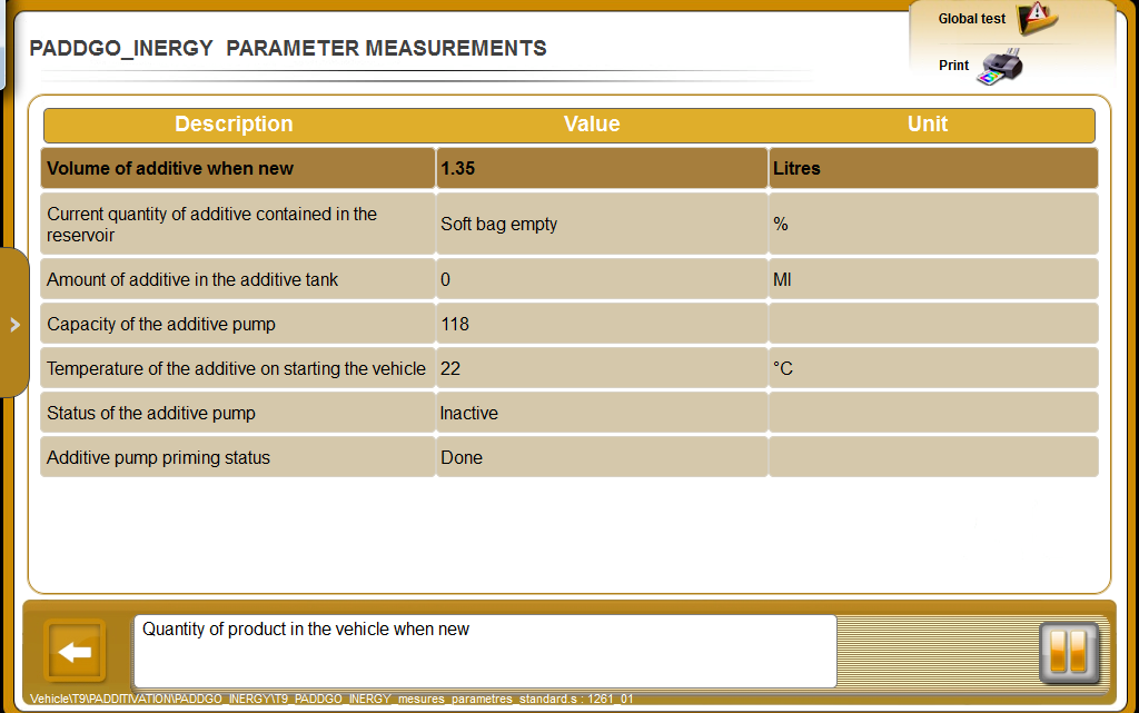

So, a nice long run in the Blue 308 this morning

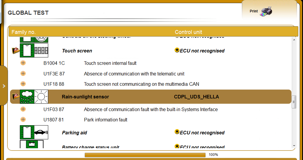

Then this afternoon, had chance for an initial code reading session. I've never plugged it in during my time with it, no warning messages on dashboard, so all clear then, yes?
Nope! Loads of codes. Sat nav / GPS related to be expected but loads of others! Eolys fluid surprisingly empty (surprised no warnings to that effect

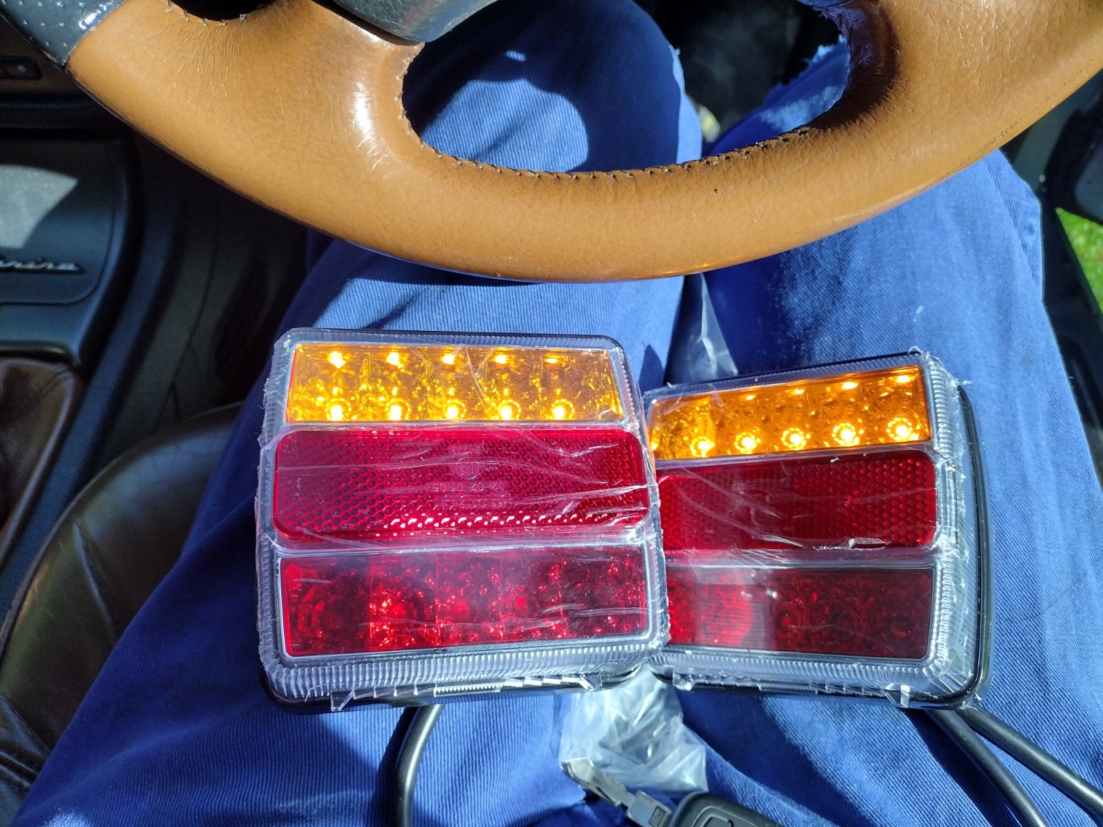

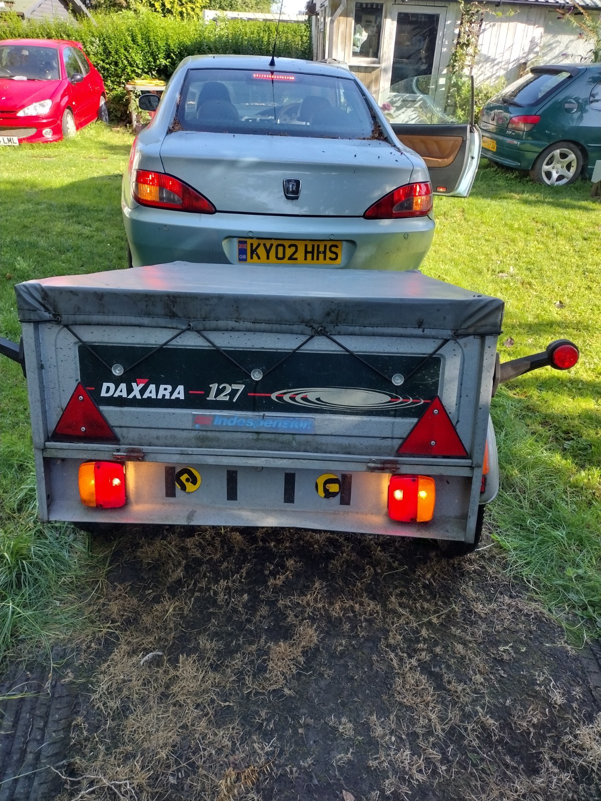

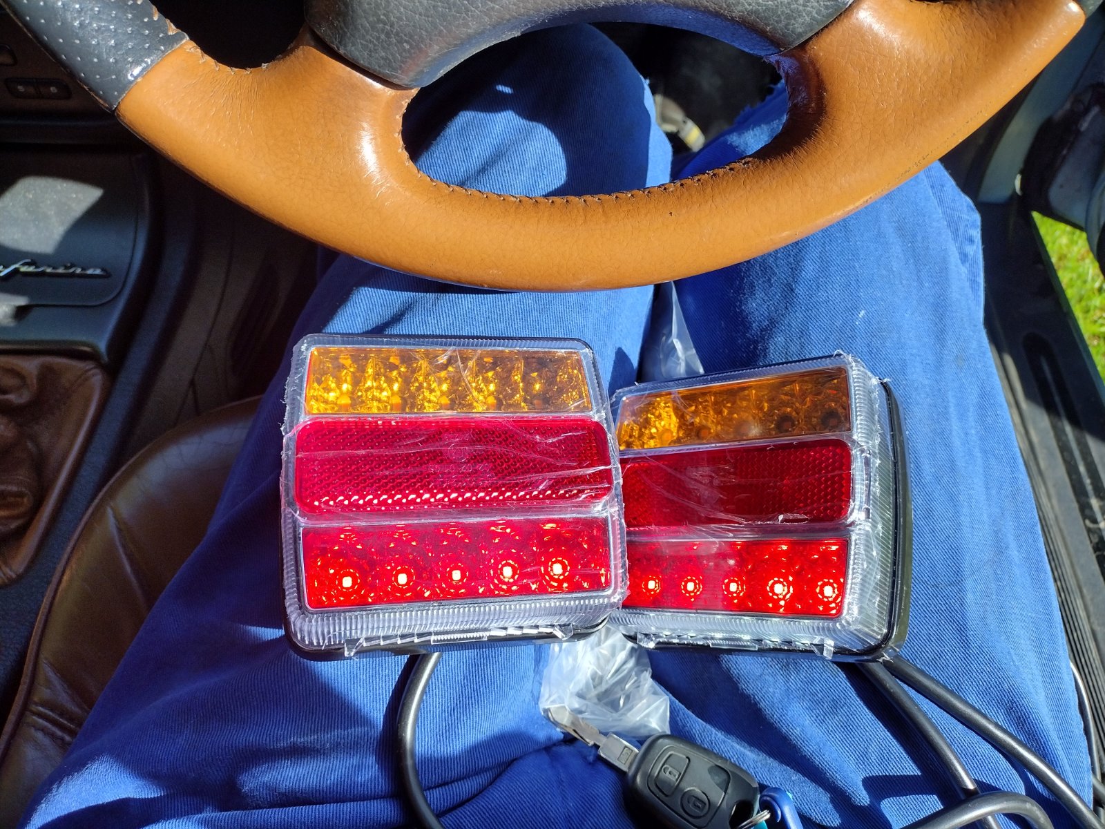

New trailer lights around this morning plug them in and oh dear! Answer: Trailer wiring is okay it's the flipping 308 wiring that is the fault!

Confirmed by test with coupe trailer socket

Used 308 to tow the big trailer recently and was working fine so I didn't bother checking that!
Also there's a design flaw with these pre-wired lights in that the two tail lights a couple together by a piece of wire and are intended to mount flush. which would need the wiring to pass through whatever it's fastened to....
... Which obviously needs a lamp cluster-sized hole in it for that to happen!?!

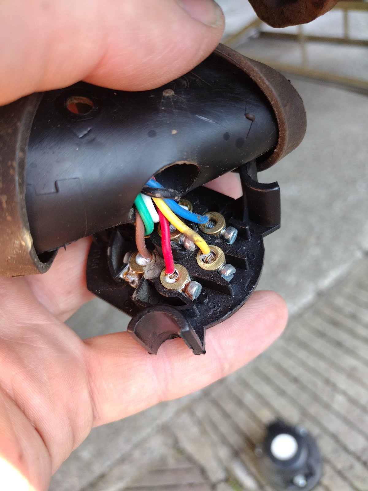

Quality trailer wiring...
What's a grommet?
What's tidying up?
What's tidying up?

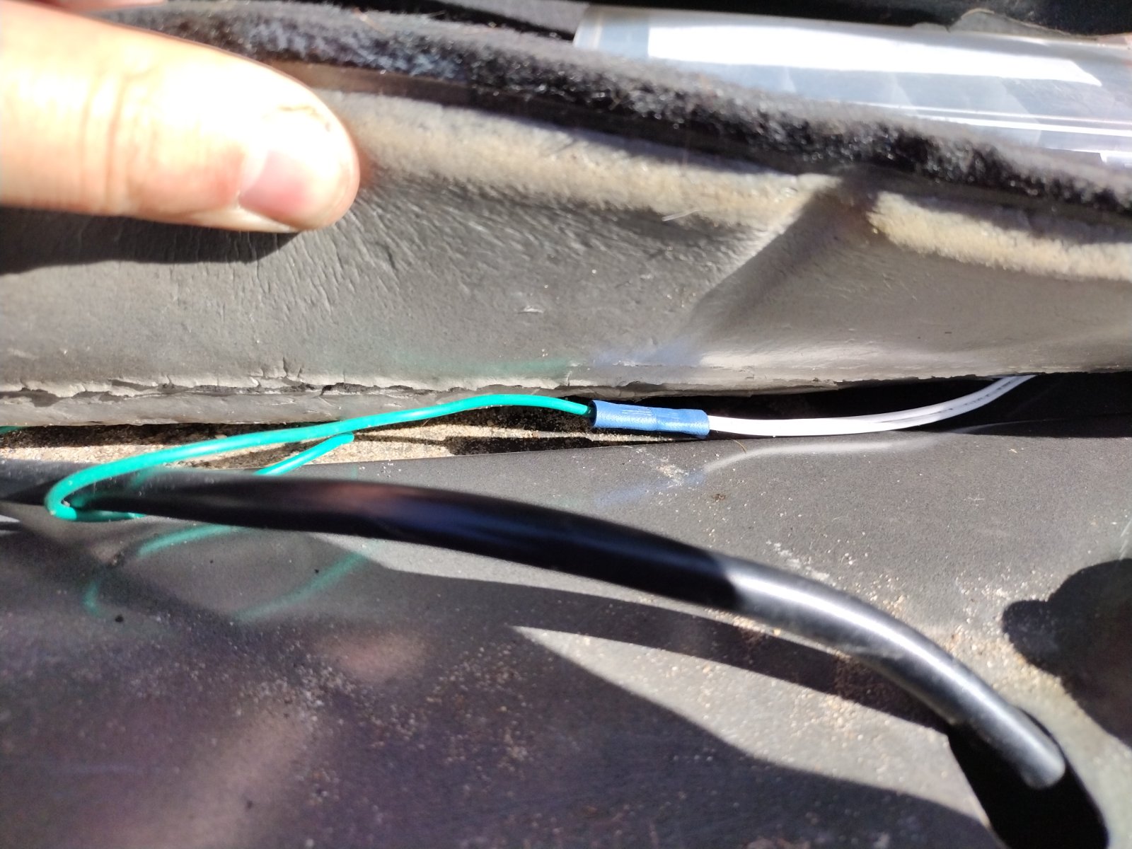

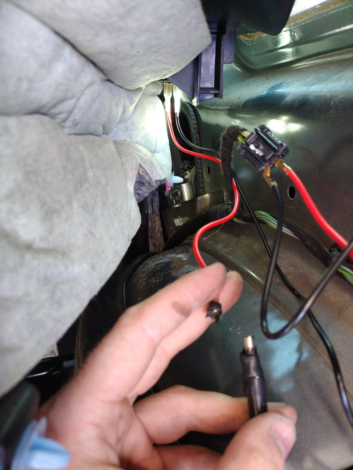

More quality wiring, this is how the trailer relay thing gets all its power I believe.
Eenie meeny miny mo pick a random connector insert a spade terminal and off we go!

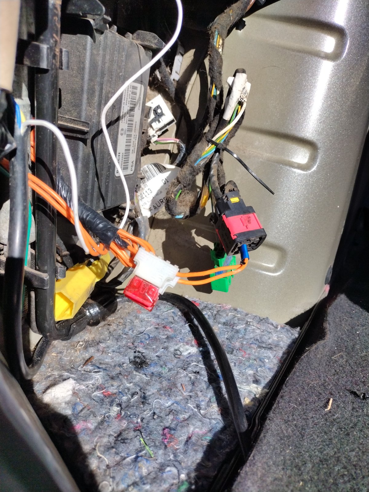

Removed the duct tape and sticky electrical tape at this point so you aren't seeing the full beauty of what was the completed job!

Presume we've never used this rear socket. Equally the two bare connectors pushed into the original connector also haven't managed to short out on the body work so that's good news!!
