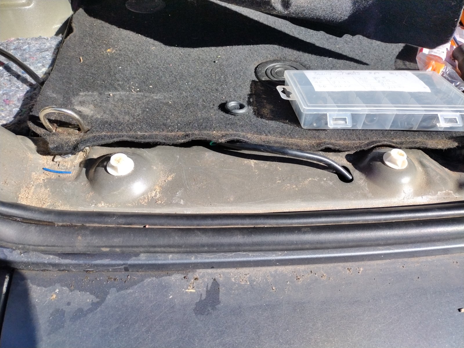

More quality wiring, this is how the trailer relay thing gets all its power I believe.
Eenie meeny miny mo pick a random connector insert a spade terminal and off we go!
Posts: 5344
Joined: 25 Apr 2022, 09:03
x 2358
Unread post by MattBLancs »
Removed the duct tape and sticky electrical tape at this point so you aren't seeing the full beauty of what was the completed job!
Posts: 5344
x 2358
Presume we've never used this rear socket. Equally the two bare connectors pushed into the original connector also haven't managed to short out on the body work so that's good news!!
