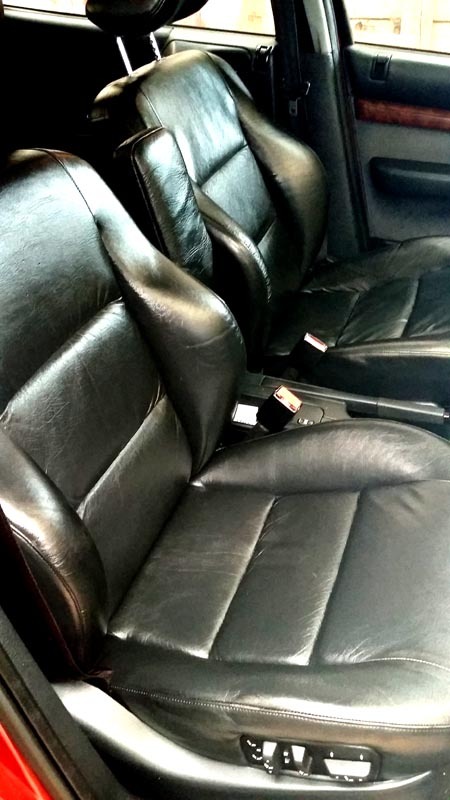

New Leather Care liquid applied.....not bad for 21 year old bum pads :)
