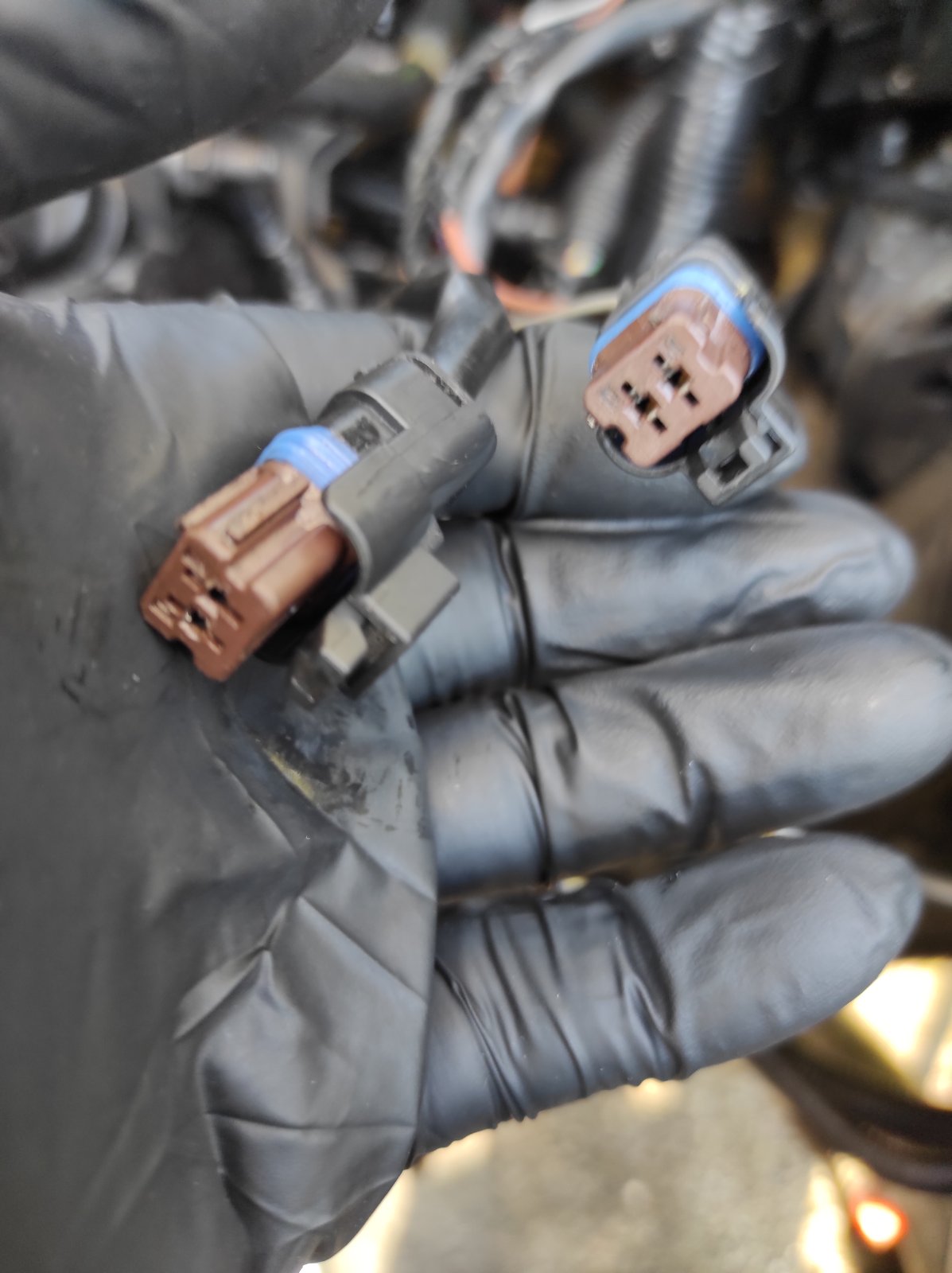

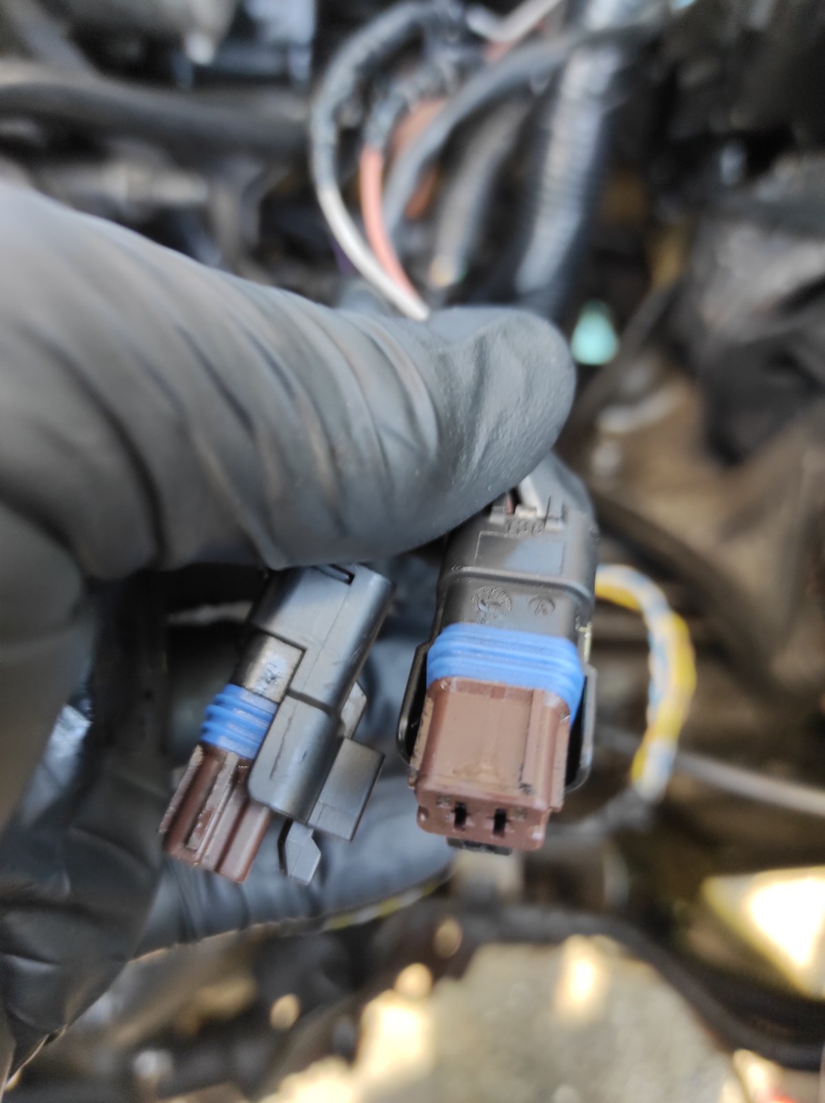

These are the two connectors I spoke about earlier. As you can see identical the only difference being wire colours.
Darren

Darren,
So easy to mix up, when you have removed a loom. But the important thing you realised what you had done and fixed it.
Kenny

Yes it's just incase someone else has a similar issue
Darren

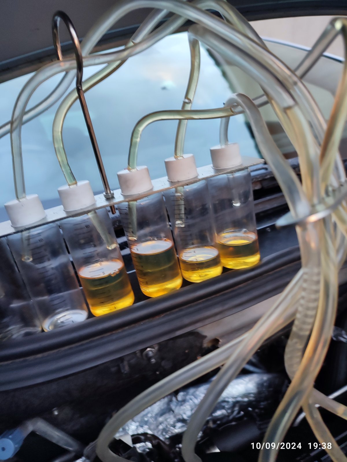

darbuck wrote: 01 Sep 2023, 19:08 I don't think any of these injectors are any good any opinions the fastest filling is injector 3 again Even though it's replacement but it is used so Not much use I think.
I am able to actuate all injectors so it's mechanical rather than electronic.
Did you get the car sorted after your scoping last week.
This looked good! What changed? Is it worth now? If not, then it cannot be the injectors.

I'll have to do another test I guess
Darren

darbuck wrote: 10 Sep 2024, 06:20 I'll have to do another test I guess
It would definitely make sense to do so.

I will try and do one this evening weather permitting

Hi Roger I done a leak off test see the results. I think we can safely say I have 2 bad injectors and one that's just about in spec I will try testing other injectors I have but I think I am going to need a couple of refurbished units.
Darren

Darren,
Do you still have the original set of injectors and spare set or did you just get a single one ?
Kenny

I have original injectors and a a few I bought but I'm not sure if any of them are any good
