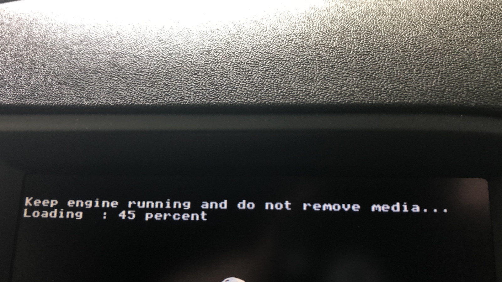

Re: How to Replace the Internal MicroSD Card - RT6
Hi Guys,
first i would like to thank the guys that put a lot of effort in the forum to help other people. A very good job, that can save you a lot of money.
My RT6 stopped working all of a sudden. The display stayed black and a recurring noise was heard from the CD player. The guy at the garage said they saw these problems before, and most of the time it costs hundreds of euro's to fix these.
I don't like spending a lot of money for things that are "old", but a non working radio in a car is not an option. So i googled for the problems i had and came to this forum.
Thanks to the perfect manual from here to get the radio out and the SD card i was ready to update the RT6. First i tried a DVD with firmware i downloaded from the internet. But that was not quite succesfull.
Than i ordered an original CD from the shop. I noticed that it was different from using the DVD ans after some time, the display came back to life.
After more then 30 minutes it was ready, i thought. I can't remember what lanquage it had when it finished the first time, but i must have did something wrong. I remember the text on the CD that said to wait untill the radio restarted. I did, but then the firmware started to install again. After it was finished the second time i was more cautious and got the cd out before i ended with the same issue. Stranmge enough, i got a Citroen logo the first time after installing, and a Peugeot logo the second time.
The radio sytarted again and the display showed some life again. But the language was in Chech and not Dutch(or English). I tried to look for an option to get it in a different language, but i could(and can not) find the option. It seems to be missing from the menu.
While i am fine with the state it is in n oiw, it would be fine to get the language back to Dutch/English. Does someone know how to get this done?
It's the configuration issue.
The latest firmware can overwrite the vehicle Head Unit configuration, and this generally requires the dealer to re-configure from their servers as the ECU goes into secure mode.
Just tell them you need your RT6 reconfigured according to your vehicle options, as the unit has been repaired. They should only charge you a diagnostic fee to do this as the system is mostly automatically configured via internet - they just then check it is all OK.

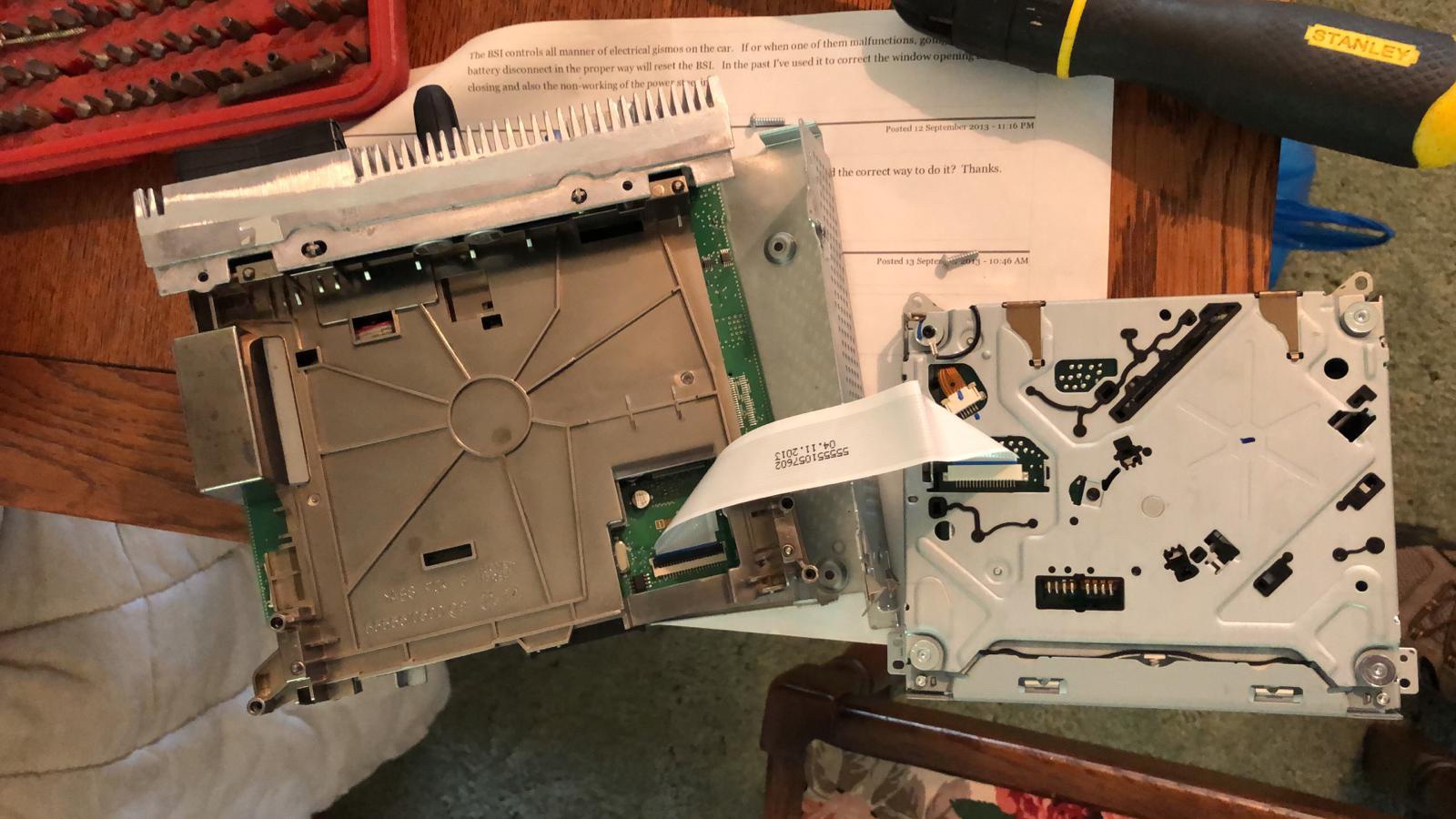

Many thanks for all the information posted here. I was able to use it to recover the unit installed in my late father's C5 which I have given to my brother in-law. opening it up and replacing the SD Card was easy for me, but I have a lot of experience repairing computers:
I was hoping the existing SD Card had just locked up/become write only and I would be able to clone it to a new functional card using Easus Partition Master, following the guide here: https://www.forum-peugeot.com/Forum/thr ... 6-go.9722/(though my french isn't good enough so I used google's translate service link to provide the page in english:https://translate.google.com/translate? ... ch&pto=aue)
I did a dry run of the cloning process using the card from my raspberry pi running linux and this worked well, so I had high hopes. Sadly the card was not recoverable back to a readable state, but I managed to get the Firmware disc from a local dealer.
This worked well, though the install took around 50 minutes: I also made the mistake of installing it a second time as the prompt to install came up on the screen and the screen now splashes the Peugeot logo rather than the Citroen one
Just need to sort out the maps now. But many thanks again.
