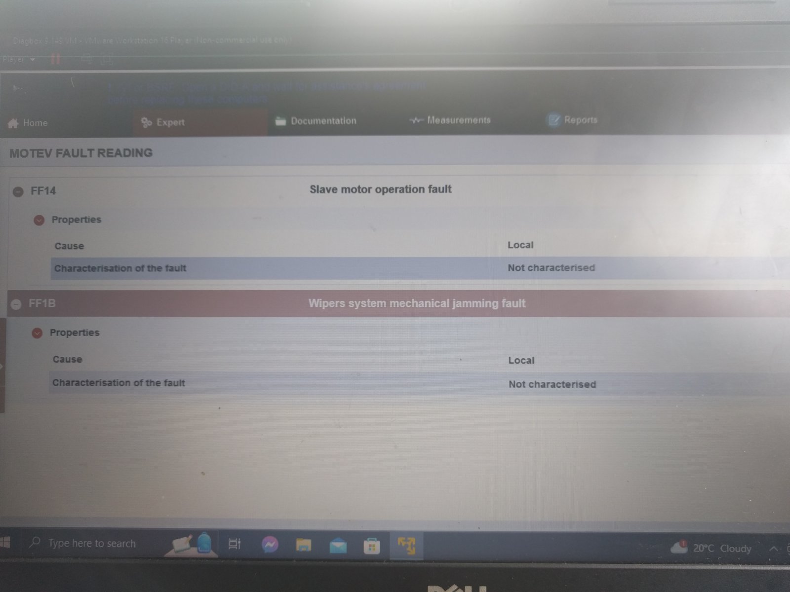

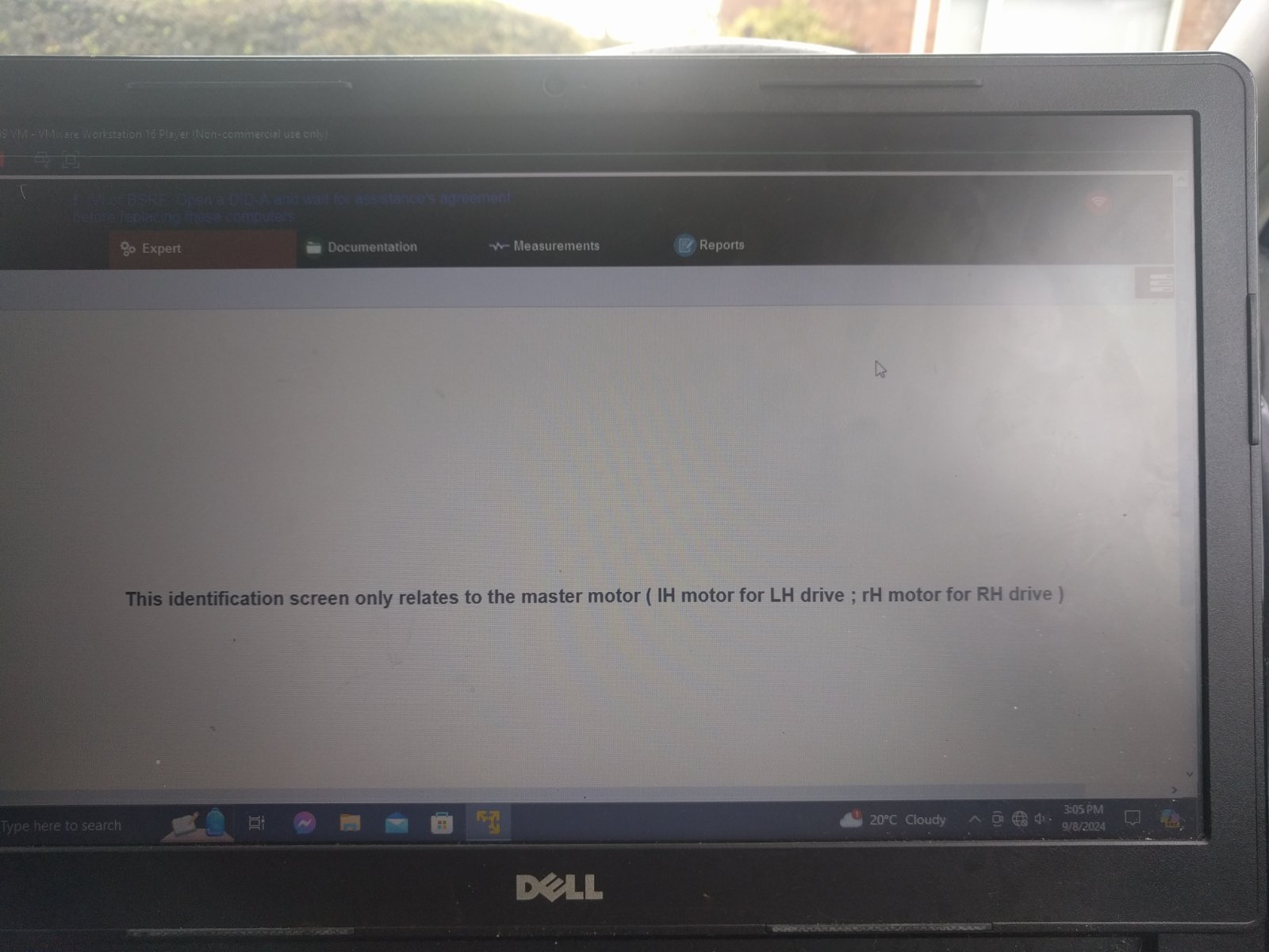

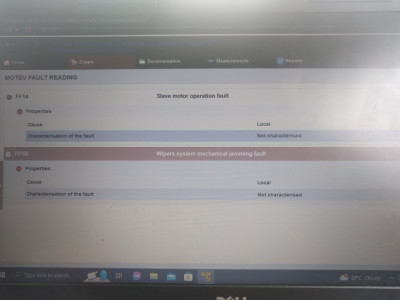

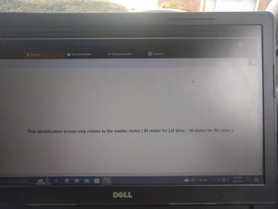

Re: Citroen C5 X7 Windscreen Wipers
Hi I have problem with wipers on some day passenger side start doing weird things and I notice that happened when at some speed I turn left then wiper start jumping stopping and at the end both jammed or wiping without synchronisation .
VIN VF7**************[VIN obfuscated, can be read by forum staff]
I made digabox check and I get that reading
FF14 slave motor operation fault
FF1B wipers system mechanical jamming fault
on photos what I attached to post you can see that
So with one I should to check before I spend money for replacing the motors. Any chance to help?
Edit:
Fee hours later job done I take off passenger side part where all metal things was looking good I take opposite side off and I noticed that magnet was on wrong place so 2 drops of super glue and baking soda make miracle and motor back to life I save£ 200 if not more . Thank you .
Edit:
- x 6945
Many members have managed to save the expense of replacing these, so well done on a repair. A good clean up and should be good for years. Just make sure you seal the units up well to avoid any water getting in as this is the killer.
