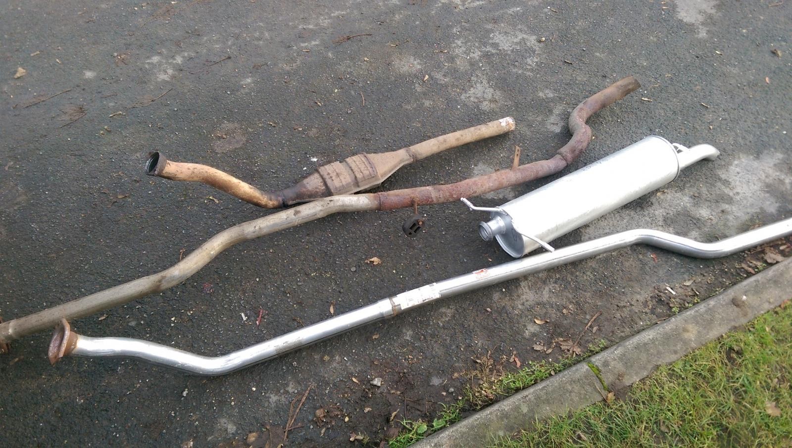

Well, in the end it turned up at 08.50 friday morning! I was having a coffee and a rolly after a not too heavy night at a supplier dinner when my mate/colleague messaged me, so I popped to work and grabbed the backbox, then went home!
Full of trepidation of it not fitting, I got started. Had a bit of an issue with one of the fixing bolts, the washer spring cup had jammed on the bolt, which is why it was loose and wouldn't tighten up. I tried wiggling it the 1/2 inch of room there was, but in the end a big screwdriver up the other end levered it free and down the thing came! A quick beat apart of the rusty join in the pipe and the old system was off!
Half the issue I think was there was a big hole in the weld where the pipe joins the cat casing. The whole of the rest of the system was awful, and don't forget, no cat (hollowed out) and no backbox!
New system was back on within half an hour, there's loads of room to get to the manifold bolts, it was a breeze! It all fitted too, and now I don't have a massive rusty tailpipe sticking out the back, the backbox is hidden nicely behind the bumper. I haven't taken a picture yet.
So, she now sounds wonderful and quiet, just the rattly engine now, but it's always done that, got worse since the cambelt issue, I think I've hit a valve the wrong way or something, but I'm not worrying about that now. MOT D day is Monday afternoon (he didn't say a time, just pop over'). I'm almost confident:
