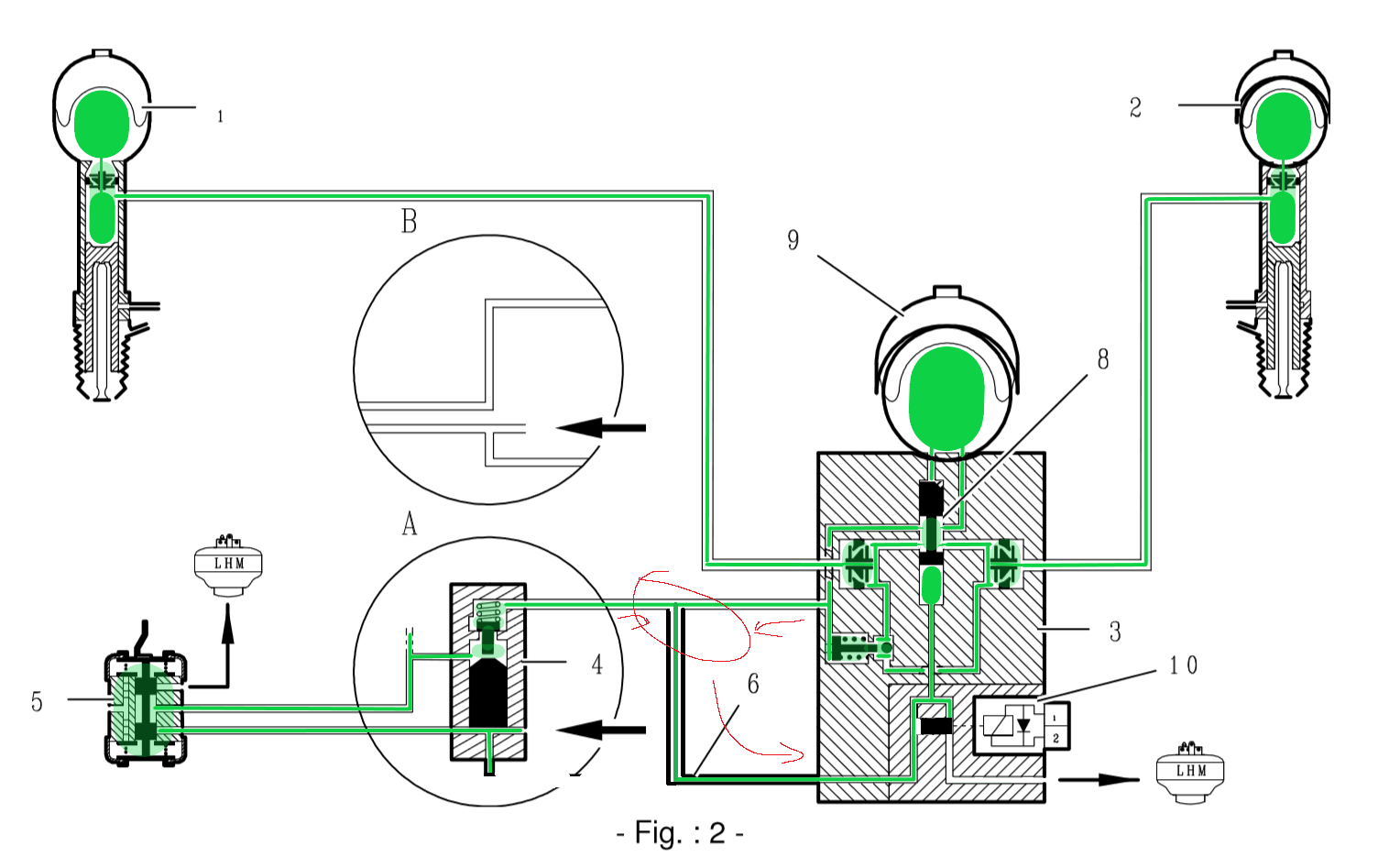

After a very pleasant vacation (about 3000km spent in the car. And man.., those eastern-european roads are so lovely when driving a hydro-pneumatic car!) the rear is still staying down as it should.
Nevertheless the ride started to feel a bit harsher when I returned back home. Somehow stumbled across a thread here which addresses the 'microbubbles', and well..., I have them as well. And a lot of foam when lowering the suspension completely.
Temporary fix for now is, lowering the suspension right after stopping the engine. This makes sure the system purges of its pressure (and air), without sucking up the expelled air again. Next to that I also concluded that my pressure regulator has an internal pressure leak. Both problems will get a permanent fix and I will post about these in the correct topics when I get to it.
Back on topic about those Hydractive Regulator blocks...

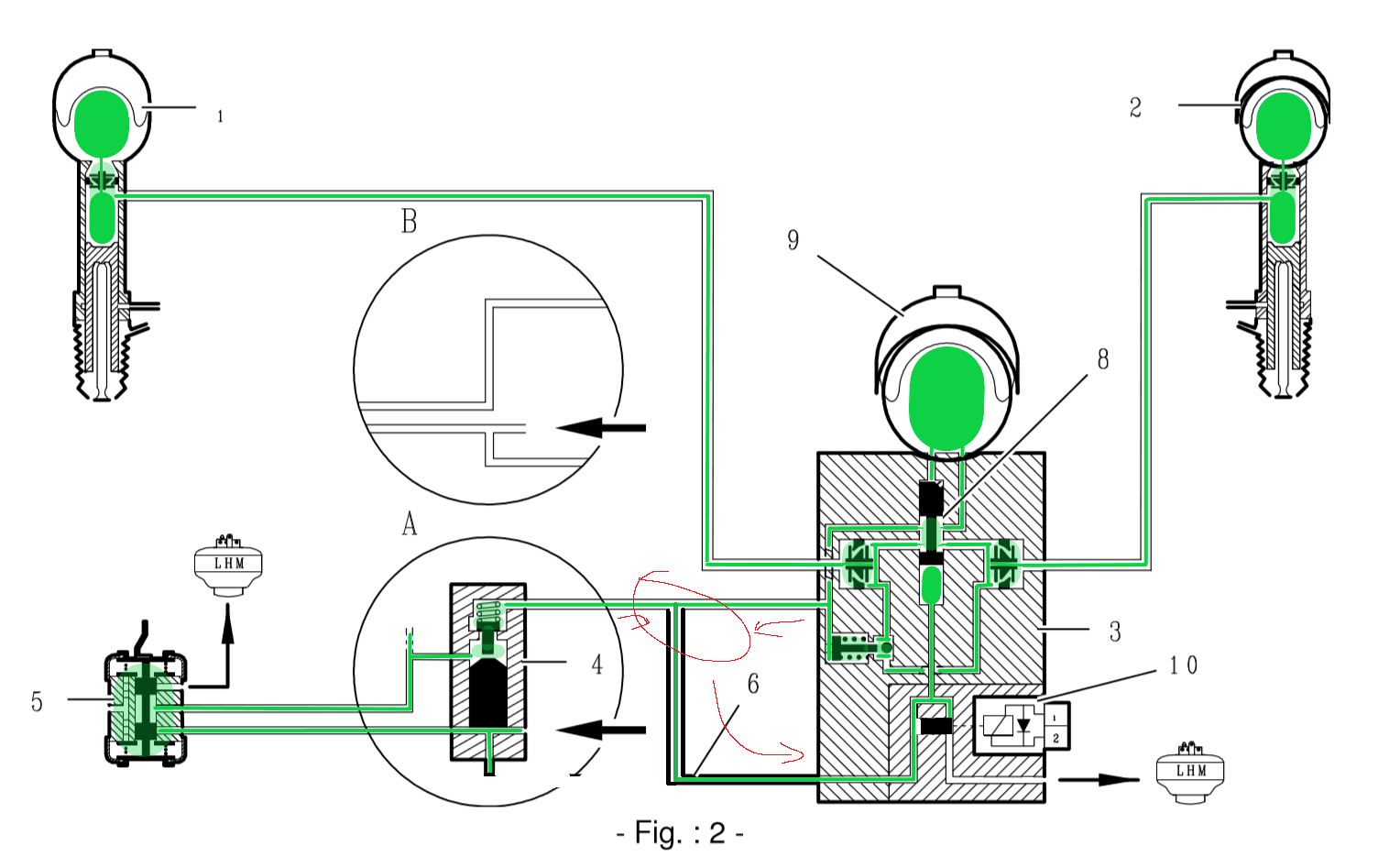

Since it is hard to find the revised design (or at least it seems to me), I've always wondered if there isn't a way to modify the original design of the Hydractive Regulator. I've pondered about trying to drill the same kind of internal channels in the block, but that seemed quite impossible to me. A few days ago I suddenly thought about something...
The same effect of the revised blocks should be achievable via external piping. The only 'difficulty' is that one should be able to make his own 3,5mm hydraulic pipe since you'd need to make 2 short ones of those. And additionally you need to get your hands on an extra 3,5mm 'T-junction'.
So it's not an easy way of modifying.., but maybe an easier alternative than finding those rare Xantia HAregulators.
*attached is a lovely Paint generated schematic of what I mean.
x 1746
Re: Evolution: Xantia Hydractive Suspension Regulation - Info
Interesting to try to find an alternative way of achieving the improvement, using the existing valves.
There are two items missing from your suggestion, though:
- the strong biasing spring for the main shuttle valve, which defaults the system to reliable Soft;
- a direct and always-open pathway from the HA sphere to the electrovalve shuttle (and main shuttle), and which provides the important equal pressure either side of the main shuttle (providing stability and immunity to hydraulic shock from the road surface).
If you pull up Fig.4 (p.8 of the Citroen document), that shows the extra internal pathway, uninterrupted by the main shuttle.

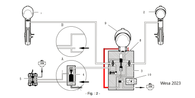

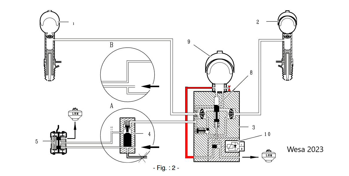

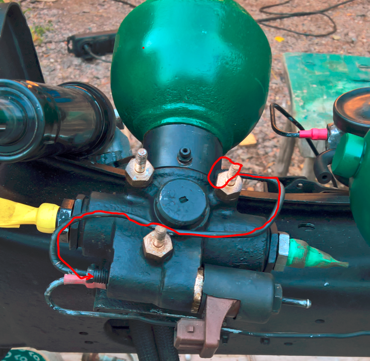

[attachment=1]I actually made this "evolution mod" by external pipe. My Activa project has been few years on idle but continued just few weeks ago.
This mod is now tested in rear suspension and seems to work perfectly.
Mod includes sphere adapter/extender with two additional M8 connection. One for the pipe and one for the air nipple. The valve spring is adopted from C5 regulator and plug behind is modified with stopper tap.
SC.MAC valve 5th connection plugged by blind plug.
In following link are some photos of this project: http://www.sitruunapatonki.fi/forum/vie ... 8&start=75.
I can share more photos and drawings if somebody is interested of it? Anyway it could better to being evaluated more widely before taking on roads.

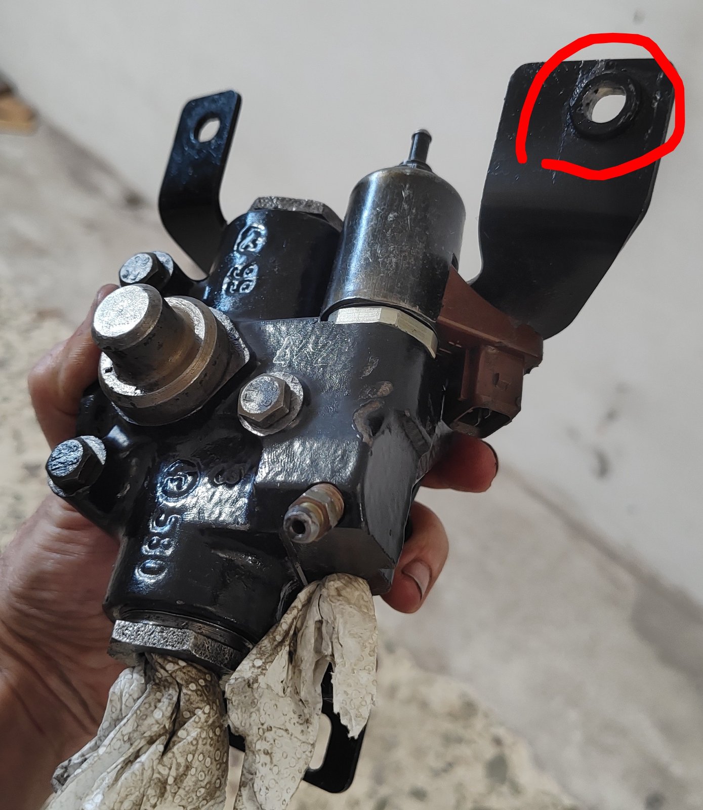

My '98 XM Turbo CT had a LHM leak from the front regulator, so I took the opportunity to mount the new type.
I didn't notice any difference in operation because the hydraulic system is already in good condition, but it allowed me to eliminate a superfluous pipe and this is certainly a positive thing about a hydropneumatic Citroën!
I had to make a small modification to the bracket in order to mount it under the subframe instead of above, otherwise the regulator will hit the steering box: I removed a pin and made a hole in its place.
The only difference I noticed is that the regulator works even if the engine has been off for several hours.
Just for information, the front damping valves of my XM have code 04 while the Xantia ones have code 26. Obviously I have replaced them.
Unread post by xantia_v6 »
Thanks for the report. I did not need to modify the bracket when fitting it to my XM, but I remember that the clearance was very tight.
