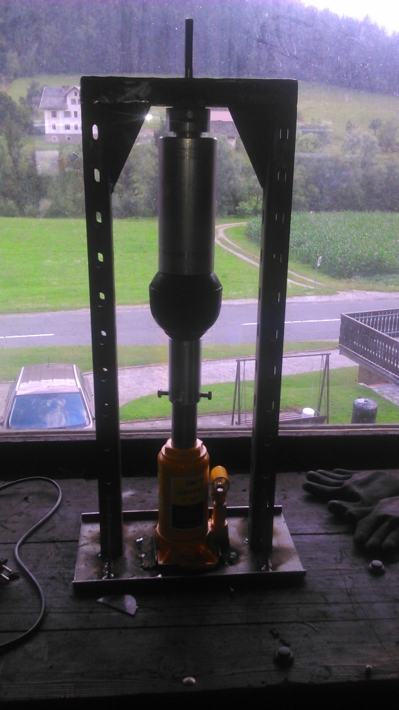

Another piece of my engineering skills!
A sphere recharger!
Didn't test it yet but I'm pretty confident it will work...

Is that simply to avoid having to use a regassing valve (eg Valprex)?

No. It's a recharger.xantiamanic wrote:This is a tester, yes?
Sent from my LG-D855 using Tapatalk
Here is my tester...
Yes. It's hard to keep stock for valprex valves and here not many people like them...white exec wrote:Is that simply to avoid having to use a regassing valve (eg Valprex)?

Re-gas jig:
So the same filling technique as factory original spheres with screw-in plug.
Bit of an engineering challenge to achieve a gas seal around the plug-tightening rod. Did it work?
Valprex valves do allow re-gassing of spheres still on the car, which can be useful.
