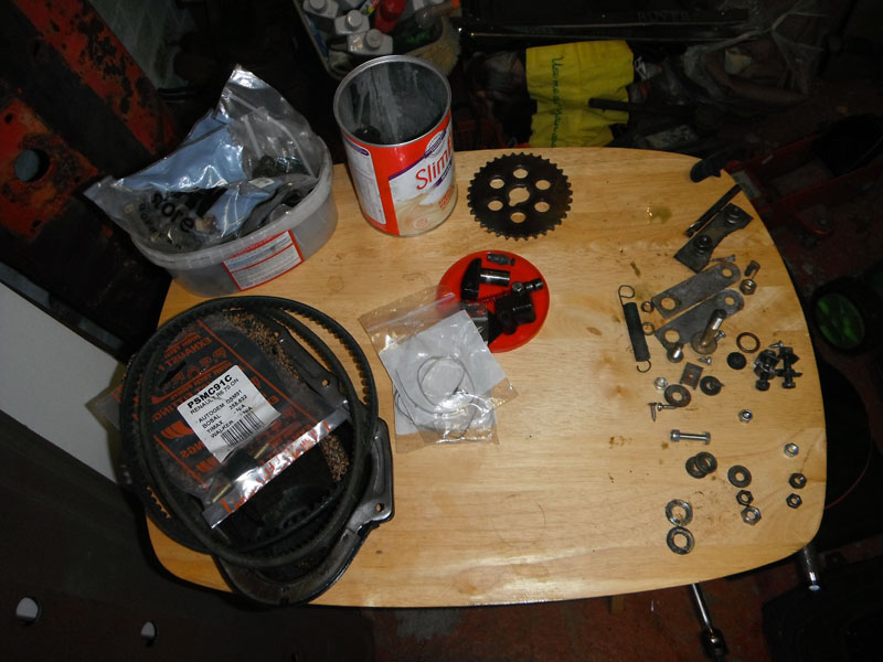

A little more caretaking today then. I might get out into the garage later to have more of a tinker with the engine and put a few more bits on, I might not. We shall see.

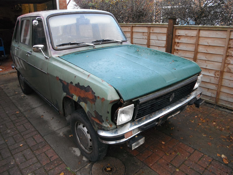

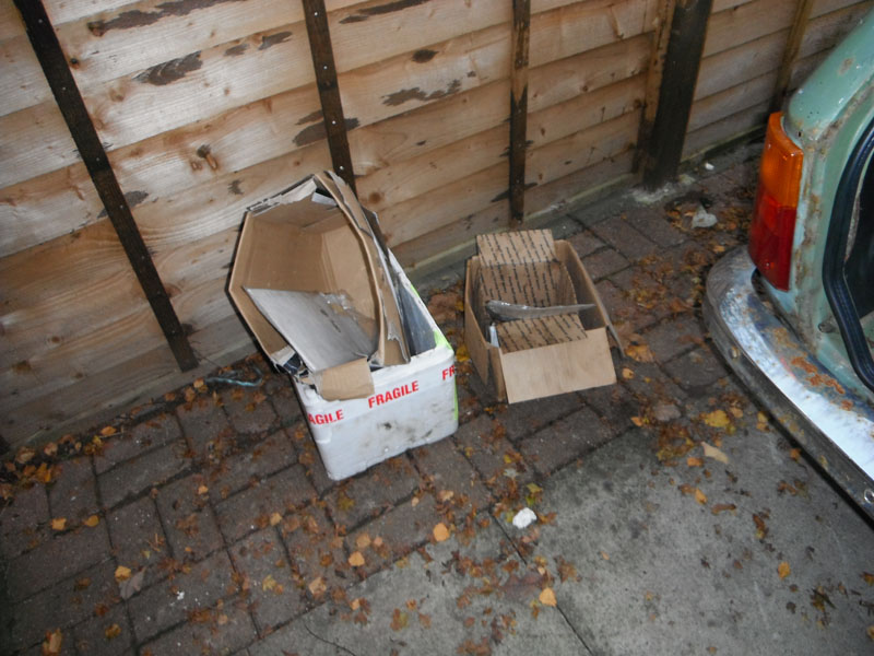

It's pretty annoying that I have to take the car apart to put it together again. Mike lent me a hand today getting the front end undone and then it rained and meant we couldn't finish the job. I need to remove the bumper to get the face and bonnet off so the weather meant I had to leave the car looking like this.

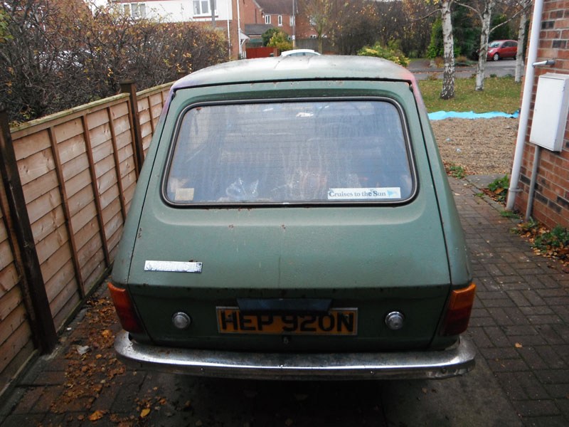

On the plus side, I can now see that the car is definitely leaking a lot less. The new boot seal appears to be working to keep a lot of water out, I just need to redo the side windows properly as that is now the main point of ingress at the back. The weather has been quite annoying today, just showers on and off so I called it quits. I hate working in the rain.

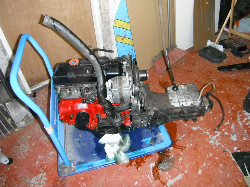

The last thing Mike helped with was getting the gearbox located onto the engine. We've got it held on with two nuts for now. The stud for the rocker bar turned up... in the rocker bar. I still can't find the bolts and washers for the timing chain cover which is annoying me as I've got everything else and I'm not sure how they've got misplaced given that all the components were kept together.

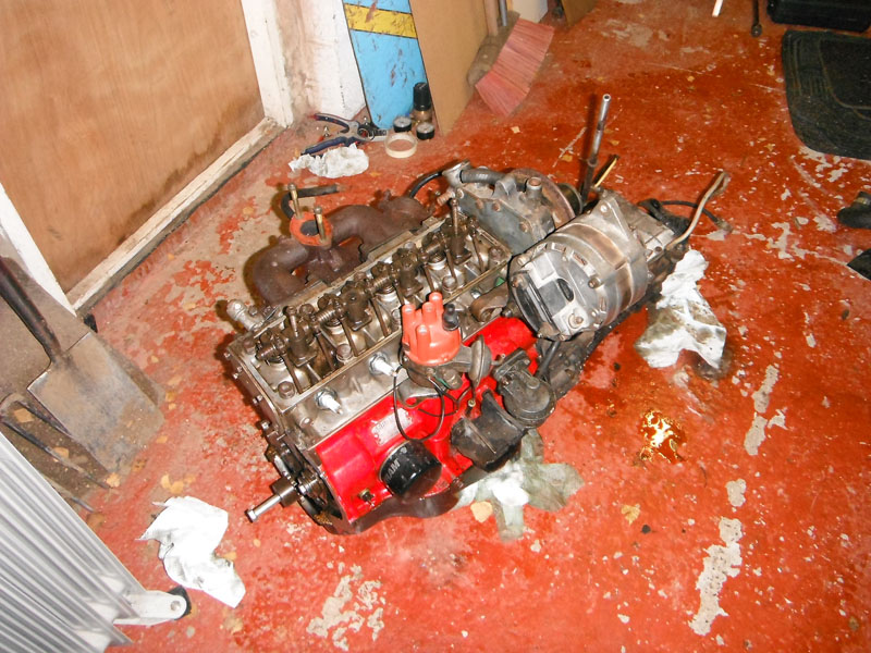

Progress is progress, I just wish it was something else. Engines are the WORST.
These boxes no longer have bits of engine in them. That's good.

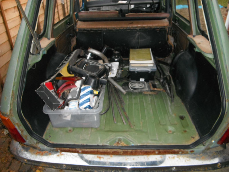

The boot is staying dry enough for me to keep what few spares I do have in it so the garage isn't so cluttered. This is also good.
My table of nuts and bolts and such is emptying. Another good thing.
The engine is looking like an engine properly, which is really the best thing.
Today, I got lots of things back on the engine. The sump bolts are all tightened up, the gearbox is bolted on properly, the engine-to-gearbox braces are done up and the bellhousing guard thing is bolted on. Alternator was taken off when I removed the head to fit the new gasket, then refitted once the head was torqued down as per the instructions in the workshop manual. While the alternator was off I put the spark plugs in the holes more so I don't misplace them than anything at this stage. The rocker bar was bolted on except for the outer two bolts which require a 11mm spanner which I don't have at home. Likewise, I haven't set the distributor properly as that also needs an 11mm spanner. The straightened pushrods were put back in their holes and the camshaft pulley bolted back on.
There's not a huge amount to do:
- fit timing chain tensioner
- fit timing chain
- set timing, both static and ignition
- fit timing chain cover
- bolt down rocker bar
- set tappet/rocker clearances
- fit belts
- fit any hoses with new jubilees that are going to be difficult to do with the engine fitted, like the fuel pump hoses.
Once that's all done I can plonk it back in the engine bay after the bumper and whatnot has been removed. Nearly there, I'm most likely to be held up by the short daylight hours as I need Mike to be a second pair of hands when it comes to removing bodywork and fitting the engine and he's only available in the evenings and weekends.

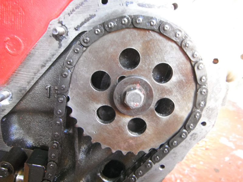

I am stumped so I'm posting this info on all the forums I use for this car. This is going to be a simple fix but one that I can't figure out, I've just ended up confusing myself.

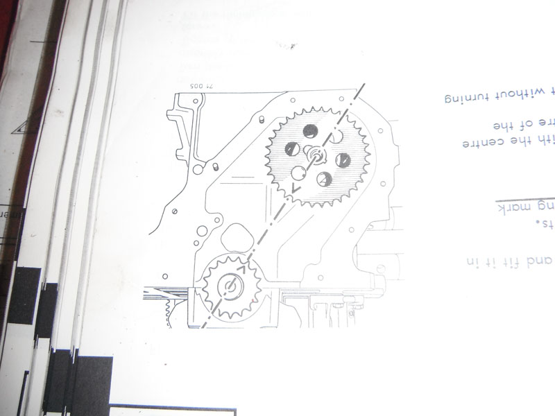

In the book it states there is a V mark on each of the sprockets the chain goes on. My engine does not have these Vs or if it does they are so feint as to be essentially invisible. Here is the helpful diagram (which is printed upside down for some reason)

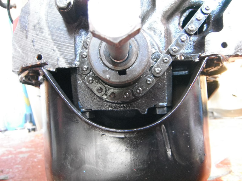

Now, when I first timed this I did it to "the timing marks" as directed by the Haynes and got it wrong because I lined it up to the two marks I do have on the sprockets that being a dimple on the camshaft and a blob on the crank, as below. The crank is at tdc when the blob is at the 10 o'clock position, piston nearest the timing chain is at the top when the blob is at 2 o'clock and at the bottom when it's at 8 o'clock.
If you line up as per the book instructions, taking the blob/dimple to be an alternative to the V marking, you cannot get a full revolution of the engine, presumably because a valve is touching a piston or something, I don't know. I wasn't inclined to force it, I'm being very gently gently in my approach. An internet hunt was futile, I could find info on how to time jet engines and ECU remaps but couldn't find anything to help me with this, I just ended up even more confused.
So now I'm cold and frustrated both with the job and myself.
