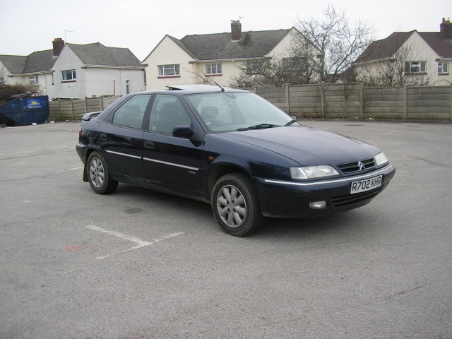

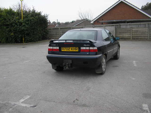

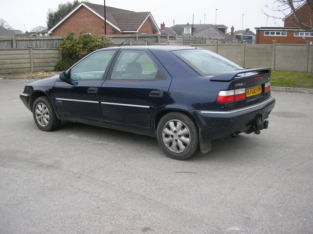

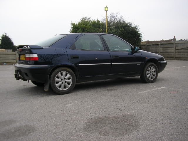

Managed to get home before dark today so managed to get a few shots in the car park of my local halfrauds after i managed to get some leakoff pipes due to a slight leak :)
Does need a bit of a clean :oops: :oops: but she is quite nice and tidy overall :) :)
Managed to sort of make a list of things that need doing none of which are to major,just going to take a bit of time and prioratising :lol:
1.Sort out ride height,particularly front end
2.Replace fuel feed line to and from fuel filter
3.Complete filter and fluid change
4.Rear spheres seem a tad flat
5.Possable fuel pump replcement :twisted:
6.Cambelt waterpump aux belt replacement and thorough check of all rollers/pulleys
7.Get the boy to earn his pocket money and give the car a ruddy good wash :lol: :lol:

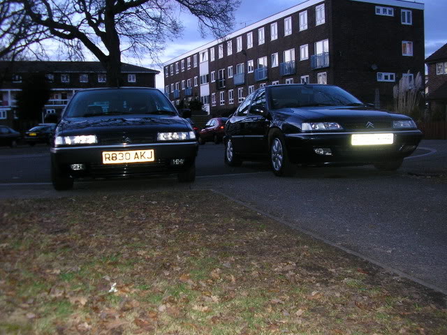

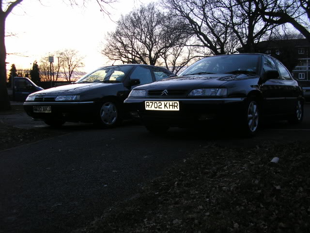

Was a bit late when the boy finished car washing duties but did manage to get a semi reasonable picture of both cars :wink:

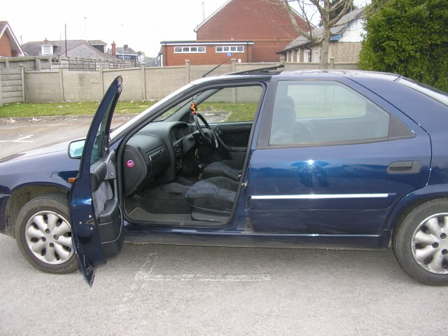

One problem i have found is that both rear doors will not open from inside but are both fine from the outside :? :?
Have tried locking/unlocking with plip and key but makes no differenve.My only thought was that maybe there is a child lock in operation that im unaware of...will need to investigate further

Colin, on the trailing edge of the rear doors there is indeed a child lock.
It is red in colour and circular with a slot and if you use your key to turn it gently it'll defeat the child lock.
