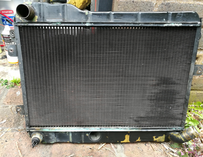

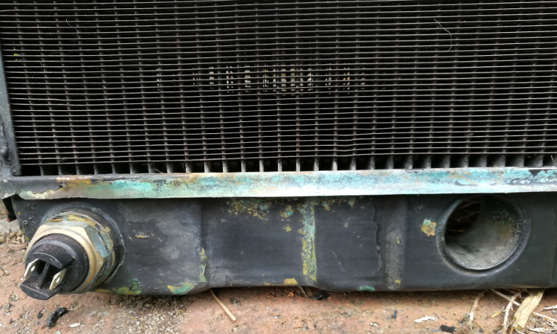

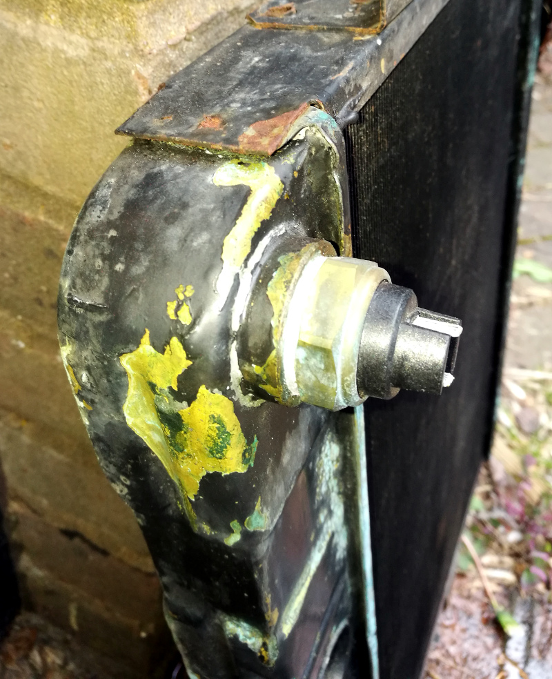

Back actually on topic, firstly I took a closer look at the radiator as it was readily accessible and I had to shift it to get to the toolbox - at which point it immediately peed coolant all over my feet of course. Actually looks okay to me, some surface oxidisation on the lower surfaces, but no actual corrosion it looks like (clicking the images should open larger versions). Of course the wonder of this thing is that if it were weeping from anywhere, it's actually serviceable! Heck, it would be actually viable to get the thing re-cored if it came to it (though I believe that replacements are pretty readily available). So I'll give the end tanks a blast with the pressure washer to shift the loose paint (being careful to avoid the core of course!), then degrease it and repaint. I'll probably treat it to a new pressure cap as preventative maintenance as it definitely looks original.

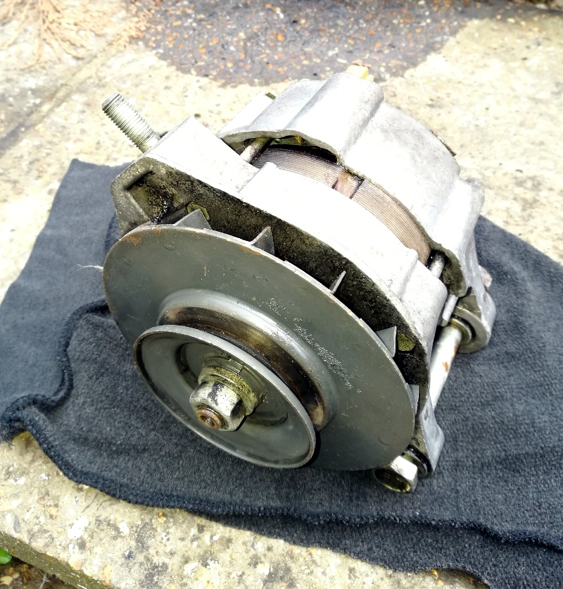

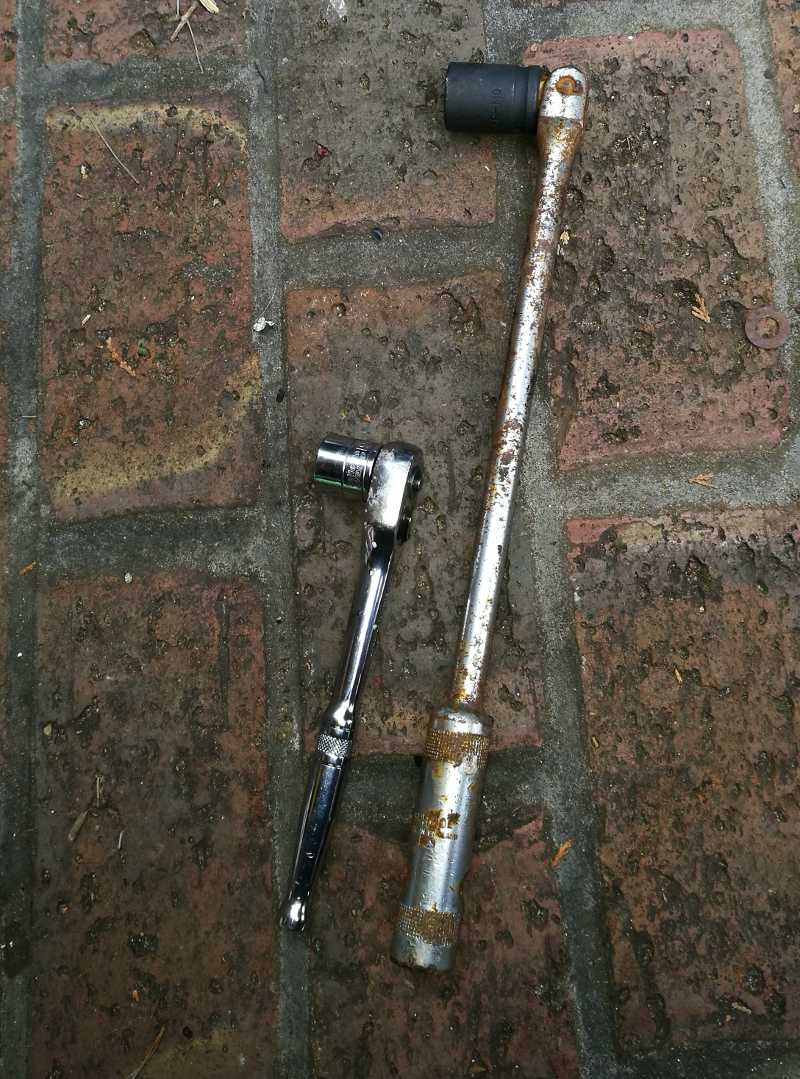

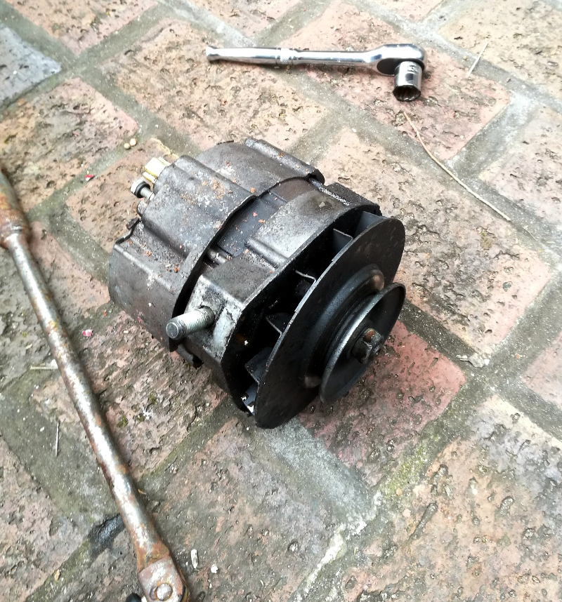

The problem I'd had earlier in the week was that I couldn't shift the 19mm nut on the lower bracket of the alternator. I couldn't get my "torque amplifier" in down there, so needed to track down a socket with a 1/2" (not 1/4" as I said earlier...that was my deliberate mistake) so I could stick the "slightly more serious" driver into the equation. Strangely, I didn't have any issues once I'd switched from the driver on the left to the one on the right... Within five minutes I had the nut off, the bolt out, and this thing was sitting on the floor. ...In a pool of coolant and oil.
A couple of cans of carb cleaner later (seriously...I love the Wynn's cans of carb cleaner - they're like a solvent-based pressure washer in a can...I don't care that they last about 30 seconds apiece - there is very little they won't shift!), and it looked a bit healthier. Hey, the fan/pulley is actually grey not black...who knew?

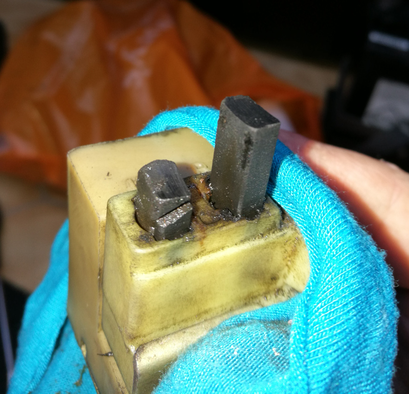

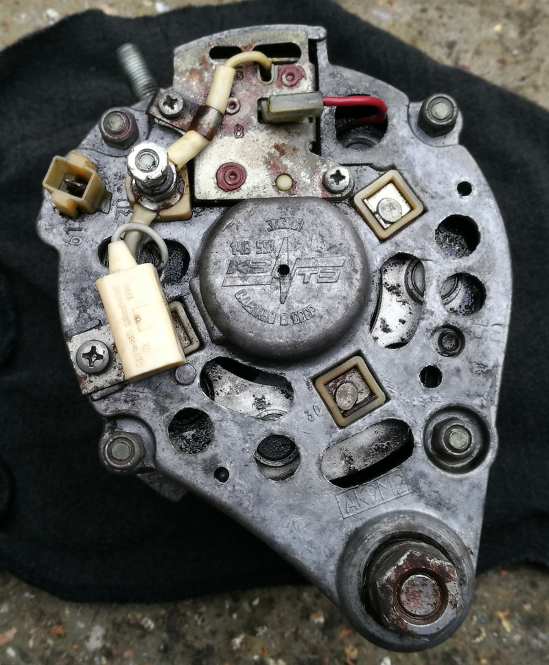

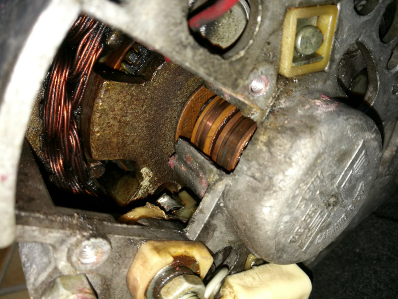

Back of the alternator has a total of two connections to it (plus ground), guessing there must be an external voltage regulator somewhere...I'm not a huge alternator expert I have to admit! Doesn't take a genius to look at that and figure out where the brush holder is.
...I think we can call off our search for the problem! What I'm guessing has happened is that the one brush has cracked at some point goodness knows how long ago in the past, but has just about been managing to hold in there until that bit flaked off too (the last 1/8" with the wear surface on it on the brush to the left was sitting in the casing when I took the brush holder out) and suddenly my alternator ceased working! Just count myself lucky I got home before this happened!
Looking at the commutator seems to bear out that theory that the one has a "thinner" wear pattern than the other. Let's see how much a new set of brushes costs me...Hopefully that will get things back up and running again.

Zel, excellent result on the alternator... I buy my carb cleaner - it's the only solvent I'm not allergic to - in 5 litre cans from Motorserv... Best way to buy it... It is magical stuff
Brushes I guess will cost pennies

Have already dropped Tom an email about the brushes. They don't actually come out of the holder altogether so I'm guessing it comes as a module (well, the actual brush holder does break down further so it's just the plastic base and a spade connector), to make changing easier. Sure ten seconds with the soldering iron would have them out though! Sadly brushes aren't something I have just randomly laying around or I'd already have had had a dig to see if I had anything the right sort of size I could fix it with. Not holding my breath, but will swing by Motorserv tomorrow, failing that also the little car parts shop on the high street in Stoney Stratford... They're old enough that there might just still be a dusty old box of assorted brushes still buried in a corner of the stockroom. Worth an ask surely! If I can fix it tomorrow rather than later in the week I'll take tomorrow!
Will probably give the radiator a paint tomorrow anyhow and swap out the rocker cover gasket to stop that leaking (hopefully). Was pondering changing out the few remaining hose clips - but they're all on small bore coolant pipes which will be getting removed and rerouted when the EFi conversion happens so just going to leave them for now. Especially as two of them are a right git to get to, being buried under the exhaust manifold. It will be a lot easier to get at them when the carb and intake manifold are off.

New set of brushes are on their way now, so hopefully will have things back up and running soon.

CitroJim wrote:ExcellentHow much did they cost?
£4 Jim, apparently the 25+ year old dealer tape still attached to them has been thrown in for free too!
