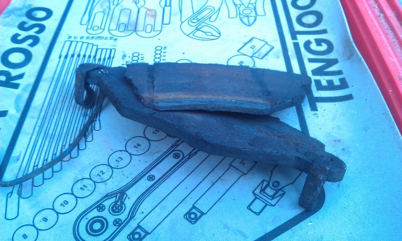

After I finished my C5, I then set about replacing the front brake pads on our 2002 C5 2.0HDi 110 SX. They were starting to get ready for replacement:
:shock:
Actually, it had been warning of low brake pads for a day or two. As I reversed it out of the garage this morning I noticed a clunk when braking in reverse. So I whipped off the wheel to find the inside pad had become unbonded from the metal backing plate. The loose friction material must have chopped off the low pad level sensor and triggered the light. They were getting right down and needed replacing anyway. It now has a new set of pads.
