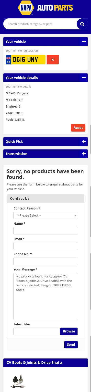

bobins wrote: 15 Jul 2024, 19:28 ... try a lookup on the NAPA site to see what they have to say.
https://www.napaautoparts.co.uk/
Another dead end unfortunately!!
Nowt found!
Nowt found!

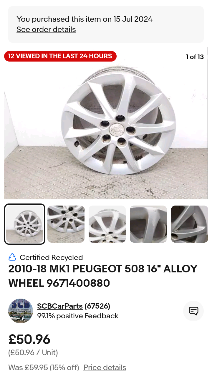

Oh, reminds me, one new rim on order:
Rim
Rim
£43.32 with a discount code. Should arrive at home before I do!

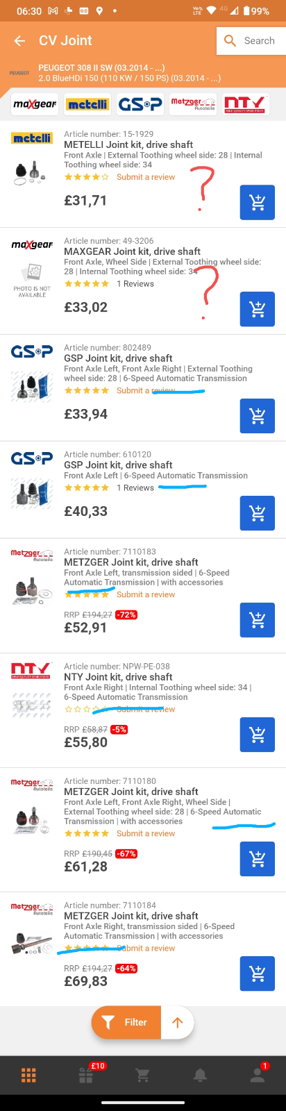

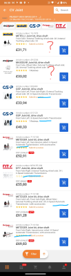

Very few list a CV joint alone that is definitely manual gearbox fitment, e.g. Autodoc:
CV joints on Autodoc

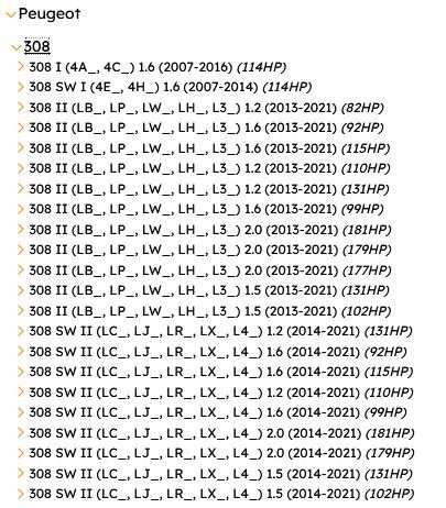

Unread post by moizeau »
Not sure of the measurements or even if I've got the right car but.... this seems to show manual and auto https://www.piecesauto24.com/peugeot/30 ... otules-jeu

moizeau wrote: 17 Jul 2024, 07:21 Not sure of the measurements or even if I've got the right car but.... this seems to show manual and auto https://www.piecesauto24.com/peugeot/30 ... otules-jeu
Thank you for digging, interesting that gives different results as seems to be another variant of the Autodoc company(s!!)
