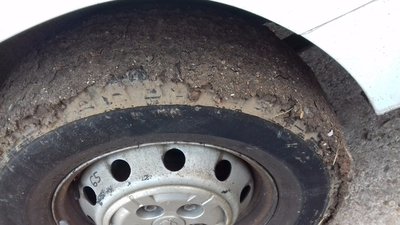

Took Xantia to shops today just to give it a run. Its gearbox oil has arrived but not its funnel so I'm waiting for the postman tomorrow. He should have my fuel pressure reg too. Had a big bonfire today so cars covered in ash as well as the usual bird poo. Having chicken for tea as revenge.
Van is terrible at off roading. Had to take a new polytunnel into the fields today, van did not like at all. The steering wheel became an ornament and i was quite sure id get it stuck. Job done though and van back in the yard where it belongs. Good van.

Re: Elmas Xantia V6 and Musical Stuff
There are few things more terrifying off tarmac than commercial tyres!
Having said that, on slightly damp tarmac they're frightening enough...
So true, easily forgotten driving a Van as refined as the Boxxer. My old LDV was far more sketchy in the damp but the agricultural spec didn't hide that at all so it was quite expected. Possibly the pickup would be better suited to what I need here but I don't see the MD handing me the keys to his vehicle anytime soon. It's a Mitsibushi as well, not that thats a problem but I like having the Peugeot next to the Citroen it makes me smile that I've ended up with a PSA mini fleet. That Zx Volcane that's for sale currently would finish it off nicely as a cheap runaround but my eyes are always bigger than my wallet. I'd buy the Grey V6 for sale at the moment as well if I could and every Activa that ever came up for sale.
Why are commercial tyres so much less grippy than radials? I get that they need to be stronger but I don't understand why they can't have a grippier contact area. Considering the longevity of commercial tyres they could afford to knock a couple of years off of the life for better grip. I considered that softer rubber would deform too much under the weight but that doesn't make sense if you think about various cars and Vans rough axle weights.
I think it's a combination of a far harder compound, usually less aggressive tread pattern and often far higher inflation pressure (even the ones on my little VW T25 ran at a standard pressure of 60psi, increasing to 75 if fully laden). Seem to recall the tyres on the car transporter at the garage (7.5 ton Man wagon) needed to be inflated to something like 120psi. Felt like they may as well be solid until you stuck at least two cars on the back! Besides your backside leaving the (suspended) seat over bumps, wheelspin on a damp road was entirely possible in the wet in anything up to 5th (out of 6) gear! If ever I encountered a vehicle that needed traction control - that was it.
Stick two or three cars on the back and it was fine though.
Terrifying but eye opening moment for me was the first time I tried to stop rapidly in a bus on a damp road. Locking all four wheels on something that weighs north of ten tonnes is not fun!
That would be amazing Jim. If it was my farm and my cash you'd have inspired a project there. I know from livong up in the hills Xantia estate diesels are prity good on mud tyres.
Van has mud tyres, but not the sort for driving on mud. I think i found where my grip went. Ill drop pressures to 35 psi next time i go off road. All wheels locked on a 10tonner! Not for the feint hearted, dont think I'd enjoy that much either. Congratulations for saving the cat, not fond of them but they don't deserve squishing.
