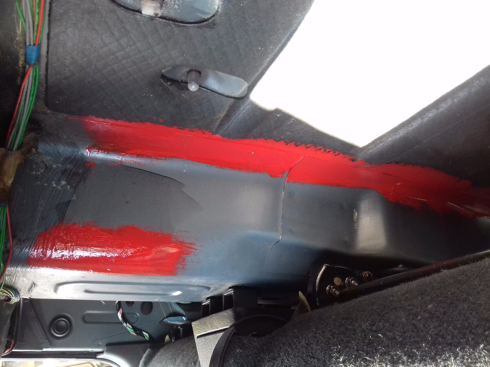

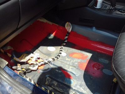

Rust has all been removed from footwells and the areas treated.
Just waiting for the kurust to cure then some painting.
In the meantime some more cleaning.
That hose to the tank still looks sealed, only one to go.

Paints done, I found a tin of post office red from my old van. Saved a lot of time not having to mask and spray. Doesn't look amazing but no one's going to see it. The important thing, that the surface rust doesn't develop further, is achieved.
I had a check on the pressure reg and center block and they were dry. I think oil fromy the leaky Cambox may have dripped onto them. Will check weekly for a little while until I'm totally satisfied.
On the face of it this means I just have to refurbish the pump, fix one hose, change some spheres and the lhm the achieve a healthy system. This seems about right for this car, its been loved but needs tidying up and a really good service.
Speaking of spheres all the ones I had were used. I'm just going to order some as soon as possible.
