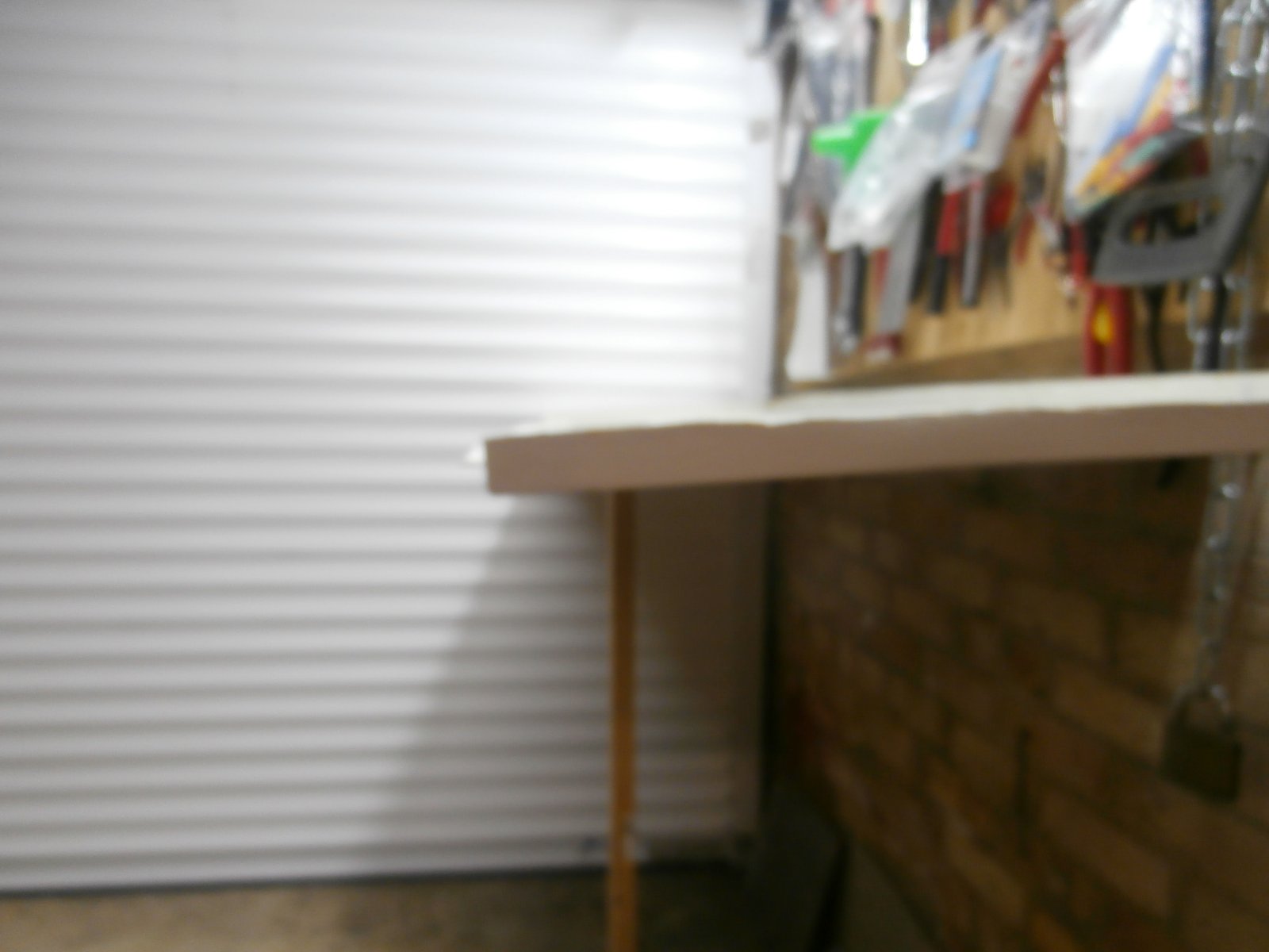

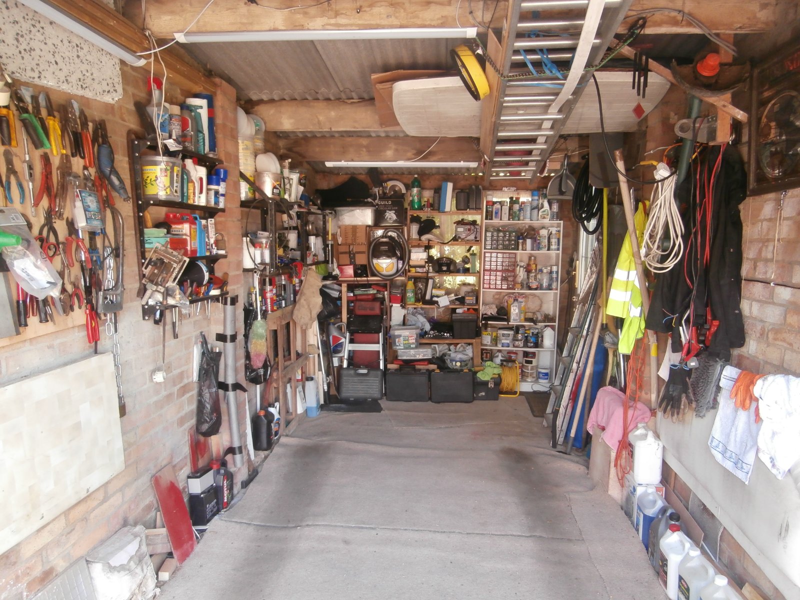

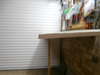

As I am still waiting for the Workmate transfers I turned my attention to the garage in which I wanted to get the final clear up done. Another lot I collected from last week's auction was the three sets of storage drawers you can see at the back. They allowed me at last to tidy up all my small bits and pieces from micro switches to velcro etc and make the whole place much more usable. With the drop down bench on the left raised and the removable vice installed I now have a reasonable space for ongoing DIY projects!!

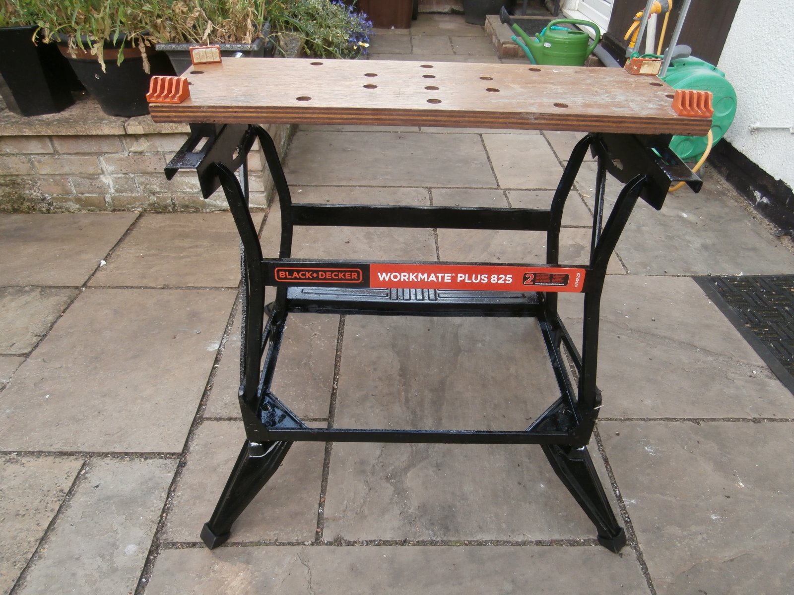

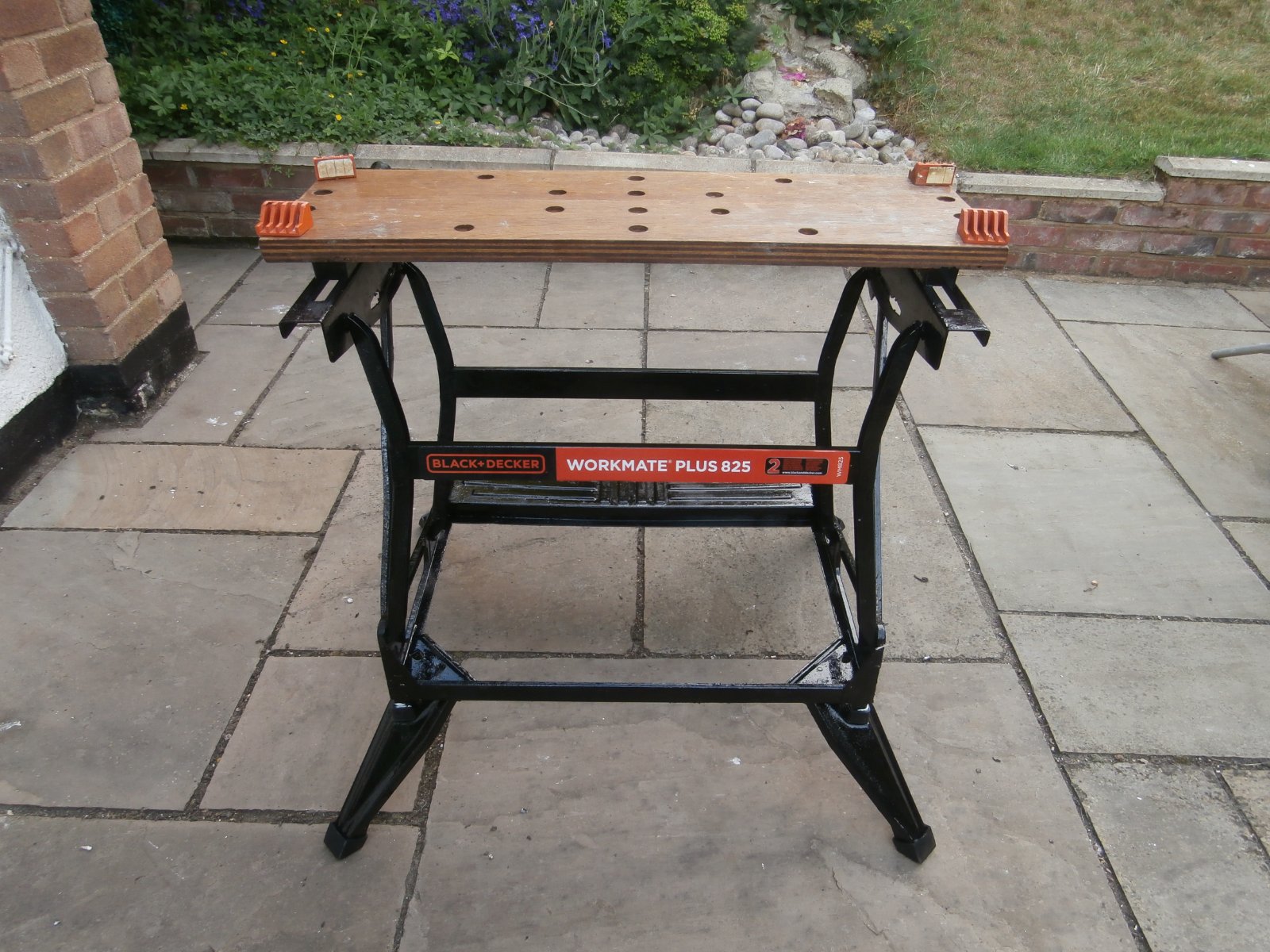

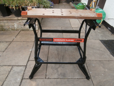

The stickers arrived today so I was able to finish the workmate project, fit the feet and stickers and the job was done! Well chuffed for a total outlay of £23.45
I've got one of those, can I send it for a service?
I bought this one for my dad many years ago, when he died it had a label tied on saying "This is Eric's ."
- Posts: 21290
- x 8144
I'd be happy to do it for you Eric but somehow I can't see it being an economic option!!Gibbo2286 wrote: 15 Jun 2022, 18:03 I've got one of those, can I send it for a service?![]()
I got all the parts from ebay and had a can of hammerite in stock!! Give it a go!!

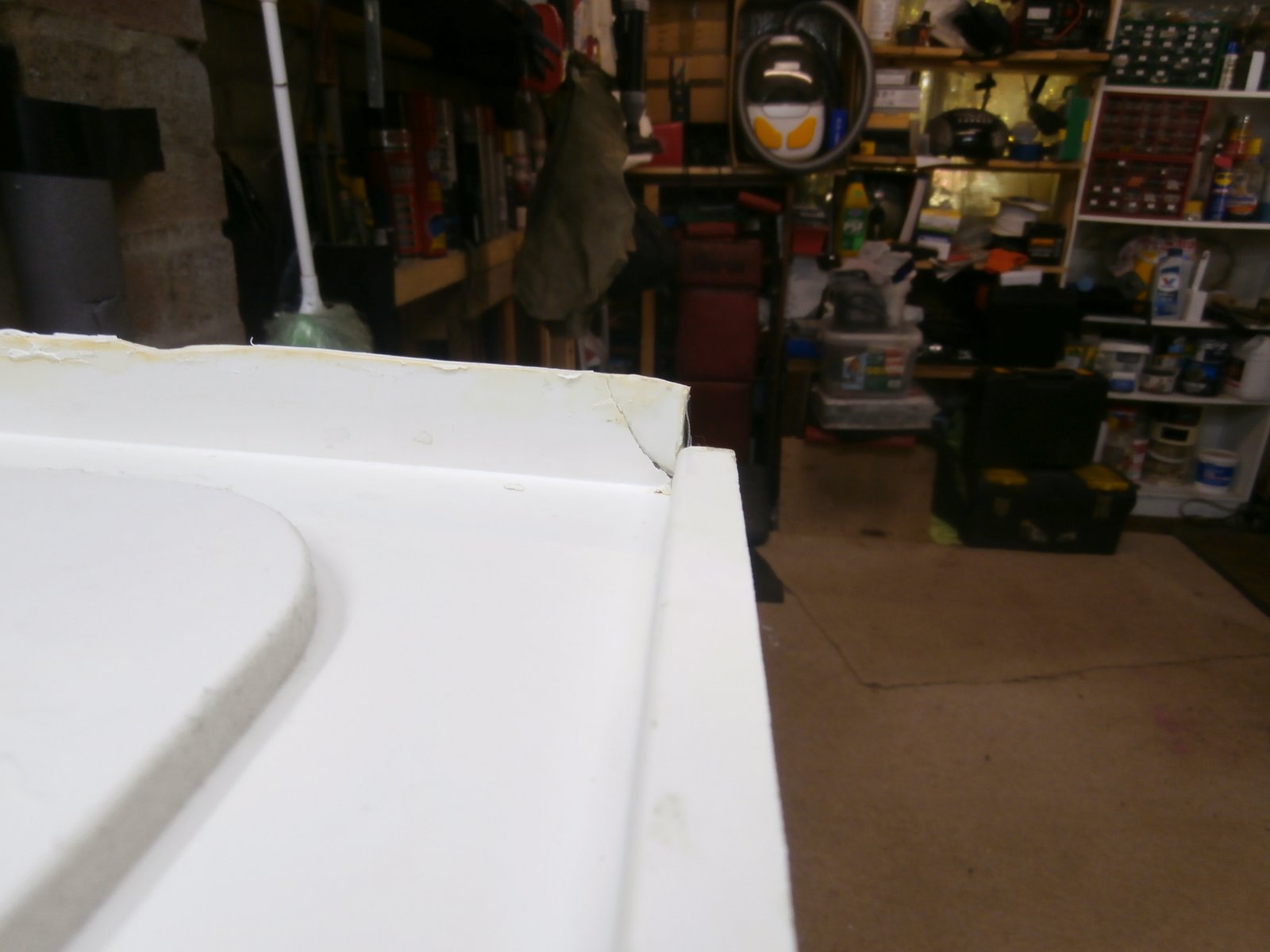

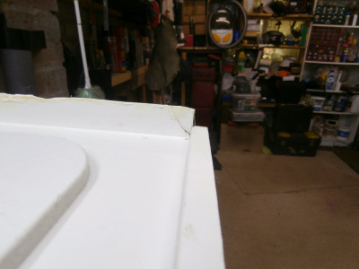

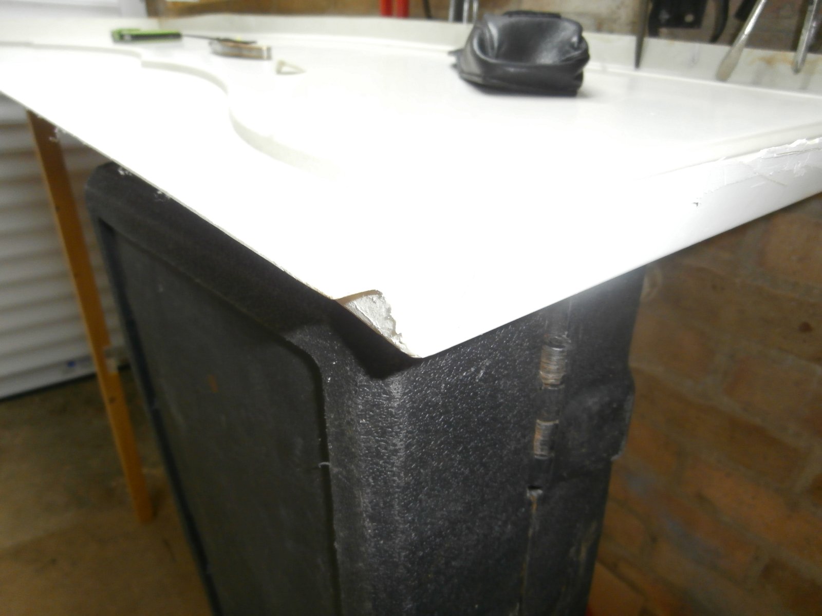

Today's job is a simple (ish) repair of our bath side panel. Somehow SWMBO had managed to break off the corner of the panel while cleaning the bath??? So I am faced with a new panel set or repairing the damage - no brainer!
This is what it looks like before repairing:

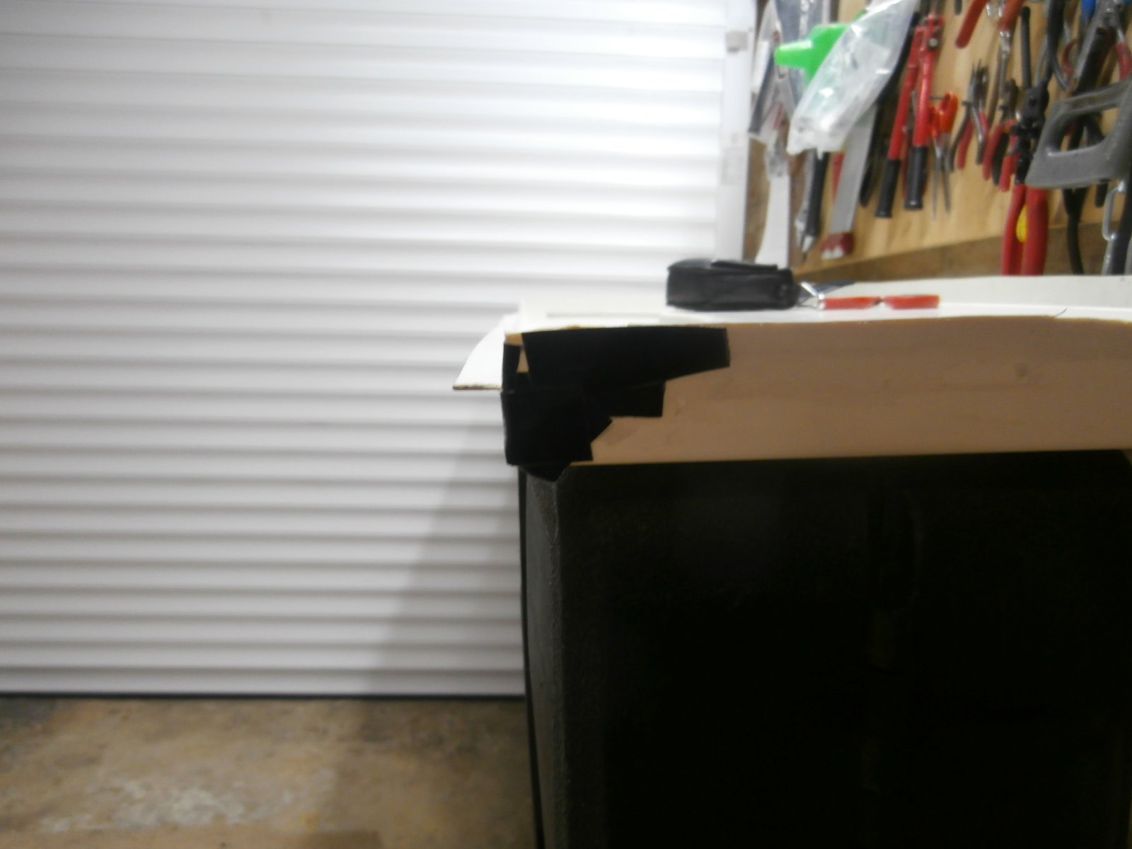

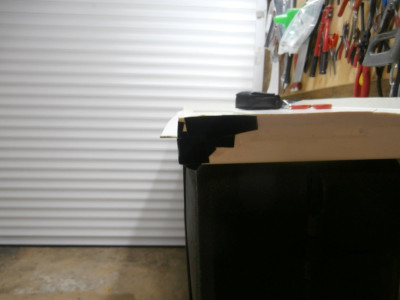

Having looked at it closely I decided to go for one of my standard plastic repair methods which has been very successful on motorcycle fairing and car bumper repairs.
That involves making a mould and then filling from the inside to produce the new corner. So basically I have made a false corner using gorilla tape with cellophane on the inside where I can now lay in the plastic and see how it goes:
I shall post up the results later after the setting time.

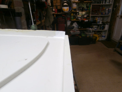

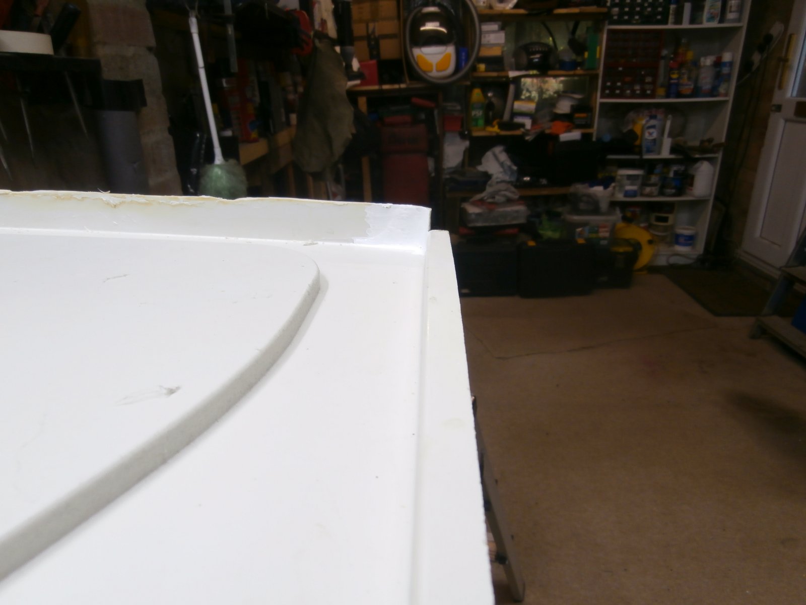

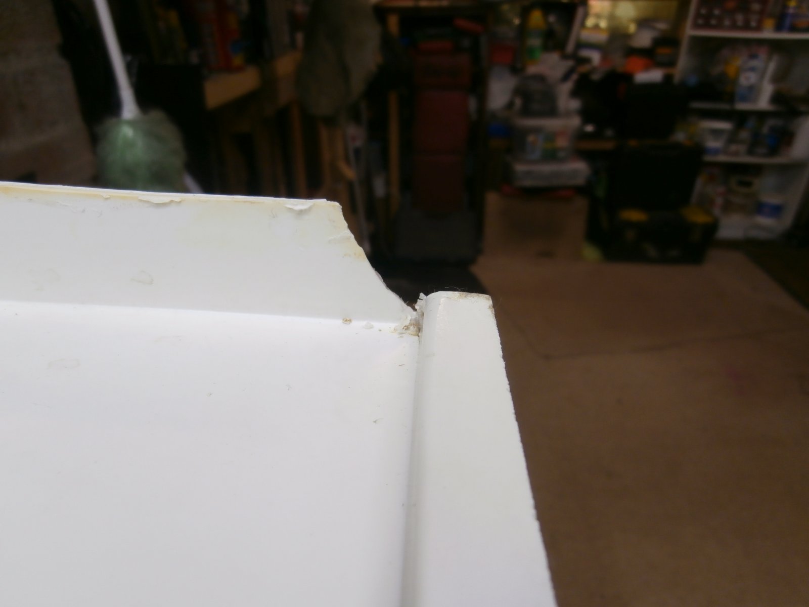

The moulding has set and been painted:
Just wait to see what it looks like later when reinstalled!!
- Posts: 21290
- x 8144
Well, its passed muster with the Colonel so That's a Job in line with the thread title!!

The Plastex, is it plastic resin? Where can I get it from not seen it before.
Champion of Where's CitroJim
- Posts: 21290
- x 8144
It is two part, powder and solvent and they provide some moulding compound in the kit which can be softened for moulding and then sets solid for you to apply the resin. It is not cheap but if you follow the instructions it does a terrific job. I have repaired many fairing cracks, birds drinking bowls and garden pond leaks. Here is the link:Rp0thejester wrote: 23 Jun 2022, 19:26 The Plastex, is it plastic resin? Where can I get it from not seen it before.
