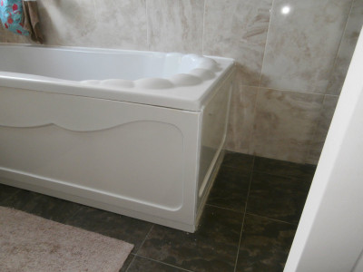

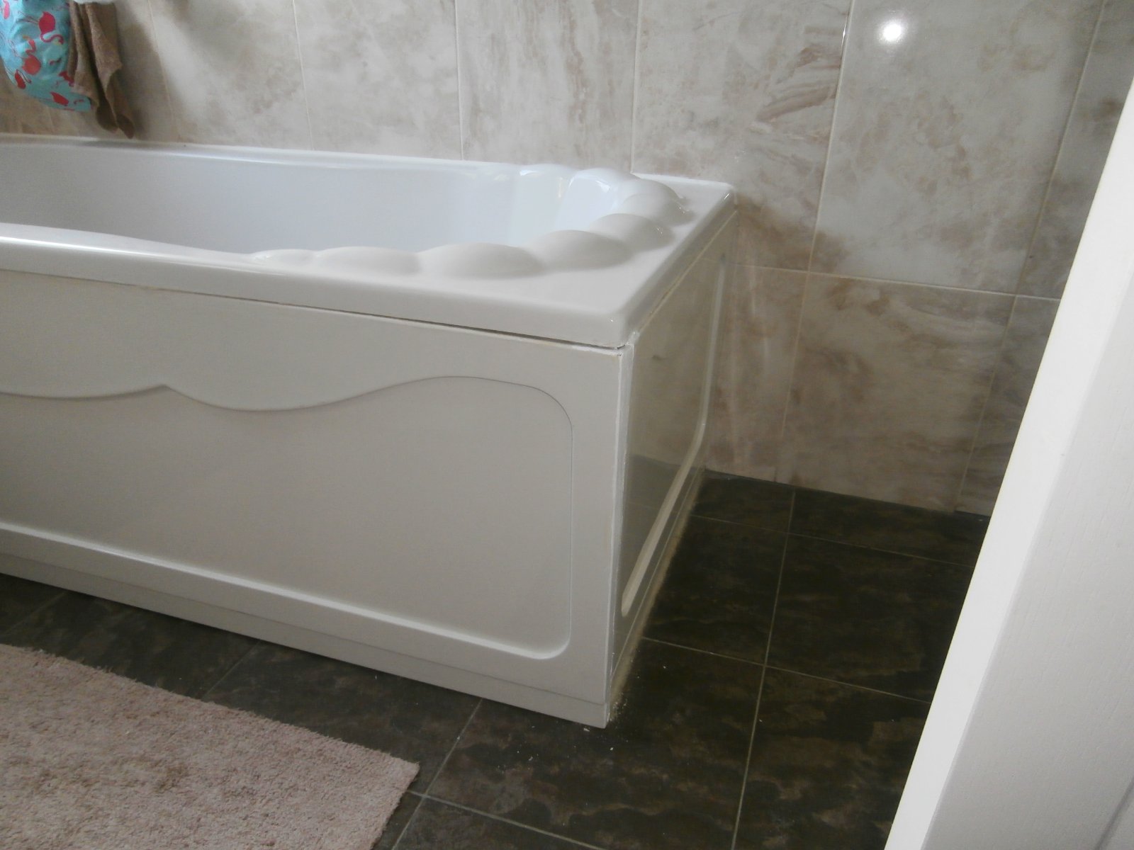

Today's job is a simple (ish) repair of our bath side panel. Somehow SWMBO had managed to break off the corner of the panel while cleaning the bath??? So I am faced with a new panel set or repairing the damage - no brainer! :-D
This is what it looks like before repairing:

Having looked at it closely I decided to go for one of my standard plastic repair methods which has been very successful on motorcycle fairing and car bumper repairs.
Own work
Own work
That involves making a mould and then filling from the inside to produce the new corner. So basically I have made a false corner using gorilla tape with cellophane on the inside where I can now lay in the plastic and see how it goes:
Own work
Own work
I shall post up the results later after the setting time. :-D

The moulding has set and been painted:

Just wait to see what it looks like later when reinstalled!! :-D

Well, its passed muster with the Colonel so That's a Job in line with the thread title!! :-D
