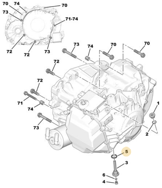

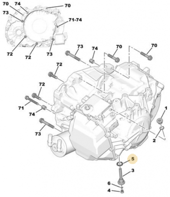

As long as you have access to a Lexia or suitable diagnostic system that can reset the oil counter you can do this yourself:dme88 wrote: 20 Sep 2020, 02:52 Hi!
Im uncertain about the oil needed in my car VIN: VF7**************[VIN obfuscated, can be read by forum staff]
Local dealer refuses to sell the o-ring and washer needed, insisting I should bring it in for a 500 eur 3L change. Is the o-ring of standard type?
As Bill has mentioned - about 3 changes should be done about a month apart (depending on your mileage), to allow the oil to circulate and pick up any crud before the next change. About 3 changes will be as near to a complete change as you can get without breaking the bank - as the oil is expensive. (I've replied to your PM regarding the type of oil you need for your specific X7).
As for the seal, ignore the dealer - just ring up and order the part yourself.
For your specific AM6:
The oil plug seal is item (5) on the diagram and is part number: 221923. (Dimensions: 20 X 27 - 2) and costs (UK prices) £4.14 inc. our 20% VAT., for reference. Most dealers should have a parts section - so just ring up and ask for parts and ask if they have it in stock - pop in and pay for it. Don't go via the servicing department as of course they will try and get you to book it in for a service.
wfdTamar
- Posts: 89
- Joined: 30 Sep 2019, 23:14
- x 2
Re: Aisin Tf-80 / AM6 Oil Change Questions (Mini-Guide Page 4)
I didn’t renew the washer on the top fill point (40Nm). The drain plug washer I did (50Nm), but as the smaller leveling bolt (which is the centre of the drain bolt) is only done up to 8Nm you may get away without replacing the O-ring on it. However if you can buy the bigger washer, you might as well get the O-ring too.
2015 C5 Limited Edition (2.2 HDI) 150 kW 450Nm (Racechip S 179kW 528Nm)
moizeau
- Posts: 1865
- Joined: 12 Jan 2015, 16:08
- x 429
Replaced parts 3, 4 and 5 but not 2 in the diagram above. Make sure you have good torx sockets, the top one is particularly tight.
