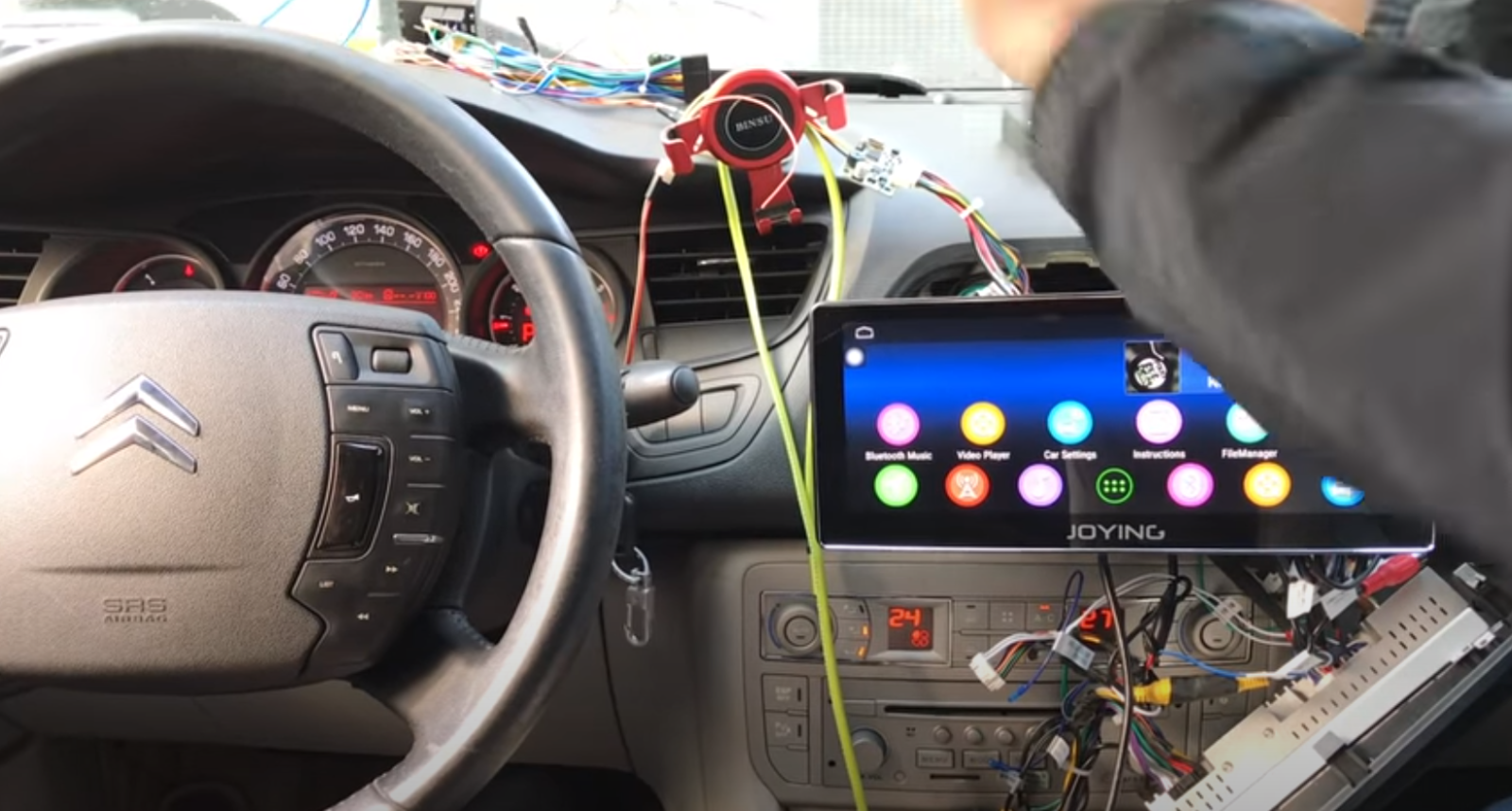

Nothing's impossible Javier, but there won't really be anything here on that sort of thing, as we tend to deal with trying to fix and upgrade OEM kit here.
Most of these other aftermarket kits will require butchering the car to some degree, as some units are attached to their own screen, so need a different fascia or modification if you want a proper look.
Not sure I would want this...
I've never really seen any that look good - most tend to have a huge screen sticking out and it looks stupid, but this one looks better to me:
rijndael
