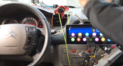

Nothing's impossible Javier, but there won't really be anything here on that sort of thing, as we tend to deal with trying to fix and upgrade OEM kit here.
Most of these other aftermarket kits will require butchering the car to some degree, as some units are attached to their own screen, so need a different fascia or modification if you want a proper look.
Not sure I would want this...
I've never really seen any that look good - most tend to have a huge screen sticking out and it looks stupid, but this one looks better to me:

Yes, Marc.
I've seen on Internet some pretty good finished Android installations, not only those you show.
I know this is not the proper thread to talk about this, but I'm sure that most of us will be in the same situation...
Any info about the best Android unit to install in a C5 X7 (2012 model), where buy it and how to perform the installation, is welcome.
Thank you again and regards.
Javier
Javier

I think most of the one's I have seen are the 'Joying' units - but they do several different models. Probably from their website:
These are the units they say are for Citroen models:
https://www.joyingauto.com/eu-warehouse ... radio.html
