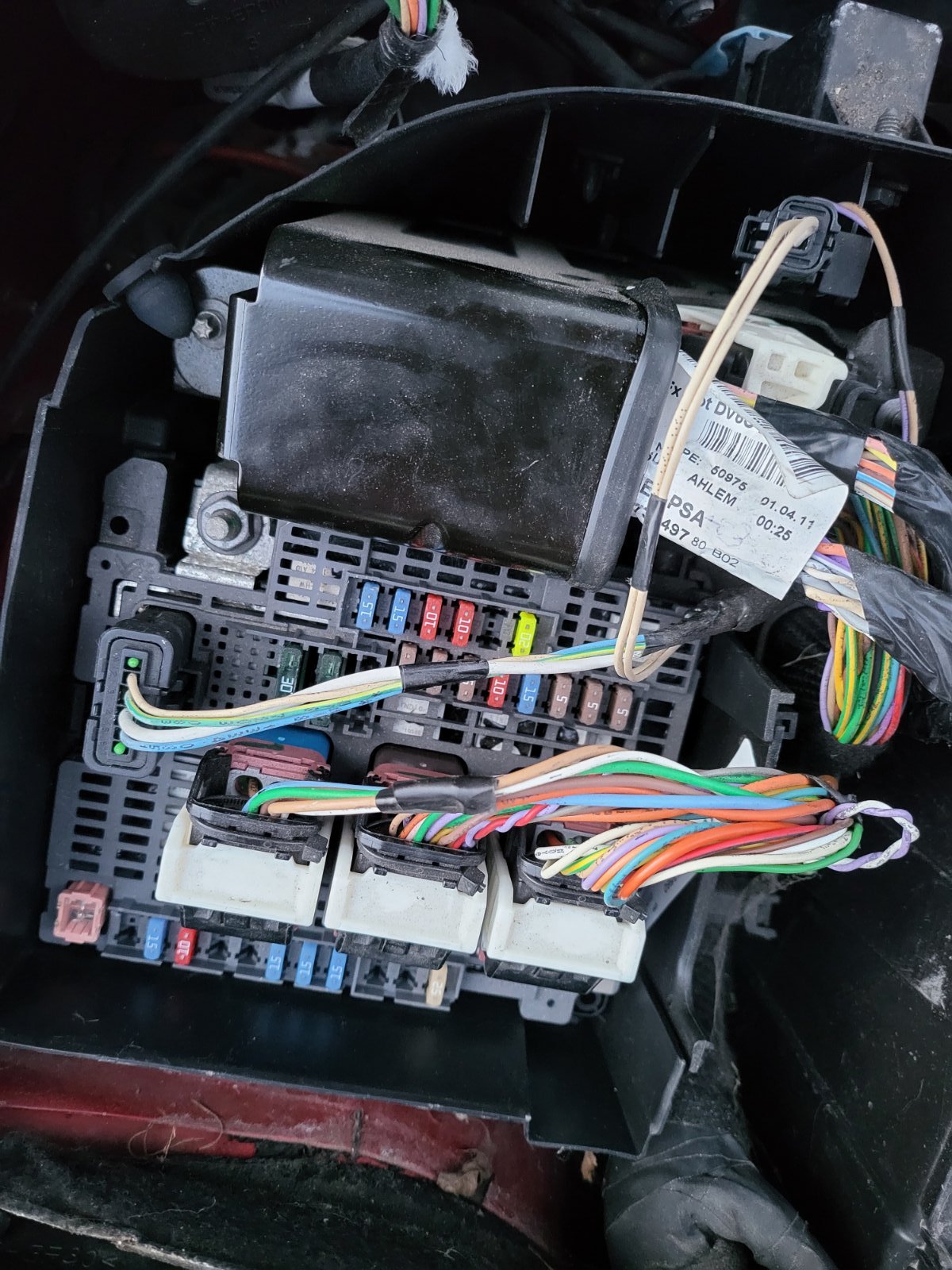

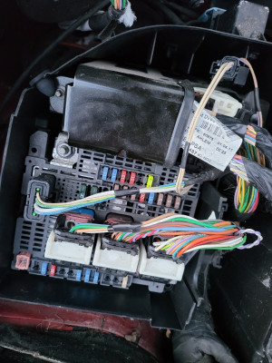

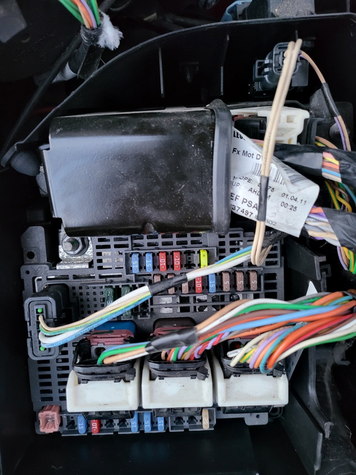

yommitte007
- Posts: 1
- Joined: 22 Jan 2024, 16:43
Re: C4 heater/air con not working
I attach some photos of my fuse box. Please can you show me what wires to bridge to make my blower work?
