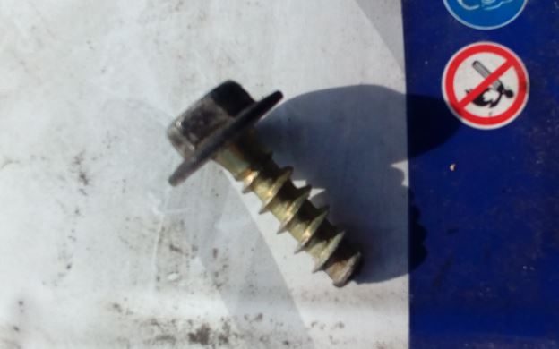

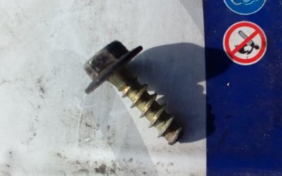

Bugger bugger bugger, that's the wrong grommets and the ones I need are mouided into the bracket.
Can't find an alternative vendor for the MAF bolts (or screws, as Citroen call them) either.
The escapee in question that's fitted to my car. Certainly different to no73.
MikeT's C5r 1.6 hdi Estate

You can get the bracket on ebay for less than the ex-vat Cit price
Citroen use 'screw' for all sorts of things, and the pictures at the top aren't always right... 74 is the MAF bolt which is described as "(MUL) CBLX SCREW 6-40". No idea what MUL or CBLX stand for! Should be able to get one from a scrappers? Annoys me when they put these things in multiples - at least if it was 3 you could understand! I bought a crank shaft pulley bolt for mine - only available in 2s FFS!!

RichardW wrote: 18 Jul 2017, 08:16 You can get the bracket on ebay for less than the ex-vat Cit price
Yeah, I bit the bullet and bought the bracket yesterday, as you say, cheaper on ebay. I'm really hoping I can remove the grommets and fit them to my bracket as I've read it's a bit of a nuisance for access as it holds part of the EGR/cooling pipework.
I'll be calling our local scrapyard later but I don't hold much hope. They don't keep their cars very long and last time I went, they didn't know if they had what we wanted (low-value item) and invited us to pay a £2 admission to hunt it ourselves.
no74 is a round headed fine thread screw that looks too thin (he showed me a similar shorter screw he had) and nothing like the ones fitted to my car (see pic above), making me doubtful. If anything, n075 looks more like the correct thread.

Having just seen a pug 1.6hdi with the same hex bolt heads on the MAF as mine, I'm going back to Citroen and will take off one of my two remaining bolts and tell him to check his database again to match mine. Perhaps they sell these types in a bag of three, saving me a few quid.
Bracket arrived this morning and I'm pleased to see the grommets are not moulded and easily removed.
Curiousity killed the cat, but not me (yet).
MUL = Multiuse
CBLX = cylindrique bombee large a six lobes internes AKA Torx (or HEXALOBULAR SOCKET BUTTON HEAD)

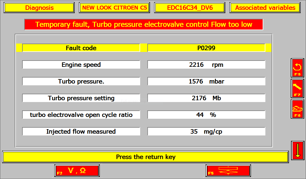

This was a new one on me - From overnight cold, got a few miles down the road and "beep!" Risk of Particle Filter Blockage pops up on the centre screen and the SERVICE light illuminates.
At that very junction I was turning onto a NSL road so charged up to 70mph for the few short miles it alllowed but SERVICE light stayed lit. A few miles I pulled into a layby as I had the diagbox with me.
In the Injection ECU, some new faults were listed
TEMP FAULTS 2x referring to flowmeter and one the turbo.
PERM FAULT referring to DPF.
As I'd recently removed the MAF I checked this first and noticed that it's connector could have been more fully inserted (though there was barely a gap to slide a rizla paper through, it really was a miniscule difference). Without checking further I presumed this was stopping a successful regen so noted the faults, cleared them, brought up the DPF live parameters and went on my way albeit a bit more revvy than usual. Sure enough, the exhaust temperature got really hot and after a few miles the soot loading changed from 45% to 0% and the miles since last regen reset to zero also. SERVICE is no longer lit.
Before I go and check if any of the faults have returned etc, I'm a bit unsure about the turbo temporary fault as it states "Turbo pressure electrovalve control Flow too slow". I'm hoping it's just a symptom of the MAF fault but unable to see the logic behind it. Here's the captured data at the time.

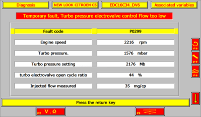

When I hear of all this I thank my lucky stars I drive a 1.9TD which is so happily devoid of all this troublesome technology
