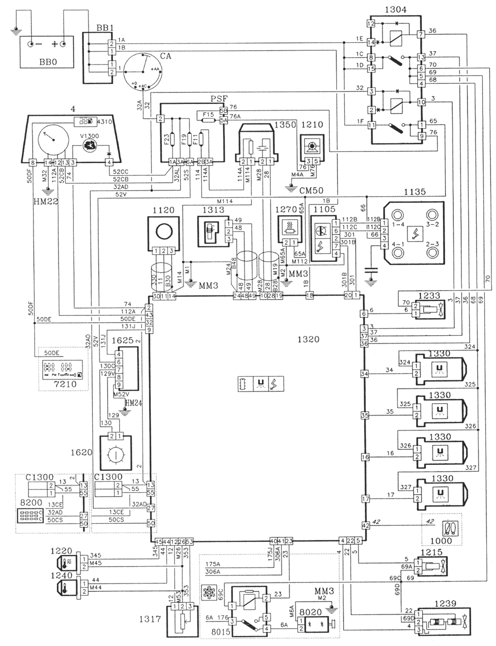

About injection.... I can assume from this diagram of Bosch MP3.2 that the injectors (marked 1330) are fired all at the same time (they are all connected to the same "wires")... Correct me if I'm wrong.

Not necessarily. While they are all connected to line 68 (on their pin 1 lines), they are individually connected to 34, 35, 16 and 17 (via their pin 2 lines), so they could be managed individually, or in groups. What is item 1320?

So the injectors are connected individually to the injector control unit. This means that they could be triggered separately. Does the engine use common rail technology, do you know? The HDi diesel engine does.

Its a petrol engine James, so it will be a standard common rail petrol injection system.
1320 is the engine ECU - which has built in injector drivers. Its fairly universal on petrol engines for the positive of all the injectors to be tied together and supplied through a relay and the negatives to be ground side switched by transistors in the ECU.
Interesting that all four injectors are individually wired to the ECU - that means that the MP 3.2 ECU might be capable of fully sequential injection (it could have four separate injector drivers) but that doesn't necessarily mean that it is - they could still be wired in pairs internally driven by two driver transistors, or even if it has four drivers if there is no cam sensor on this particular engine it must still fire them in pairs or as a group. (The MP3.2 is used on many different engines, some of which may have cam sensors, so depending on specific programming it may be able to work either sequentially or pair fired)
My money is still on pair fired - rather than guessing I suggest Xantos tries the test light test I described above which should answer the question conclusively.

I've just done testing the injectors. Looks like they are batch fired.
Connected the probe lamp to injector 1 and positive to battery to determine, which one is ground. It pulsated on one pin (let's say pin 1). Then connected probe lamp to pin1/injector1 and pin1/injector2(3 and 4). No pulse on all of the injectors. They are all pulsating if pin1/injector1 and pin2/injector2(3 and 4).

Yep, they must be batch fired then! At least you know for sure now.
Problem is your LPG kit offered fully sequential or pair fired as its choices, does it even support batch fired systems ?
Edit: Just to double check, you left the injectors plugged in while doing your test light probing, right ? If not the test would not have been valid.
