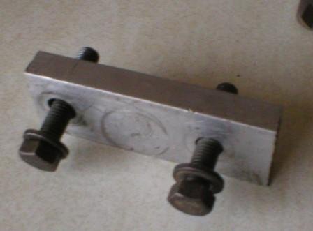

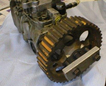

CitroJim wrote: 21 Feb 2023, 16:25 The pump sprocket puller..
And in use...
Ah, that'll be what's unhelpful described in Haynes "tool tip" make a puller like shown - then a chuffing useless photo rather rather something with dimensions on it!!!

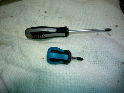

CitroJim wrote: 23 Feb 2023, 17:05
All I can recall with clarity is lots of crosshead screws needing a really good impact driver to undo them cleanly...
That's because the cross head 'philips' isn't a philips, it's JIS (Japanese Industrial Standard). Many a young lad has trashed the engine casing screws on bikes, me included, thinking they were made of monkey metal, nope, just a different shape. The JIS screwdriver doesn't cam out and works very well on philips.
I've got these now, the longer one is an impact driver that turns the tip 12 degrees, Vessel, pricey but superb.

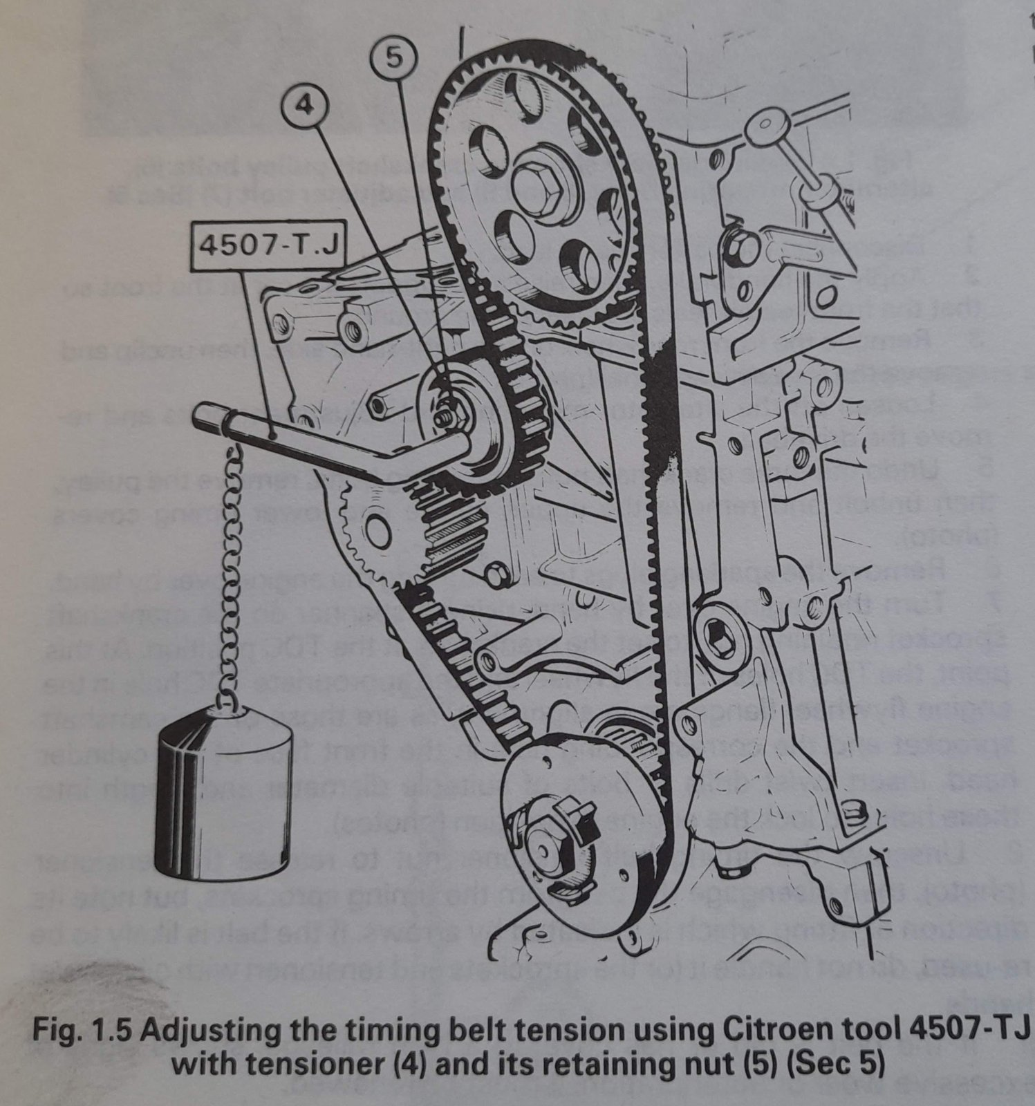

This is back when Haynes were still good... A picture of the official belt tensioning tool for the early TU engine...
(c) Haynes and PSA
(c) Haynes and PSA
Section 5 gives the salient detail needed to make one.
