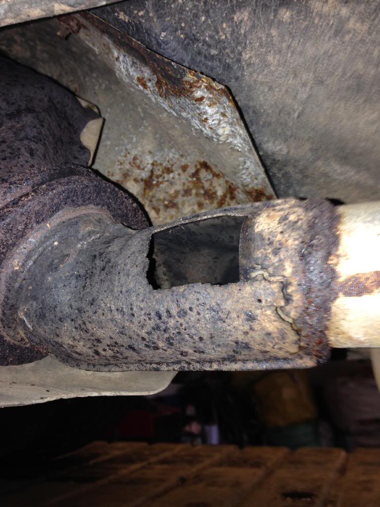

When testing the car up the road before I took it for an MOT, an enormous hole blew out of the exhaust just after the cat on the right bank of cylinders, it sounded absolutely awful so the first job was to change the exhaust, luckily I had bought a good exhaust which I always intended to put on, so I took it to my mechanic mate who fitted it for me, took us about 2 1/2 hours though, it was a right swine!
Here's the hole in the exhaust:
And here's some weird writing on the catalyst core:
According to a mate who works for an exhaust engineering firm, the writing on the core is how the manufacturer identifies the substrate before it has been put in a cat 'housing'.

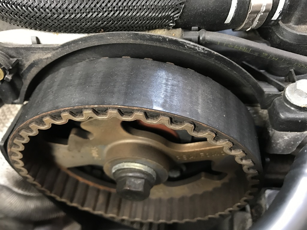

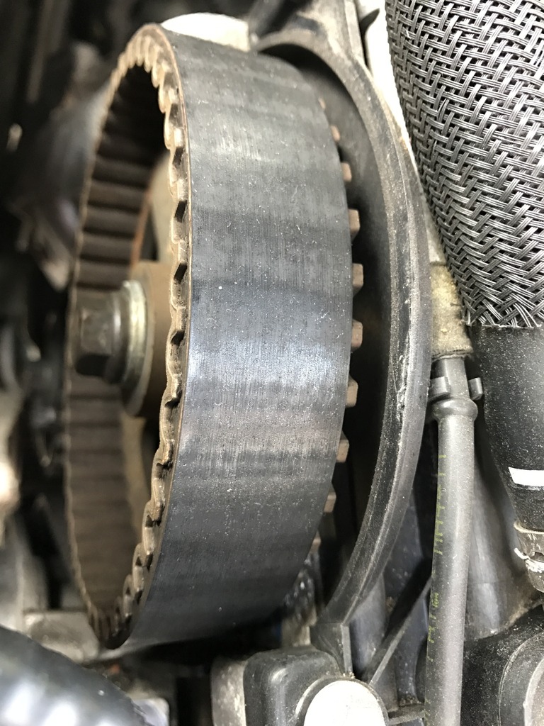

This weekends job was to finally get around to changing the cam belt on the C5, good job we did based on the look of the belt:
We can't believe how easy this engine bay seems to be to work on, certainly much more friendly than the Turbo D Xantia was.

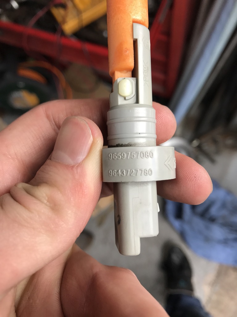

One thing we did notice is that the windscreen washer bottle absolutely stunk, and the car always thought that the bottle was empty, so we thought it would be a good time to investigate. I found the bottle full of fungusy type lumps, absolutely disgusting, took bleach sitting in it for an hour to soften it all up and get it out, gross! The fluid level sensor is an odd looking thing:
It sits horizontally, and when the water level goes above it the end floats up, changing the resistance of the sensor. We measured it's resistance when open and when closed, I can't remember which way round it was but in one position it was 0 ohms and in the other position it was 400 odd, we expected it to be either 0 ohms or open circuit, but apparently not. That's assuming this sensor works as I haven't been able to check it works yet - I'm hoping it was just gummed up with the fungus.

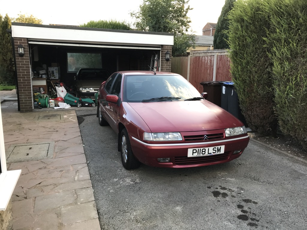

With the Activa, not much has been done just yet, I've bought a set of spheres for it and all the parts to do a general service to it, plugs, leads, filters, etc. It could do with a pair of strut tops as these two don't look fantastic - anyone have any good spares?? I took some photos of the car:
Can see Goldie in my garage here, also see the LHM spots on the floor from the VSX:

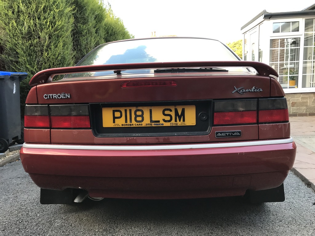

Rare Activa badge ;)
Can see the VSX relegated to the street so it can leak it's LHM over there instead of on the drive!

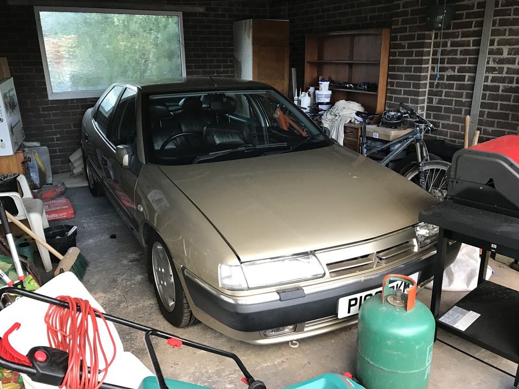

Goldie - battery disconnected hence bonnet open:

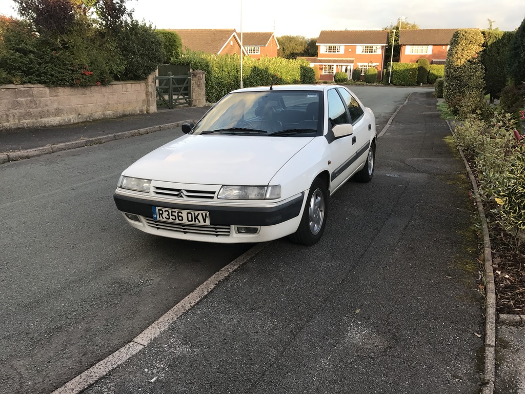

And finally the VSX, it has done me proud - bought for £486 off eBay back in 2010 - still going like a trooper despite it's leak
