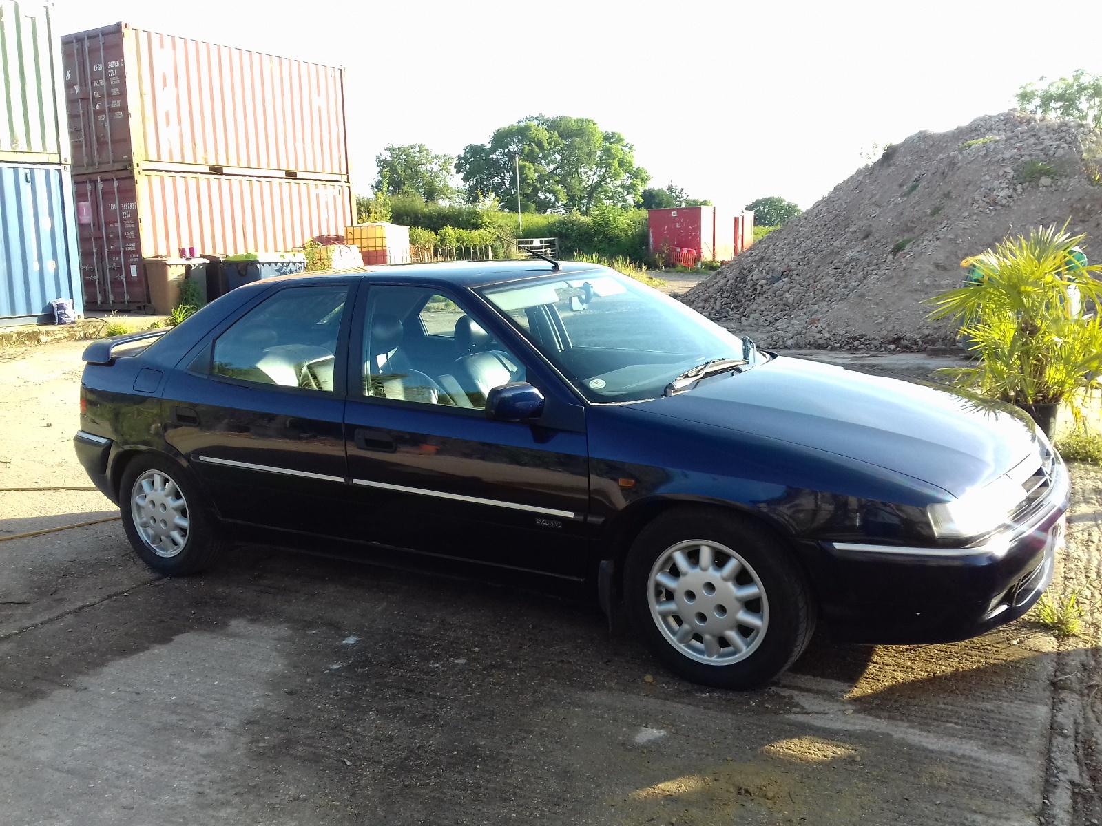

Feeling motivated now I have my stuff here.
Did a spot of cleaning, still a few panels to go.
Carpets back in next then not sure, something to do with heaters, leaks, brakes, steering, spheres or maybe spark plugs.

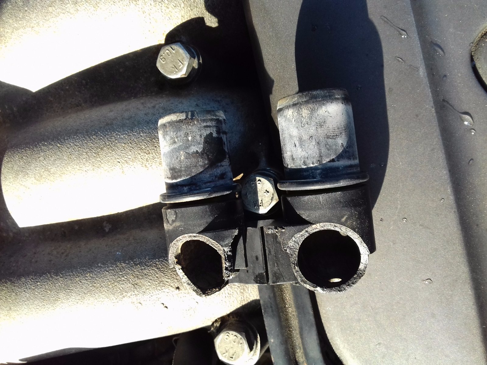

The cars decided what the next job is.
Finally the connector came off. The trick was to twist off the metal clip first. Once that was gone the connector came off with relative ease.
A quick search shows replacements still at £90-110. I will order a polish one I think and see if the bleeding valve will sit behind the Airton pipe. Not entirely sure it will but I think I can stomach plugging a bleed valve over spending £90 on a pair of elbows.

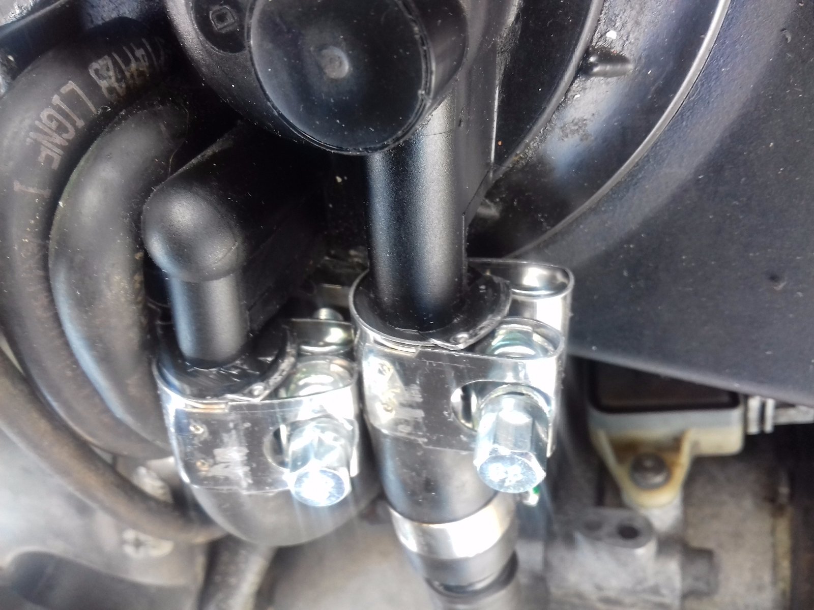

I'm prity happy. I saw the connector snapping the matrix pipes then I'd have a matrix to change too.
I had a good clean of the top of the lhm tank and a look for leaks. The big rubber seal was kind of loose and fiddling made it weep lhm so I tightened up the retaining spring which seemed to work. Squeezing hoses showed the two closest to me are not sealed. They will be repaired at lunch time. I have the new clips and Stanley knife out waiting.
Found an air filter amongst stuff that will be swapped at lunch time. It will be a good time to clean up leaks from below so I can track them down. I have brushes and degreaser now so I can do a much better job than I managed with contact cleaner in the past. I think I have 2 but it could be more.

Re: Elmas Xantia V6 and Musical Stuff
All done.
Not impressed with my stock hose clips, need thinner ones. Not sure if pipes are weeping or that's residual lhm getting squeezed out.
Started cleaning inside too. Dashboard and front doors are done. I'm halfway through the passenger seat now. Stopping here until after work.
