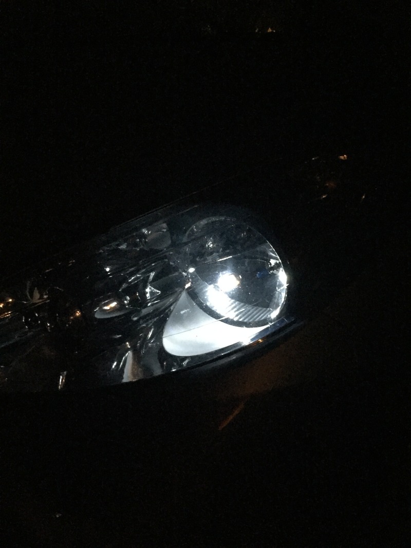

I just went out to get my wallet from the C6 and upon unlocking it I've found the first problem with using LED's in the sidelights. As soon as you wake the BSI up it must put a tiny current to the side light and DRL bulbs. With a normal filament bulb there's obviously not enough current to illuminate the bulb, however with LED's they illuminate quite well as soon as the car is unlocked...
Here's the sidelights illuminated just after unlocking...
Here's the sidelights illuminated with the sidelights switched on...
There's a massive difference between the light output between the two states though.
The DRL's also illuminate...
Cheryl mentioned she had a sidelight bulb out on her 207 when I was doing the LED's on the C6 so I fitted two to her car as well, the 207 does the same thing when you wake the BSI through unlocking the car. Again, these are taken with the sidelights switched off, just after unlocking the car.

The LED's I have put in my C5 do that.
I have had no long term drain to the battery.

Re: David Hallworth's Blog aka All Things V6!
It's just a small current passed through the bulbs that the BSI will use to test the bulbs have continuity and allow the BSI to detect blown bulbs while they are still "off", and not in use. As you've noticed, this won't be enough to illuminate a filament bulb but can dimly light LED's.
This is unlikely to cause any harm or draw any extra current compared to what the filament bulb would have, in fact if you were to measure it it would probably be a lot less.
The only potential problem is that if the current is a lot lower than the BSI expected of a filament bulb it might complain the bulbs are faulty. As long as it doesn't complain of a faulty bulb and you don't mind the dim glow I wouldn't worry about it.

Just been outside and checked mine, they do the same..........
