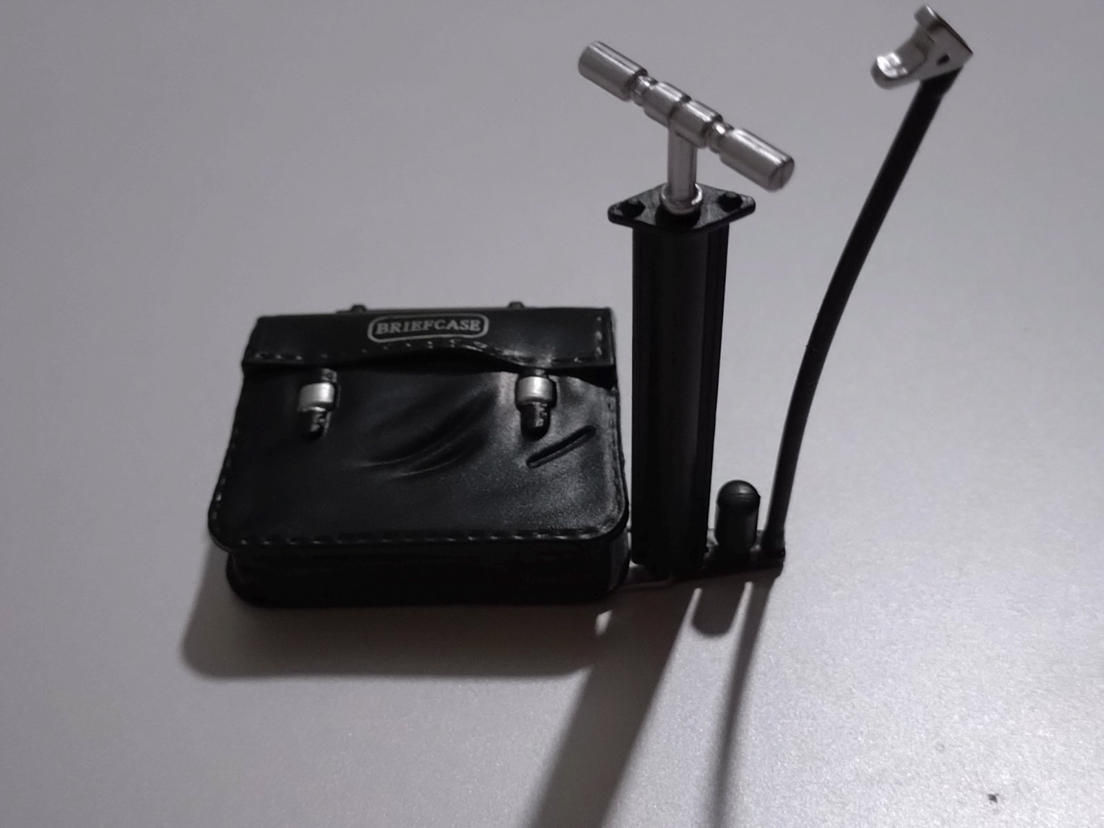

Do you think I should carry spare O rings in Bertie's saddle bag?
- Posts: 55178
- x 8440
Re: On your Bike
No, O rings rarely fail in track pumps Mick, just be very careful if Bertie runs tubeless tyres with Presta valves not to get any sealant in the pump head... Always park her with her valves pointing upwards to avoid sealant running out out of the valve when you open it to top the tyre up with air... Inflate with the valves pointing upwards too.

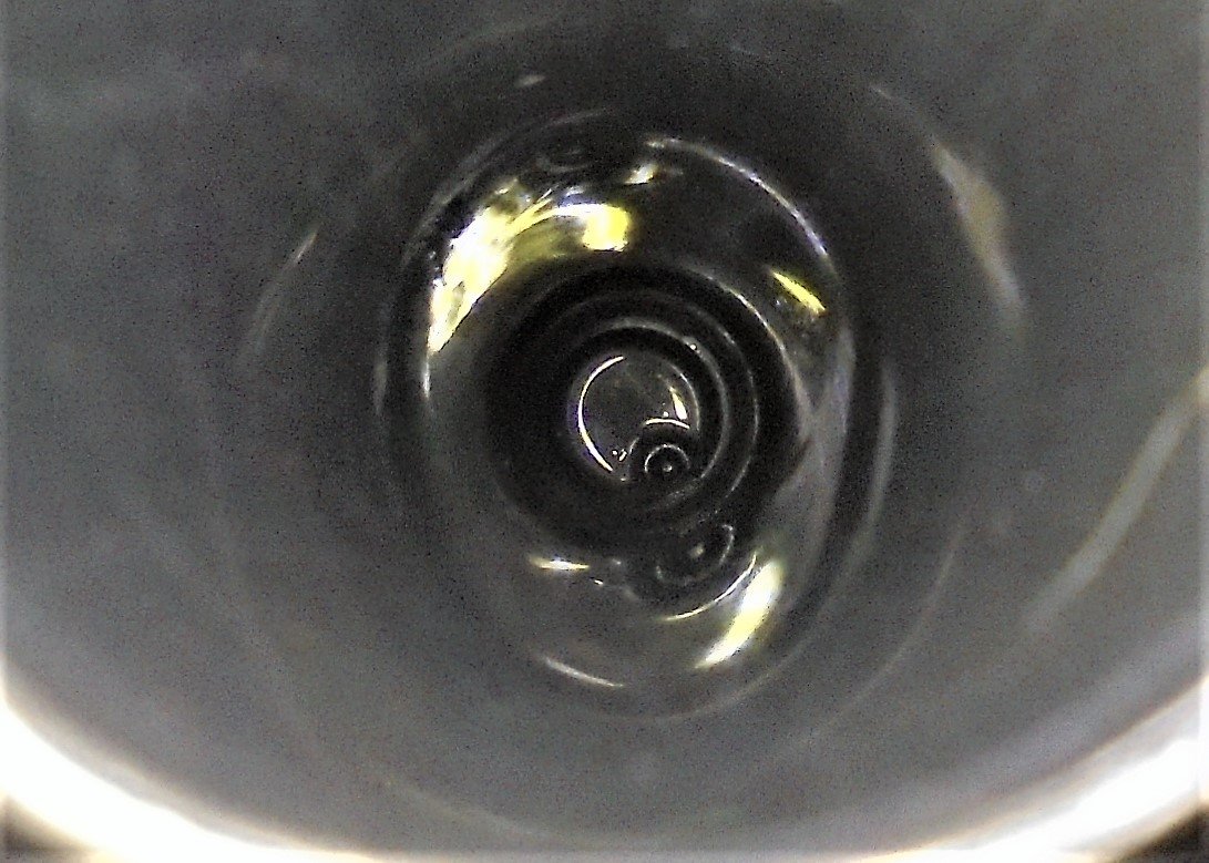

Dismantled all the tube work and took off the guage...leaving only the bottom rubber pipe in place where it exits the moulded plastic outlet at the bottom of the plunger tube. Poured neat fairy liquid down the plunger tube and the plunger pushed that through the bottom rubber pipe outlet. Filled the plunger tube up with boiling water and the plunger pushed with a decent force the boiling water 10 feet into the air.CitroJim wrote: 05 Aug 2024, 17:58 I could dismantle the head Neil and carefully clean it out... Mine's a fairly high-end one and made to be overhaul-friendly...
I'm sure yours will come all apart with a bit of care... Man made it so man can fix it![]()
Leads me to believe there is no blockage in any "valves", so the focus is back on the "O" ring, or rings needed to make the plunger effective moving just air as opposed to water. Not sure if it needs an "O"-ring at the top of the shaft as well as a thicker, better fitting one in the groove on the plunger.

A first for the thread. The best photo of the bottom of a track pump tube ever posted.
In other pumps that bottom end has associated O-rings and certainly looks like there should be one there, but I fear the moulded plastic bottom section is glued rather than screwed into the aluminium tube so access for investigation or replacement looks to be denied
- Posts: 55178
- x 8440
Re: On your Bike
Ahh yes, that'll be one of your non-return valves Neil... Without it working, whatever you pump into the tyre just leaks out again past that faulty valve.
