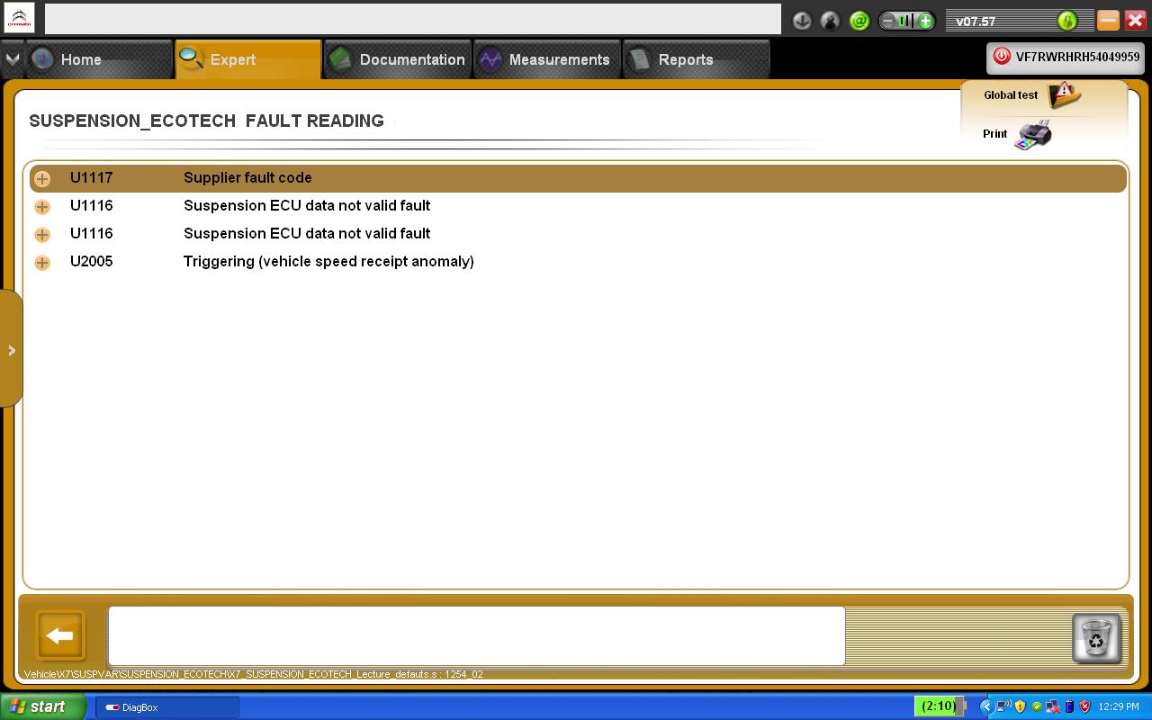

I have had another go connecting lexia and the fault codes are:
The U1116 codes would seem to make sense for the problem i have and the system needs reconfiguring but when i have selected that option it needs me to login into the citroen server to carry it out. I'm not sure if lexia is setup properly as the website info says that you can carry out nearly all the functions that a dealer does and carry out programming functions and adaption which is why i bought it.
Thanks again
x 6954
Re: Merged Lexia & Diagbox threads
I think you can ignore 2005 at present. The rest all indicate lack of data from the suspension ECU - probably as a result of lack of coherent data from the height corrector sensors.
At this point I really don't know what to suggest as these systems are very finely calibrated and integrated. There are some procedures like ECU downloading that only the dealership can do, requiring a technician ID and account (which is recorded in the BSI for traceability). If you can't access the relevant menu from within the BHI section of the Global Test, (only the 6 Cylinder C5 X7s have the CSS Suspension ECU) - 4 Cylinder X7s have this built into the BHI (Suspension Ecotech or similar) - then I think you are going to have to bite the bullet and get it flat-bedded to Citroen to sort out.
While there are lots of tests, diagnostics and procedures you can do, there are some you can't and these are the ones that will lock you out. With hindsight, easy to say, I know, but if we had known you were planning on removing these height sensors, yet alone swapping them, I would of advised against it. Not much help at this point I know Andy.

Thanks Marc, going to have to be citroen then :cry:
Is there any way i can get the suspension to drop manually as it's going to be awkward getting it off the drive?
x 6954
Please do come back and let us know the outcome Andy. I think anything else at this point would be guessing, as it could be the BHI itself, the CAN network not communicating or as we suspect the height sensors and ECU recalibrating from scratch on the 4 post lift. I hope it isn't too drastic for you [-o<
