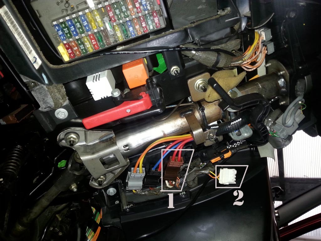

Plug 1....cut into this ?
Plug 2....what is this spare plug for ?....cruse control ?
What plug is it on this ............ BB10 ?

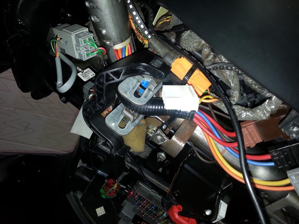

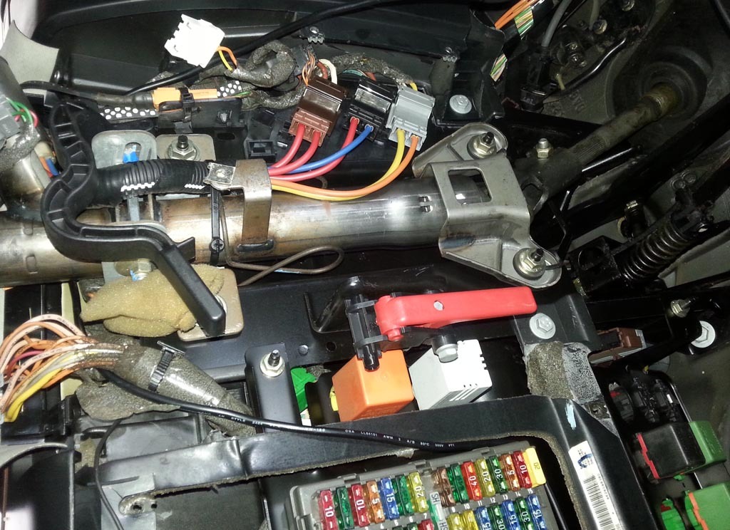

some more pics
some more pics

Looks strange ... everything being the 'wrong' way round as though you'd reversed the pic

That's the connector I mentioned. It's been a while and I couldn't recall what colour it was.

That is not the Cruise Control control plug (wrong colour and shape and not enough wires).Stickyfinger wrote: Plug 2....what is this spare plug for ?....cruse control ?
Is it not the instrument light dimming rheostat connector?
If your car has wiring for cruise control, there should be three wires going to the brake light switch (at least on the car side of the connector).

correct, rheostat for the dash lights.......I could not work it out on the photo.....dogh !
Will look for the three when I do the ignition mod next week.
