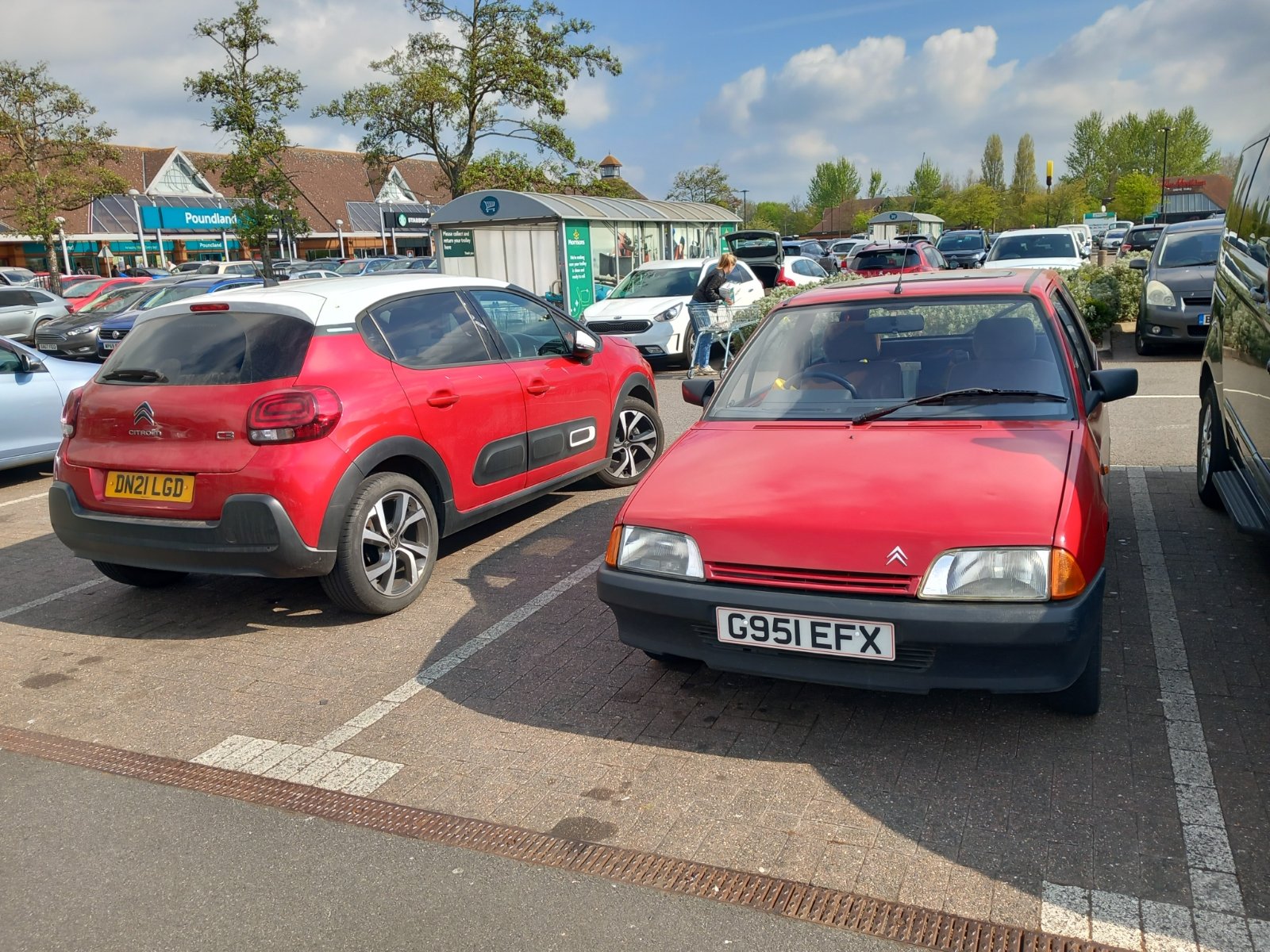

Little red Citroens two or three generations apart

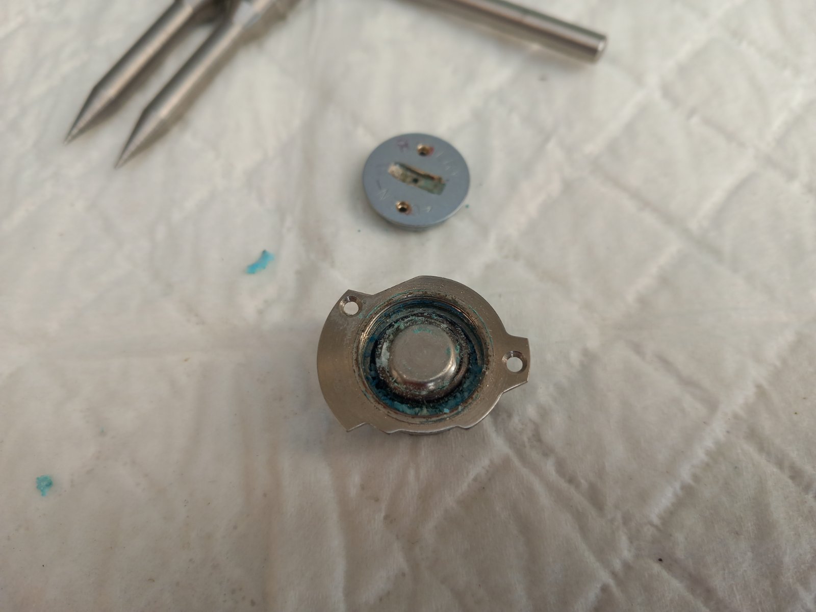

One had suffered a significant battery leak and in an effort to open the battery compartment with a coin the slot had become a bit damaged... This was mentioned in the ebay listing and ensured it sold only for pennies

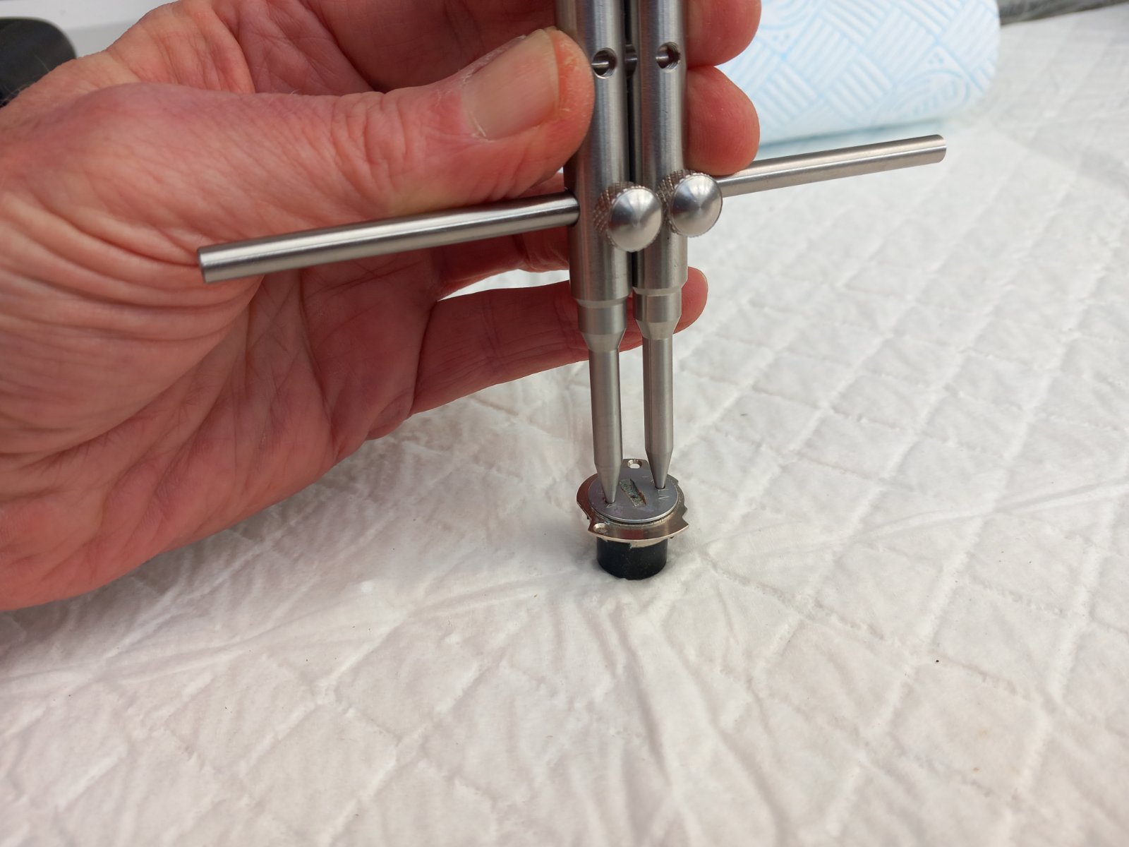

To open it up, I removed the battery compartment from the camera body and with it carefully clamped in a vice I drilled two small holes in the threaded cover to allow my lens tool to open it... That worked brilliantly

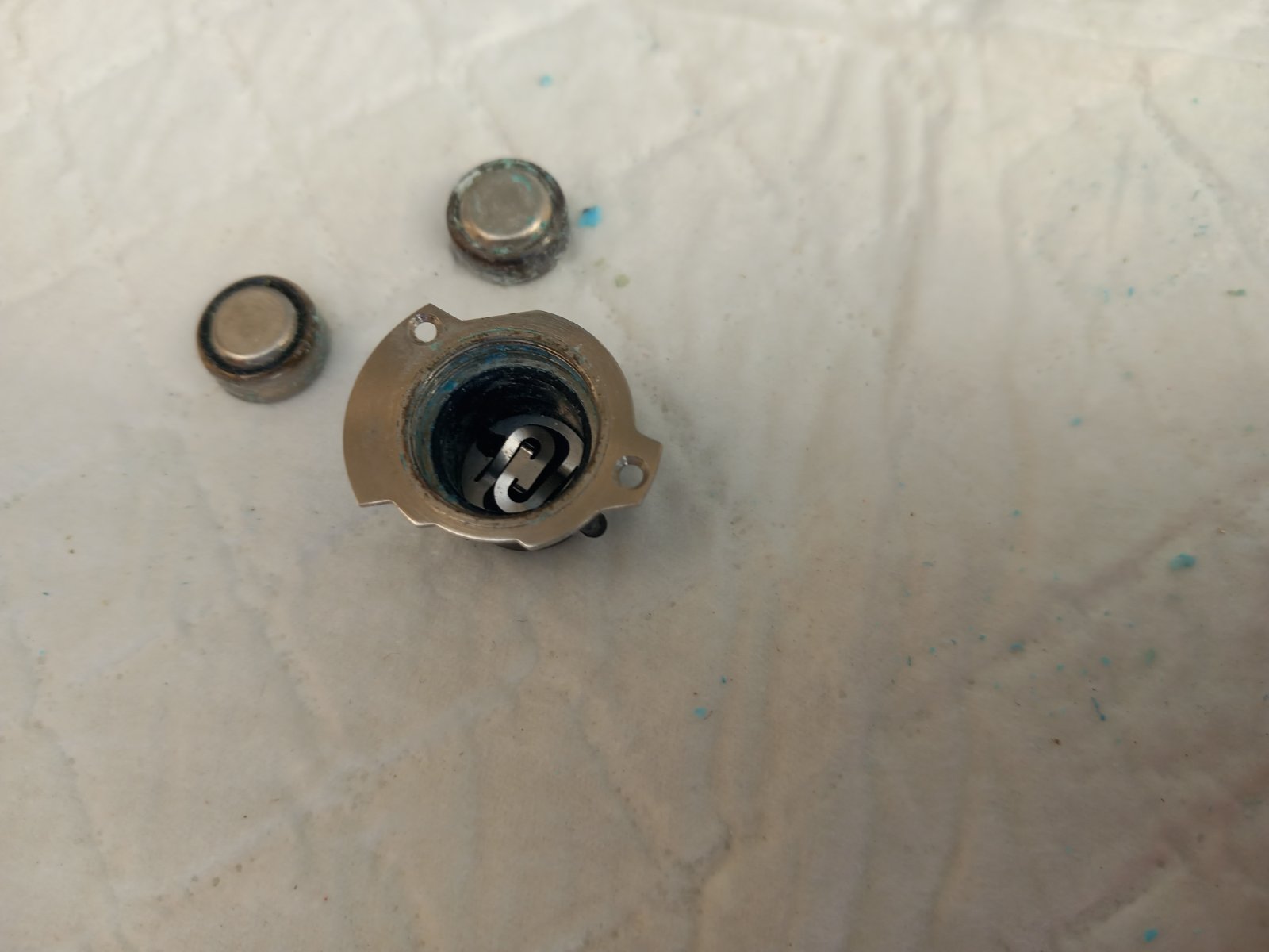

The batteries were a bit furry!
But happily, the positive contact was almost unscathed
A good clean-up, the removal of a little bit of non-critical corrosion on the camera body itself and a bit of general maintenance and I now have another good, working camera
