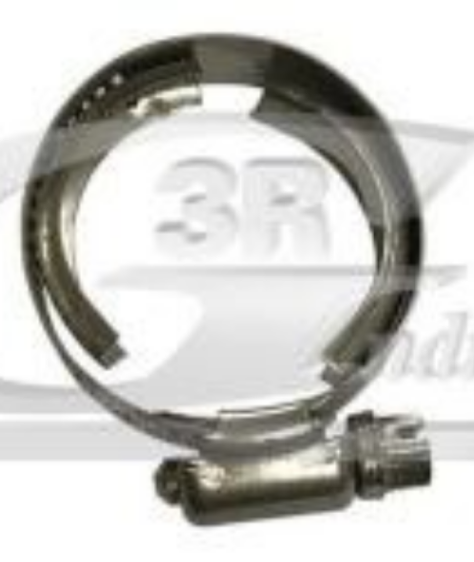

Ah, good to see one removed. It's a fixing a bit like an EGR pipework clamp holds them in place, isn't it?
If it's same diameter as EGR pipe clamp, I'd be tempted to us the BMW EGR clamp (basically a modified jubilee clip) - Autodoc lists them cheaper too, link coming up in a mo:
https://m.autodoc.co.uk/3rg/15942179
EGR clip (jubilee type)
Currently £4.07 each, they've been about £3 each in the past I think

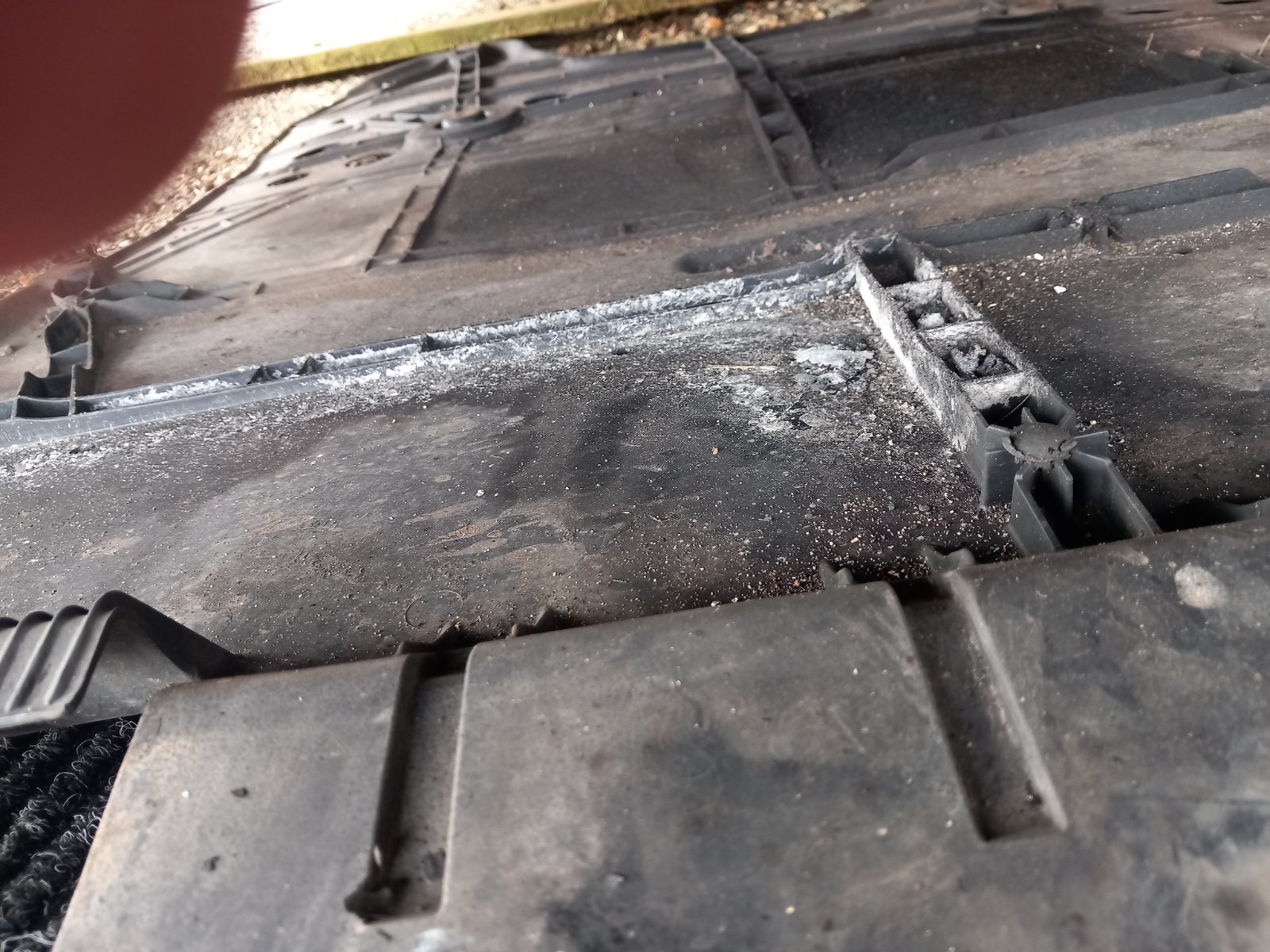

How much urea weeps out of the joint between injector and the DPF flange can be seen by looking at the under tray...

That could well be it Matt. I must admit, not enjoying particularly good health currently, I only went under to take the picture and did not get further involved... If it was mine, I'd have looked to have cleaned it up a bit.
The injector body does look to be stainless.
Zelandeth wrote: 08 Mar 2025, 11:35 Problem we used to have pretty much continually on buses back when I was still involved in that field was urea crystallising inside the injector orifice and blocking it up.
That happens a lot with those too Zel. Hence using the Wynns Crystal Clear additive to try to prevent it. The failed one in question was open-circuit.

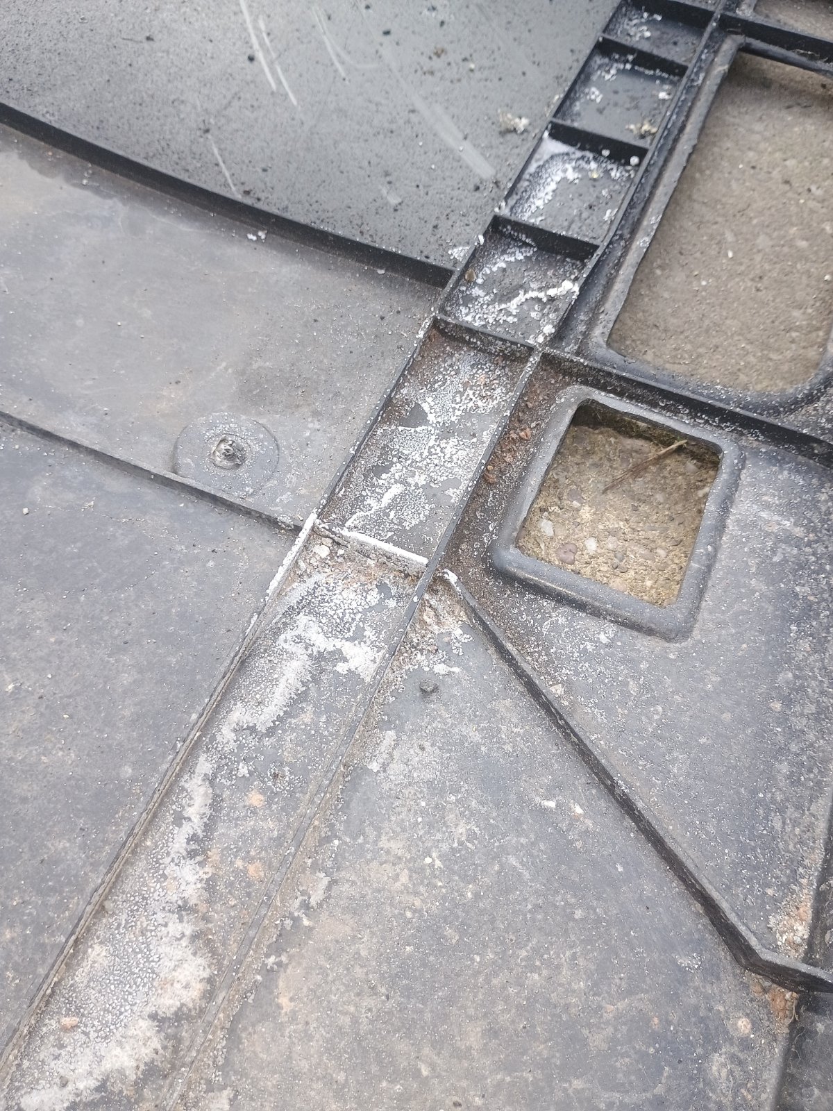

Interesting picture for you. You mentioned the undertray of the Picasso had AdBlue crystalline residue. Looks very much the same here though this is the grey 308 under tray which does not have adblue! So the dried out road salt which is what I guess this is can also look similar
Posts: 55182
x 8440
Ahh, I just assumed Matt as the major area of crystallisation was right under where the injector is... I must admit I've never seen it on my Picasso although I know the injector has wept a bit in the past. Stellantis saw it when they serviced the car and tried to tell me I had a big problem.
I'll look more closely next time... Maybe do a taste test as I know AdBlue is tasteless ;)
That's a lot of salt residue on your 308 :o

That is the result of the new "Salt Slurry" they are using on the roads as it concentrates in puddles more than the grit mixed types.....it splashes up and it pools and dries.................just think what is happening inside the box frame sections and between panel gaps !

Yes I too was surprised quite how much has accumulated there, I guess the drying effect of a nice hot engine and exhaust above makes an ideal evaporation table! Undertray today modified with a series of 5 mm holes in the hope each "chamber" in the webs of the tray can drain more easily. We well see!
I'm working my way up to this taste test method!
Stickyfinger wrote: 09 Mar 2025, 11:16 That is the result of the new "Salt Slurry" they are using on the roads as it concentrates in puddles more than the grit mixed types.....it splashes up and it pools and dries.................just think what is happening inside the box frame sections and between panel gaps !
Ah interesting, I'd not heard of that perhaps why I've not remembered seeing so much salt in the past. As you say, undertray dues mind it but it'll be causing havoc in other places no doubt! :?
