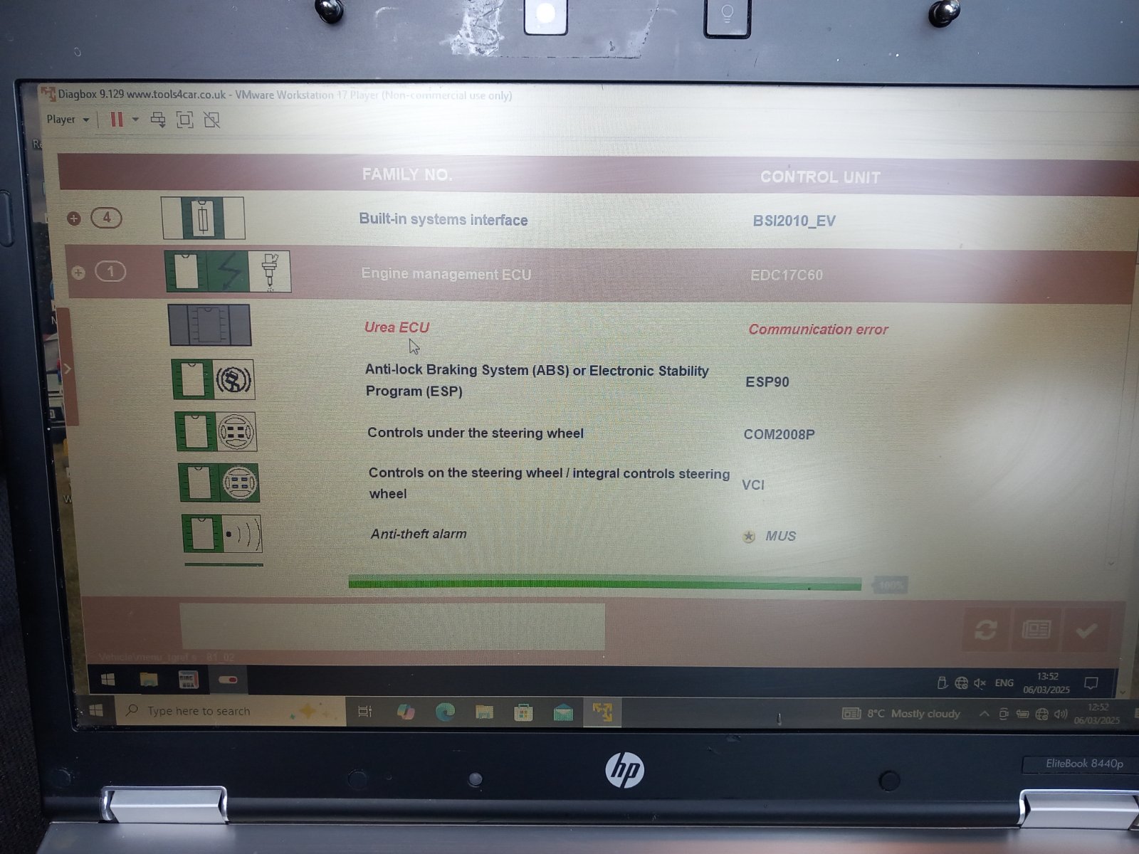

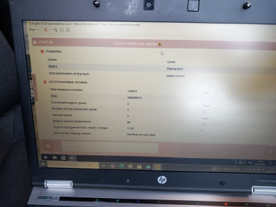

It's been an interesting morning doing a bit of diagnostic work on a C4 Picasso with an AdBlue issue and only having 100 miles left before it throws in the towel.
It belongs to a near neighbour who, amongst other things, fixes broken conservatories - we are in discussion about mine
Putting Dogbox on it was initially not very rewarding until I discovered this particular Picasso likes to identify as a Space Cadet
Then we were in business
It has a P2047 00 fault which points to the AdBlue injector...
Of a bit more concern was a failure to communicate with the Urea ECU...
Apologies for the picture quality - mobile phone shots of the laptop screen rather than proper screenshots...
The 2047 fault remains as a hard fault and the car still has only 100 miles left... I was hoping a token effort at clearing faults may have sorted that but no, sadly
Reading a very good post on this issue in this very forum:
viewtopic.php?t=81358
It seems the missing ECU may be a red herring and the problem is either the injector or the wiring to it. I still need to check F4 which I believe will pop if the injector is short-circuit.
An actuator test on the injector fails but all else on the system seems OK... Both owner and I hope it's just a manky connection to the injector or a duff injector.
The urea pump whirrs nicely as expected and all other bits of the system seem functional.
Stay tuned for the next episode

You need to re-set the De-nox system (possibly under engine ECU, and then repair functions) - this will reset the countdown. It will then re-appear quite quickly once it picks up the fault on the injector, but it should at least give another 700 miles.

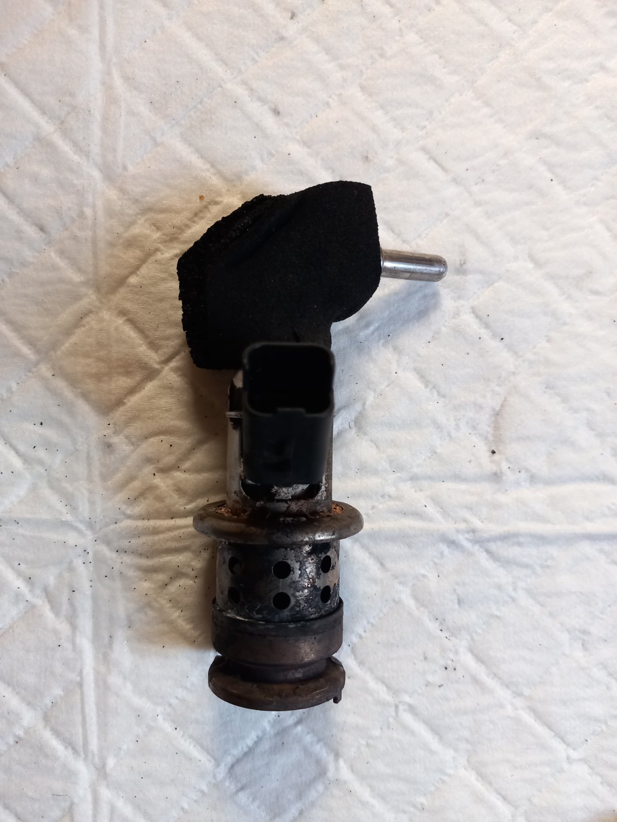

Meanwhile, we've had the injector out and it's testing open-circuit.
It was remarkably easy to get it out, the hardest bit was removing the undertray...
We need another. Autodoc do them but offer three OEM part numbers... Seems neither ECP or GSF do them and Trodo want a huge amount of the folding stuff..
Grateful if you could look up the part number. VIN is VF7**************[VIN obfuscated, can be read by forum staff] Thanks ever so
