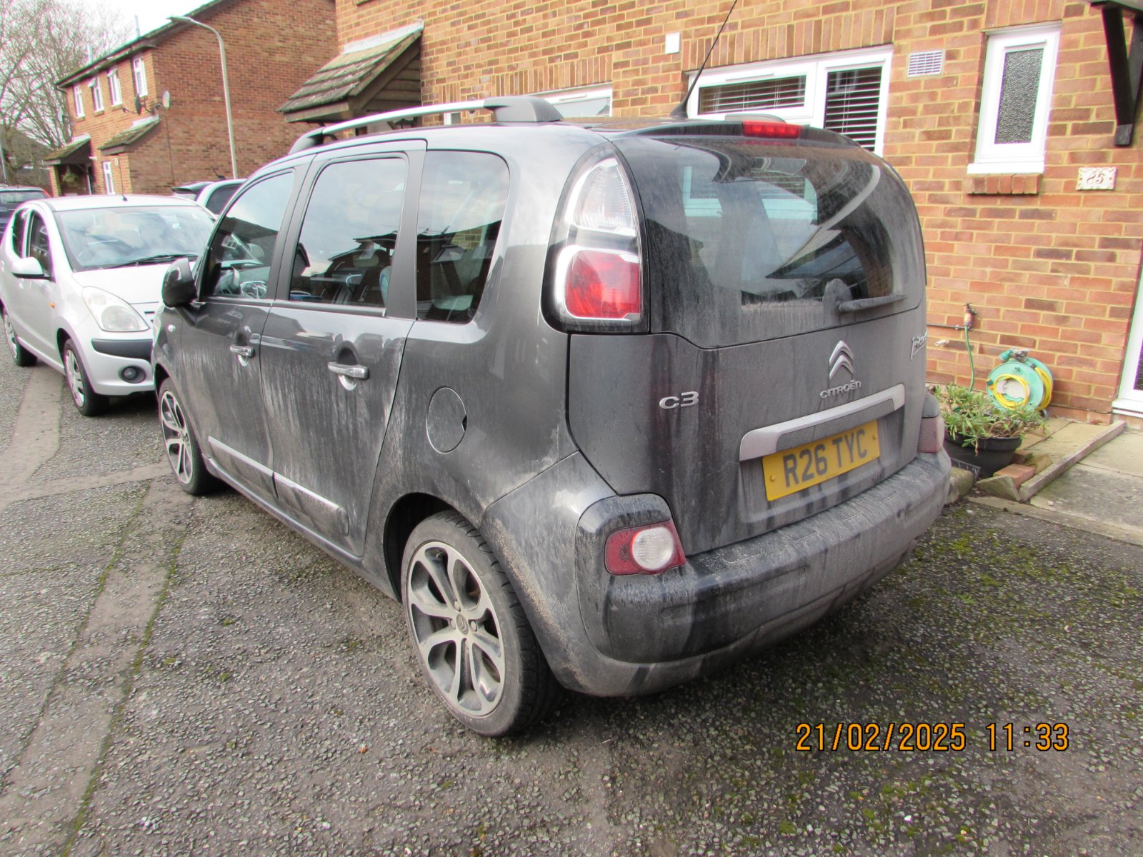

CitroJim wrote: 21 Feb 2025, 17:59
I see your Filthy and raise you a filthier beast
Skull’s HDi with some filthy beast

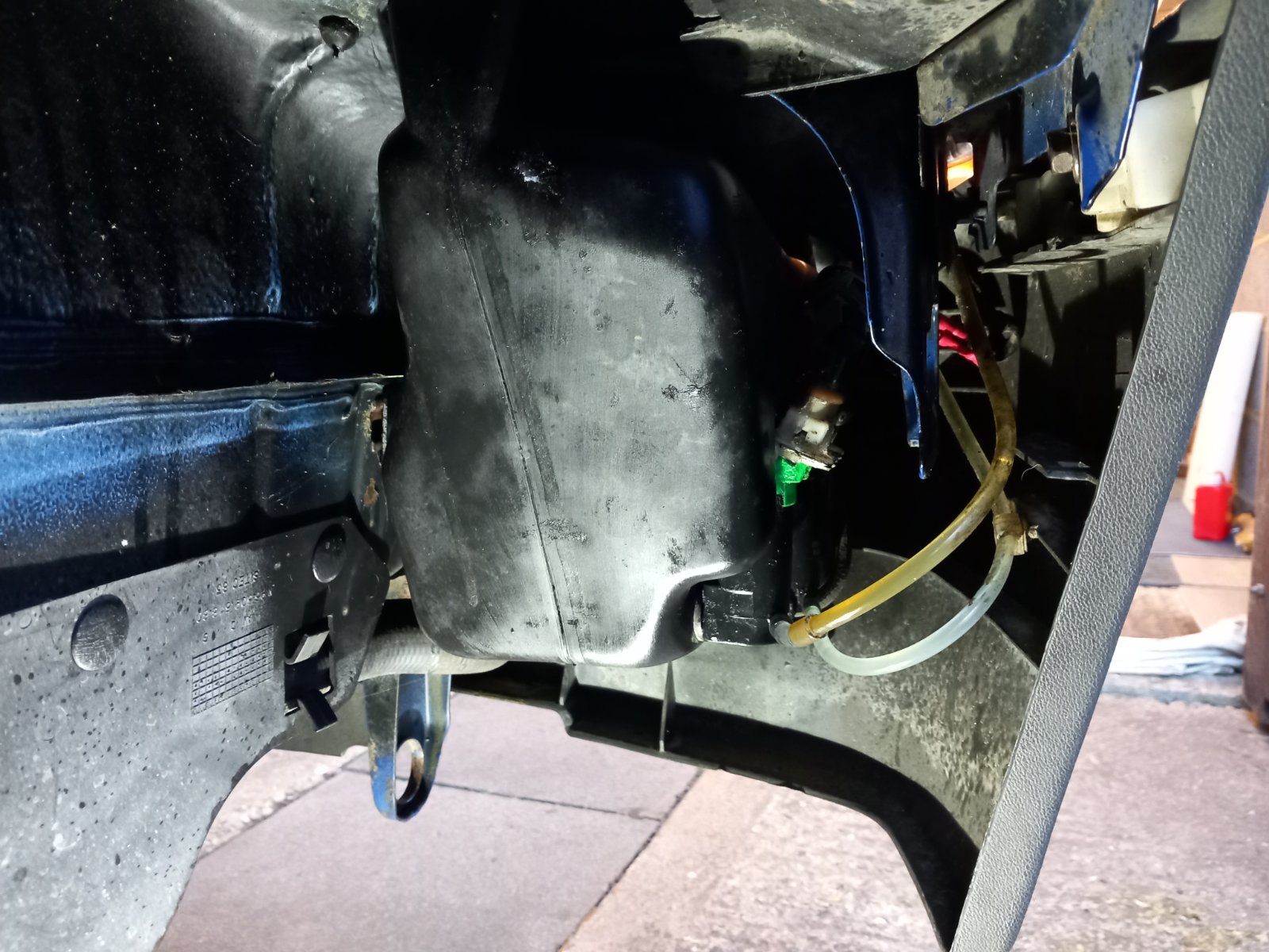

So, that left about 90 minutes to play cars... All went well :) Bumper back on, washer reservoir refitted, pumps reinstalled and tested...
The rear washer now works a treat :) Shame the front one has now decided to pack up :( Also a shame the plastic pipe to the rear is so hard it split invisibly where it fits onto the pump outlet port and caused a leak :twisted:

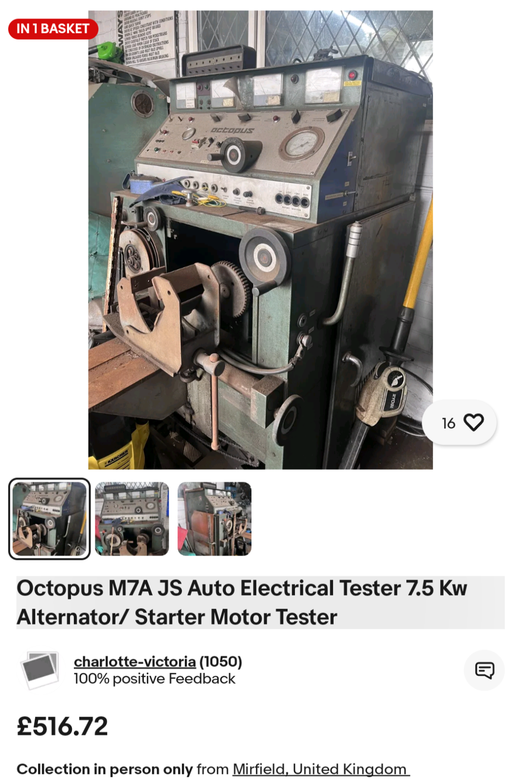

Good shout on checking at the alternator terminal. We "diagnosed" a dying alternator on my mates Audi A3 many years ago, removed said alternator and took it to a rebuild place. Bloke put it on his tester *** then handed it back to us "nowt wrong with that!"
Loose main earth terminal :oops:
Spoiler: show
on a car we'd recently had gearbox off...
*** What is the machine called, Sparkrite? Nope.
That's going to niggle till I remember.
Posts: 5364
Joined: 25 Apr 2022, 09:03
x 2367
Unread post by MattBLancs »
MattBLancs wrote: 23 Feb 2025, 08:38 *** What is the machine called, Sparkrite? Nope.
Nothing at all like Sparkrite! I remembered it was an unusual, strange name. Google and eBay to the rescue!
Spoiler: show
Octopus!
Octopus!
I remember the machine too, looked just like this one.
I've resisted the urge to gain testing capability via a trip over the Pennines to Mirfield! :D

On the positive side, I now have fully functioning front and rear washers :D Leak fixed with a bit of new pipe and the corroded contacts on the front pump cleaned, burnished and protected with silicone grease
