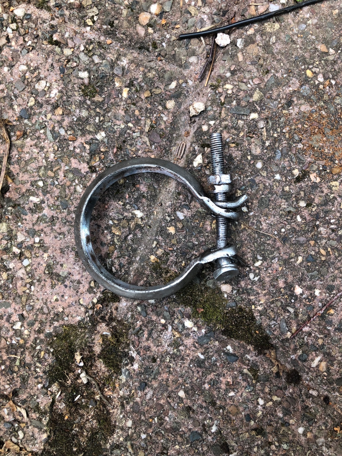

Oh, mustn’t forget. I think the old fool overtightened this clamp….
Just a bit. I made him struggle to get THAT off I can tell you….
