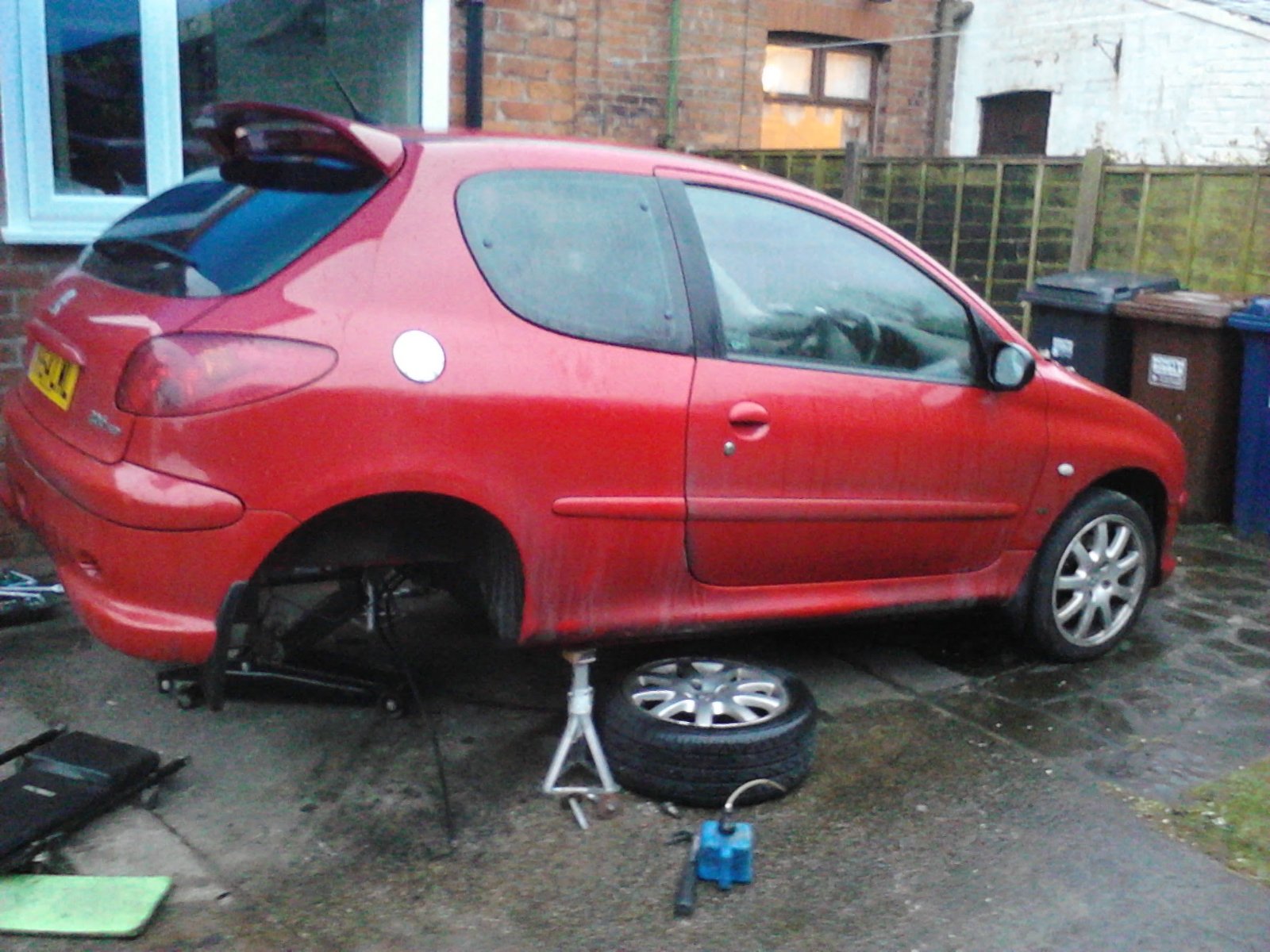

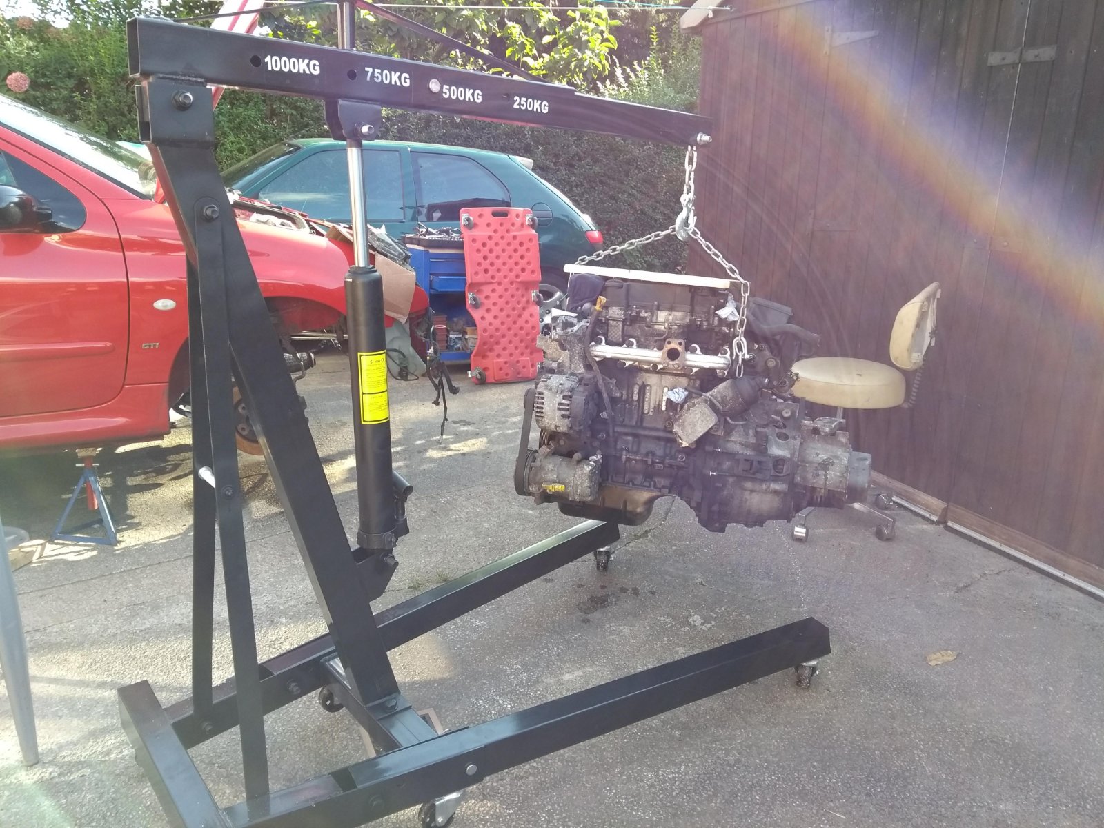

This was wet March and pretty grim:

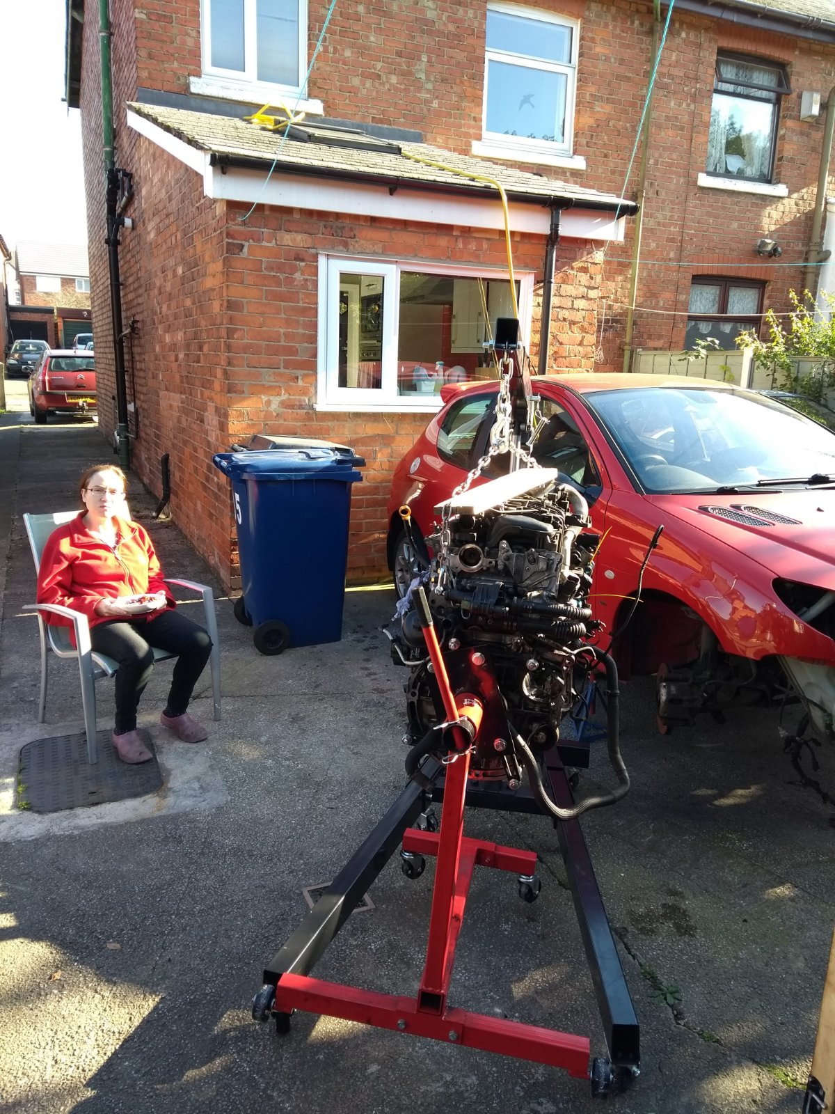

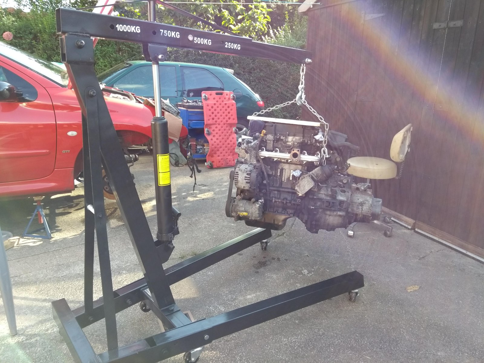

A few years later, playing with the other end, despite it being August, engine came out, onto a trolley and into the garage. Quite a few weekends that followed were very wet but didn't slow me down.
Stand about £40, hoist about £80, both eBay and the finest steel China's cheapest suppliers have to offer

Good effort - love that crawler I had to zoom in as I thought it was a diy job out of a couple of bread trays

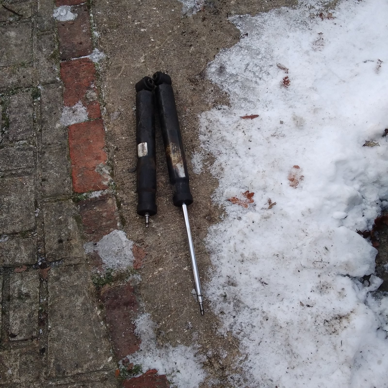

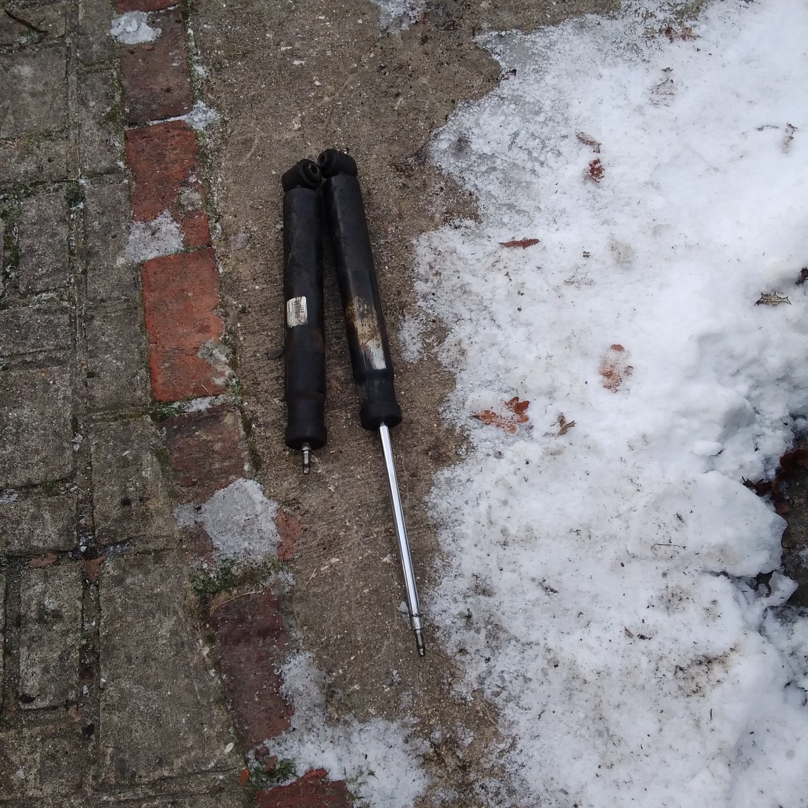

Oh yes the weather and when things happen to a car they will mainly when its rubbish weather , my rear shocks went on this little thing and had to be done... with a nice cushion of snow and a little ice. Was worth the struggle as it was my daily a while back , the difference was amazing it drove great after.
Husky.
