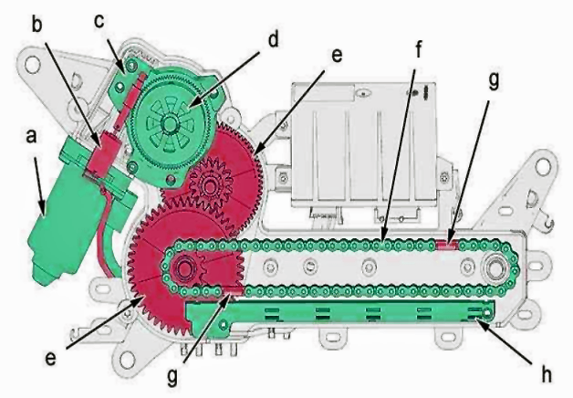

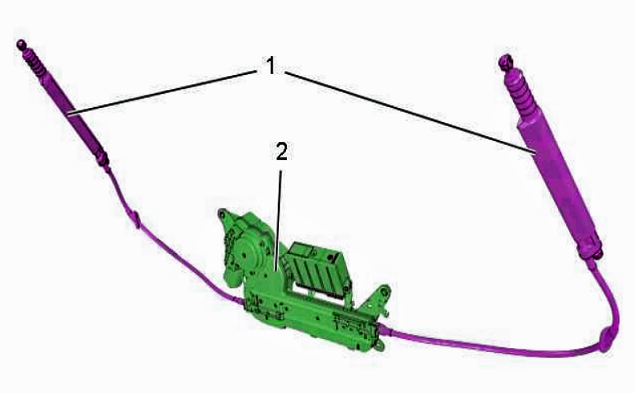

Sometimes a problem gets a lot of thought and then attempt at a resolution. And sometimes I look at a couple pictures and get the drill out...
Electric boot seems like high resistance sometimes stops mid travel as per my post here:
viewtopic.php?t=60312&start=15
Hypothesis: excessive resistance in drive system.
Interesting details on the inner workings here:
From viewtopic.php?p=592251#p592251GiveMeABreak wrote: 23 Nov 2018, 13:48 Here's some info in case it helps if some investigation is required:
(1) Motorised tailgate balancing struts.
(2) Motorised tailgate mechanism.
- The motorised tailgate mechanism performs the opening and closing of the motorised tailgate.
- The position and the speed of the assembly are measured by a linear potentiometer incorporated in the motorised tailgate mechanism.
Function
- The motor of the motorised tailgate mechanism "a" drives the gears "e" in rotation, depending of the direction of opening or closing of the motorised tailgate.
- The rotation of the gears "e" drives the movement of the chain "f".
- The fixings "g" of the motorised tailgate balancing strut cables are linked to the chain "f", driving the movement of the motorised tailgate balancing struts, making the tailgate open or close.
- The linear potentiometer "h" gives the position and the speed of the tailgate to the motorised tailgate ECU.
- The motorised tailgate mechanism can be clutched via the clutch "c" by action of the clutch motor "b" on the clutch spring "d", which locks or releases the central shaft of an epicycloïdal axle located under "d".
Specification of the linear potentiometer:Specification of the clutch motor:
- Voltage 5 V
- Information outputs: Position between 0,4 and 4,6 V (0,4 V = With the tailgate closed ; 4,6 V = With the tailgate open)
- Total resistance: 5 kohms
- Resistance between the information output and the earth of the potentiometer: between 30 Ohms and 4,9 kOhms approximately (Measure : connector disconnected
Operation voltage thresholds:
- Control: OCR
- Duration of voltage: Around 500 ms
- Less than 8 V - more than 16 V: The system is not operational, declutching is not possible
- Between 8 and 10,5 v: The system is not operational, only declutching is possible

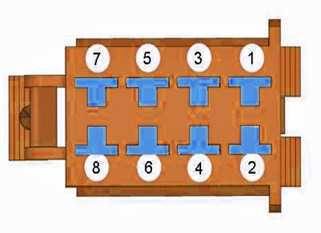

Here are the ECU connections - obviously part 'b' is the male connector of the female shown above in more detail.
Channel No & Designation
Tailgate Locking 16 Pin Connector 'a'1 - Electrical earth 2 - Lock information tailgate open 3 - Positive control : LH anti-pinch sensor 4 - Positive control : RH anti-pinch sensor 5 - Negative control : RH anti-pinch sensor 6 - Motorised striker plate control 7 - Boot closing switch lighting control 8 - Motorised tailgate opening control status 9 - Power earth 10 - Motorised striker information: gone in 11 - BODY CAN low 12 - BODY CAN high 13 - Control - LH anti-pinch sensor 14 - Tailgate opening exterior control signal 15 - ECU supply 16 - Power supply

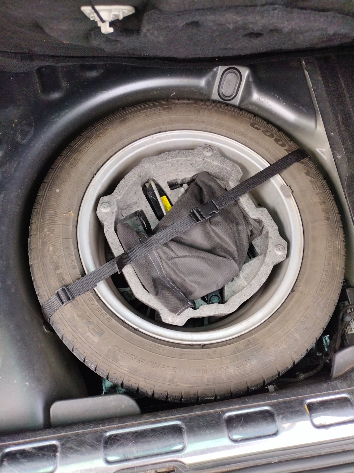

From here:GiveMeABreak wrote: 09 Apr 2023, 21:50 I think you're referring to this lot, which is also supposed to be included when new for your vehicle:
viewtopic.php?p=751689#p751689

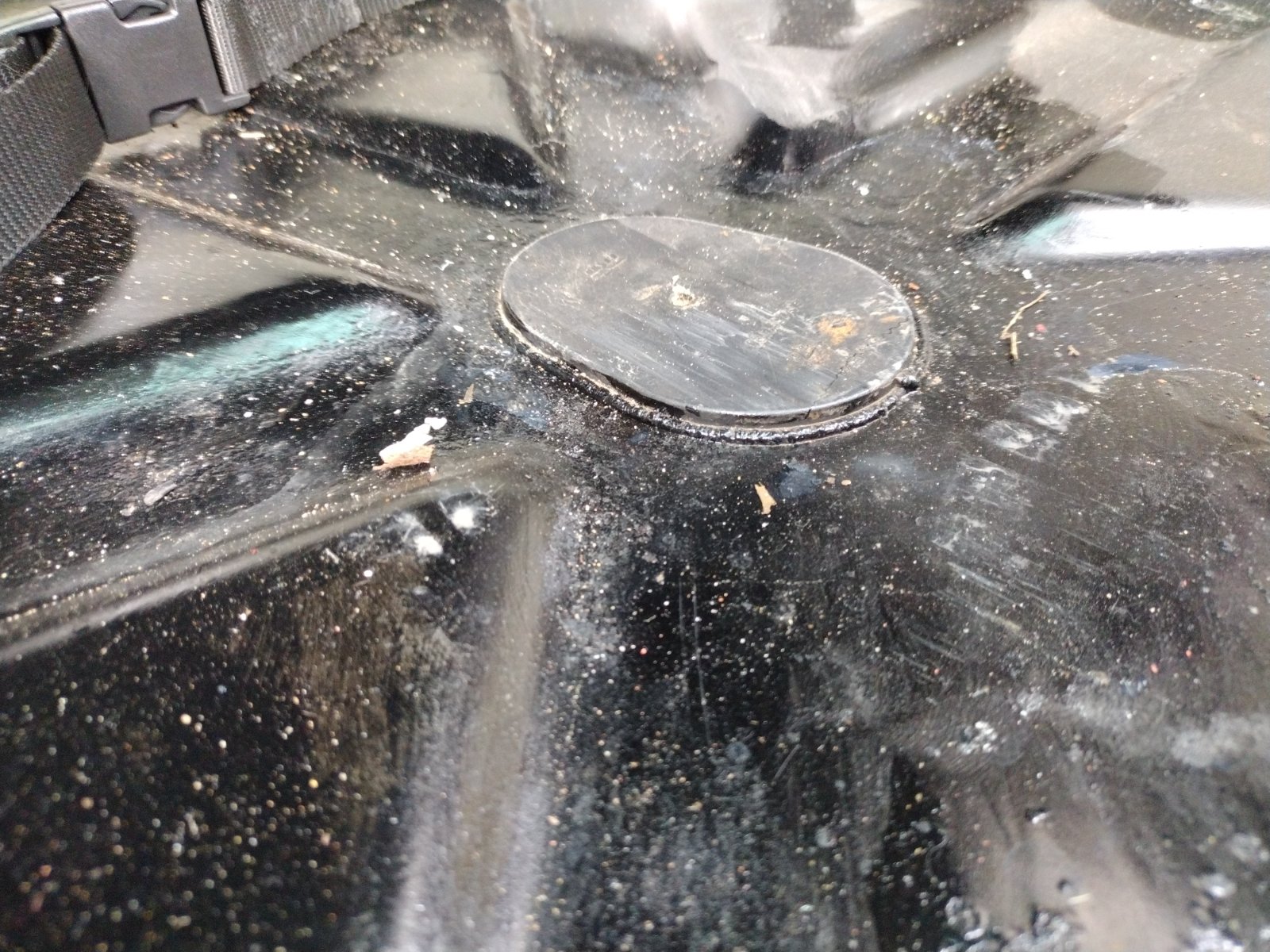

Time to sort it. EBay buckles and 25mm webbing: Better than nowt!
Polystyrene thing still not actually restrained as shallower than depth of wheel but at least the wheel itself cannot shuffle about so freely now

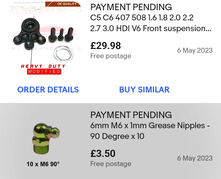

C5, a quick dig on catalogue ssg Asia site:
FRIP bearing: 3640.69
Video in discussion here: viewtopic.php?p=559987#p559987 chap mentions a protector "washer" being from a Peugeot 508, but the parts catalogue suggested "swivel protector" 3623.26 should be fitted to my C5.
No plentiful sources of them online (this is nearest I have found = https://peugeotcitroendsparts.com/peuge ... or-362326/ £2.57 each (Inc vat but think + delivery cost)
So decided to seek out some FRIP that come with this cover included, hence:

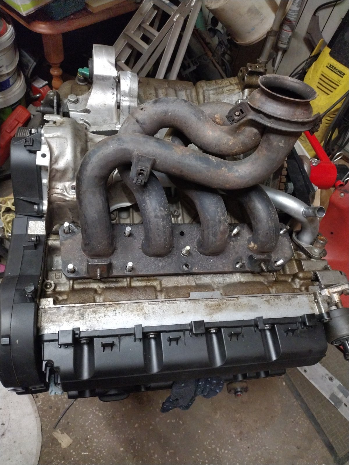

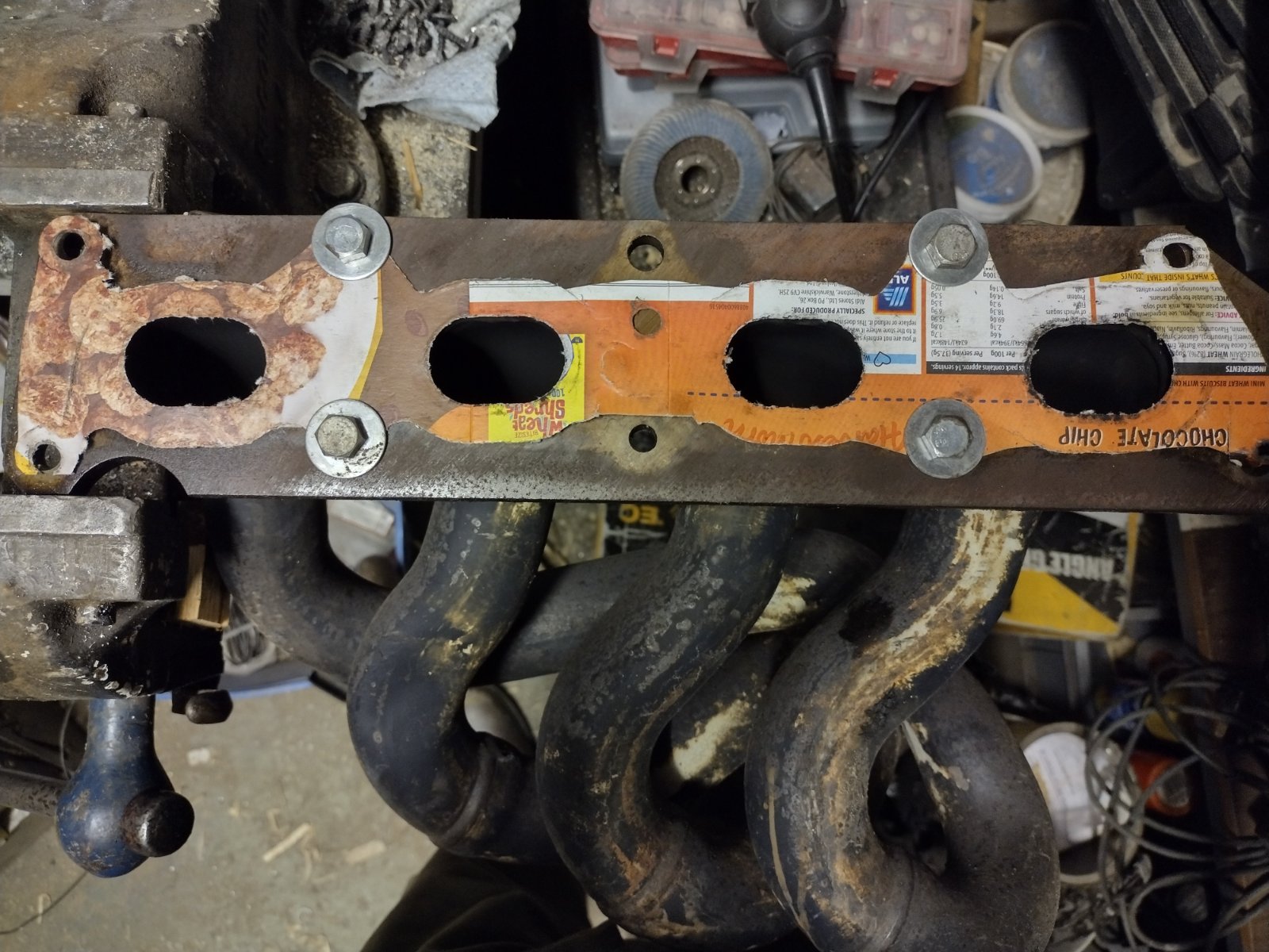

Back to 406 Coupe:
EW10A engine fitted with EW10J4S exhaust manifold: Note central stud of EW10A in place of two on the earlier engines. Hence cereal packet in the go again:
Interesting amount of difference between the EW10J4 and later EW10A, for example older engine (J4) lower rear engine mount carrier is cast aluminium and four bolts plus two location studs
Later (A) is much, much heavier cast steel item and only three bolts.
EW10A block has two normally unused threaded holes which the earlier mount can use as normal, but the newer engine's third bolt doesn't feature on the EW10J4 block! So old mount fits new block but new mount doesn't (fully) fit old block! Or put it differently, I now feel lucky not to be either making a new bracket or giving up on my cheap EW10A and finding a closer match / rebuild the current one.
Old bracket has the mount about 70mm closer to the centre line of the car, based on a quick comparative measure relative to the oil level sensor position
Incidentally old engine is clearly in near of a timing belt end crank oil seal, the whole timing setup is coated in oil top to bottom! Explains why generally but oily in engine bay at that end - done must be flung beyond the plastic belt cover/housing

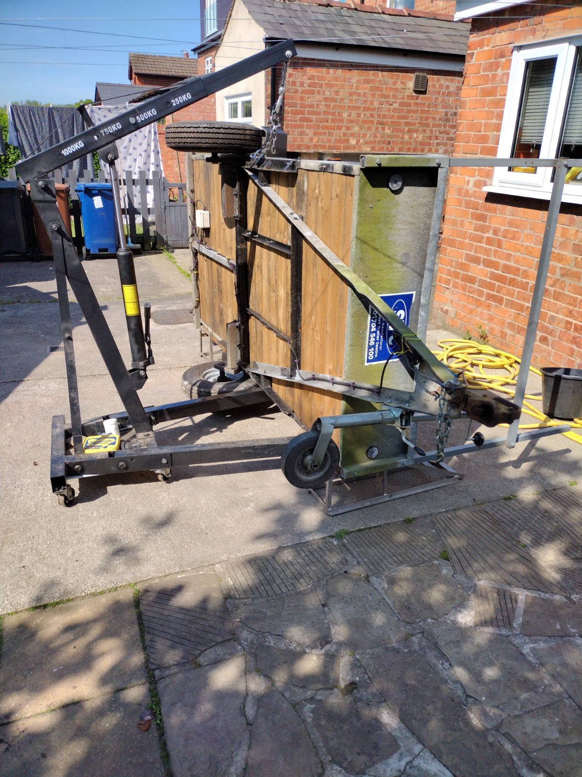

There's two ways to paint underside of a trailer, lie on your back and gets showered in the stuff, or...
- Spoiler: show
- Posts: 55061
- x 8386
I like it Matt
A nice bit of lateral thinking!

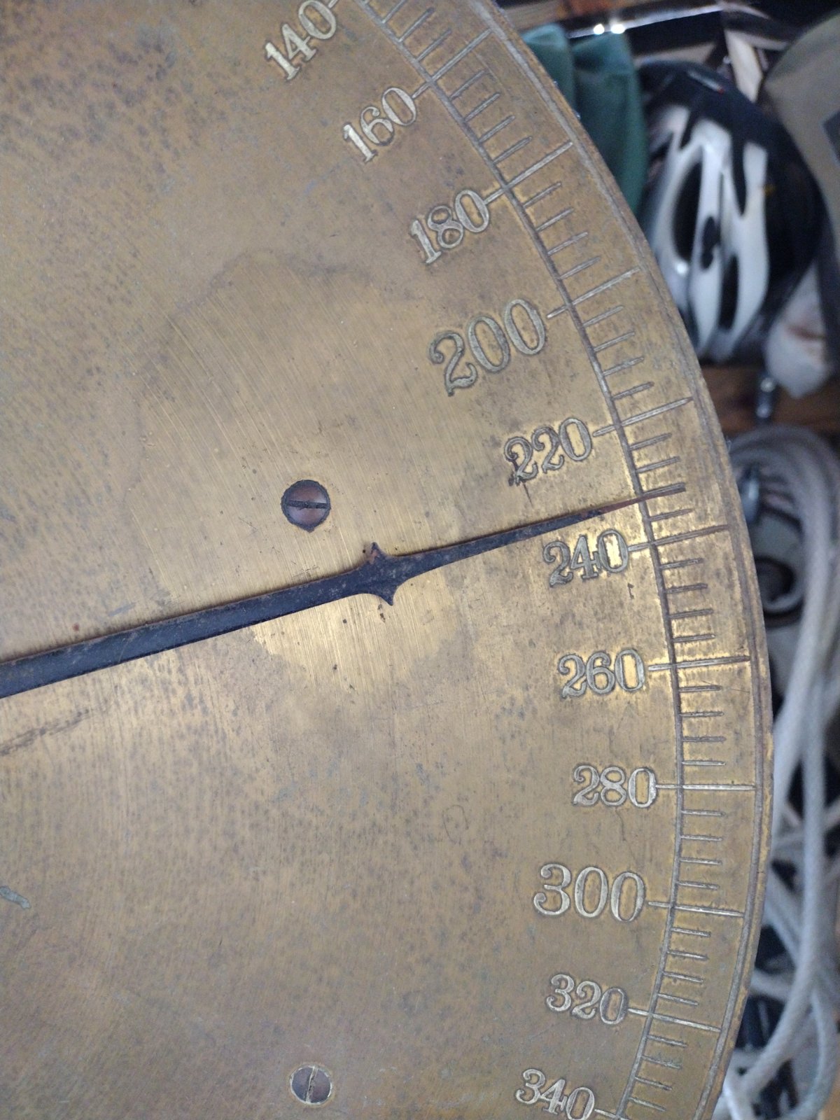

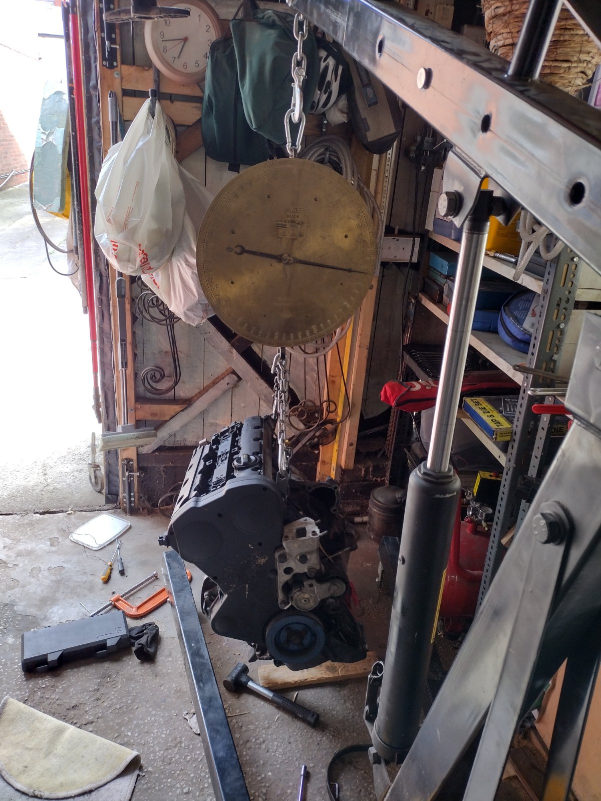

For future reference:
EW10J4 + BE4 gearbox,
Without: inlet manifold, exhaust manifold, starter, alternator (and associated heavy cast steel mounting bracket)
Weighed on a spring balance (last calibrated in January 1986!)
Weighed 312lb = 141.5kg
- Posts: 5308
- Joined: 25 Apr 2022, 09:03
- x 2341
EW10J4 without gearbox
232lb = 105.2 kg.
By subtraction BE4 = 36.3kg (or put another way, spring balance is not so far off!)
- Posts: 5308
- x 2341
BE4 weighed on its own: 80lb = 36.3kg, agrees with the maths too!
