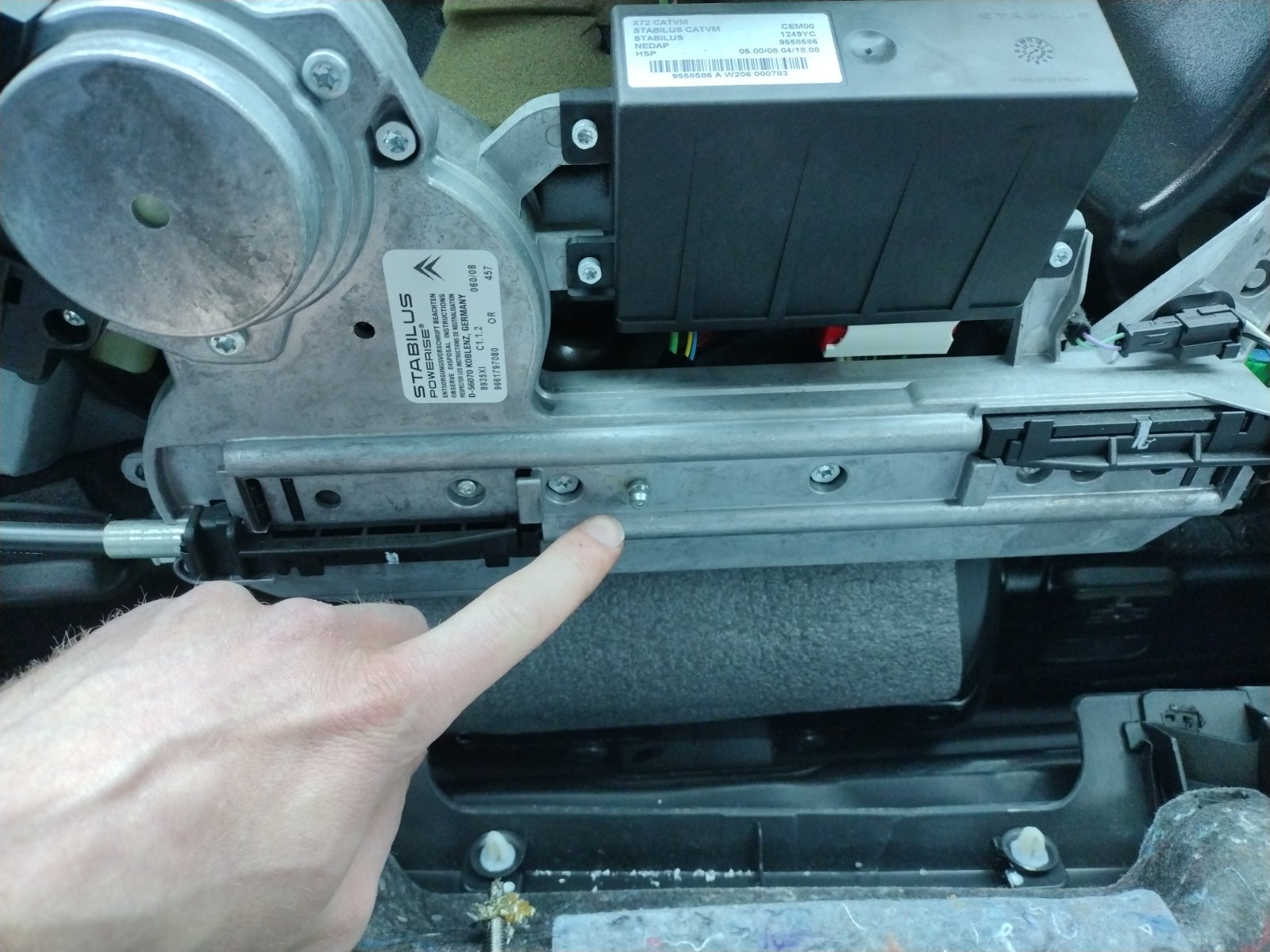

Sometimes a problem gets a lot of thought and then attempt at a resolution. And sometimes I look at a couple pictures and get the drill out...
Electric boot seems like high resistance sometimes stops mid travel as per my post here:
viewtopic.php?t=60312&start=15
Hypothesis: excessive resistance in drive system.
Interesting details on the inner workings here:
GiveMeABreak wrote: 23 Nov 2018, 13:48 Here's some info in case it helps if some investigation is required:
(1) Motorised tailgate balancing struts.
(2) Motorised tailgate mechanism.
  • The motorised tailgate mechanism performs the opening and closing of the motorised tailgate.
  • The position and the speed of the assembly are measured by a linear potentiometer incorporated in the motorised tailgate mechanism.
Function
  • The motor of the motorised tailgate mechanism "a" drives the gears "e" in rotation, depending of the direction of opening or closing of the motorised tailgate.
  • The rotation of the gears "e" drives the movement of the chain "f".
  • The fixings "g" of the motorised tailgate balancing strut cables are linked to the chain "f", driving the movement of the motorised tailgate balancing struts, making the tailgate open or close.
  • The linear potentiometer "h" gives the position and the speed of the tailgate to the motorised tailgate ECU.
  • The motorised tailgate mechanism can be clutched via the clutch "c" by action of the clutch motor "b" on the clutch spring "d", which locks or releases the central shaft of an epicycloïdal axle located under "d".

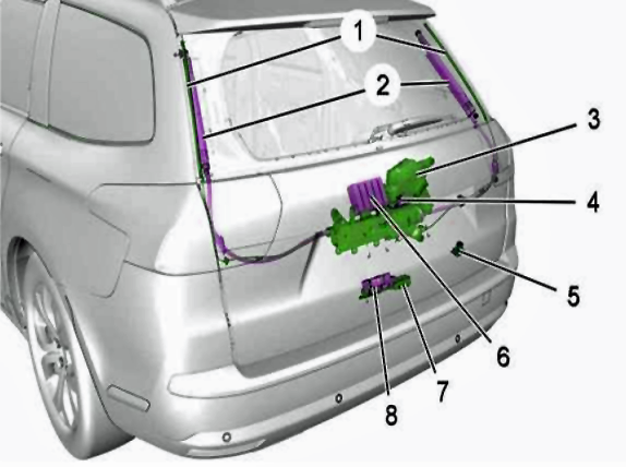

(1) Anti-pinch sensors.
(2) Motorised tailgate balancing strut.
(3) Motorised tailgate mechanism.
(4) Motorised tailgate opening control.
(5) Motorised tailgate closing switch.
(6) Motorised tailgate ECU.
(7) Motorised striker plate.
(8) Motorised tailgate lock.

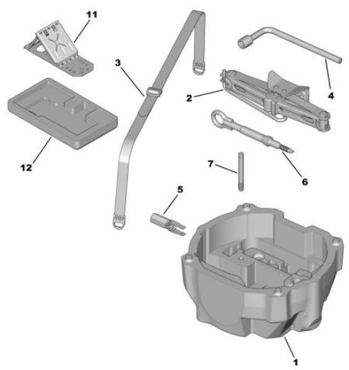

GiveMeABreak wrote: 09 Apr 2023, 21:50 I think you're referring to this lot, which is also supposed to be included when new for your vehicle:
From here:
viewtopic.php?p=751689#p751689

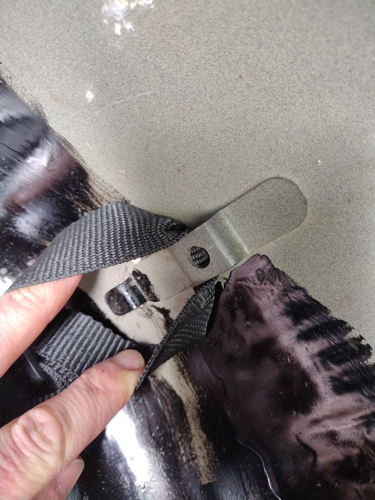

Time to sort it.
Anonymous oval plug in centre wheel well
Mounting points at two o'clock and eight o'clock positions. Straps are new obviously
EBay buckles and 25mm webbing:
Better than nowt!
Polystyrene thing still not actually restrained as shallower than depth of wheel but at least the wheel itself cannot shuffle about so freely now

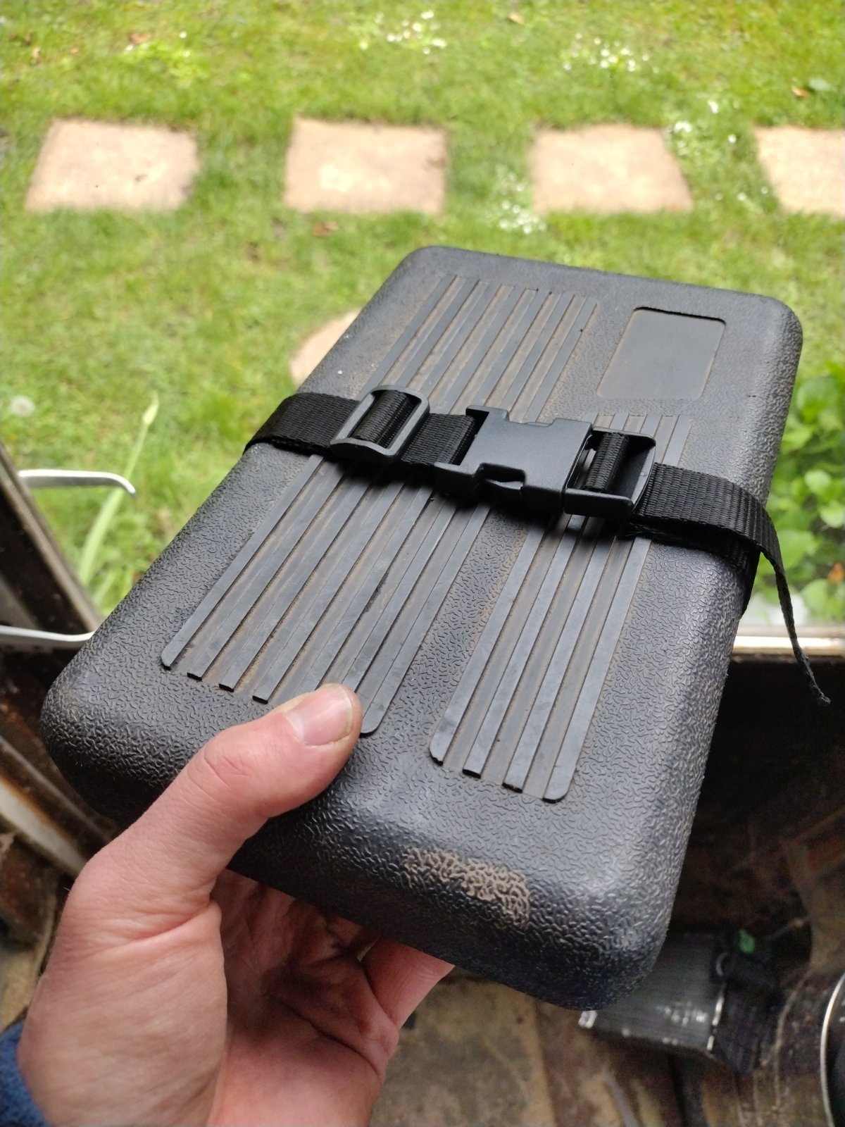

MattBLancs wrote: 21 Apr 2023, 07:36 I've ordered some webbing and some buckles:
I've done my usual "it's cheaper for more and will come in useful" so 30m of webbing and 25 buckles. Need about 1 - 1.5m and 1x respectively!
This toolset had a half hearted clip from new, I've nearly tipped the contents out on many occasions= fixed with a bit of the new strap and a spare buckle - it's coming in useful already!! :-D

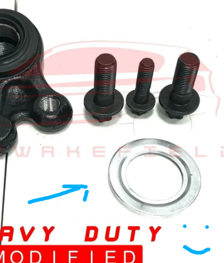

C5, a quick dig on catalogue ssg Asia site:
FRIP bearing: 3640.69
Video in discussion here: viewtopic.php?p=559987#p559987 chap mentions a protector "washer" being from a Peugeot 508, but the parts catalogue suggested "swivel protector" 3623.26 should be fitted to my C5.
No plentiful sources of them online (this is nearest I have found = https://peugeotcitroendsparts.com/peuge ... or-362326/ £2.57 each (Inc vat but think + delivery cost)
So decided to seek out some FRIP that come with this cover included, hence:
Buy it now has occurred! :)
This bit!
This bit!
