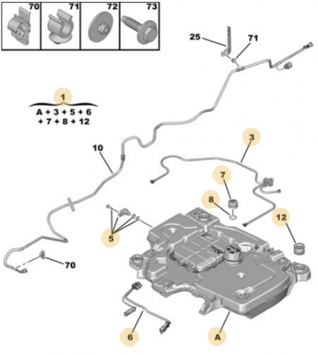

No wish to derail this thread off topic but in the HGV industry the AdBlue has been about for years and when it dries it goes into salt like crystals which blocks both the injector and the pump, expensive to replace £2-4k depending on marque and that is using approx 22 litres every 3 weeks.
When it flows it is okay, leave it a stagnant it causes problems, HGV dealers are like Car dealers, replace do not fix
- x 6948
Re: Does anyone run a C5 X7 diesel estate?
Yes, but this doesn't go anywhere near the injectors Colin - it gets injected into the SCR Catalyst from a separate tank - nothing connected to the fuel or additive tank so I can't see how - it only treats the NOx gasses, nothing else, so I'm not getting that at all

Marc I meant the injector that delivers the Ad Blue gets blocked
- x 6948
Right - with you now Colin. To be honest, I've not heard anything thus far about these in the 6 years they've been out - so will be interesting to see if any faults start developing.
