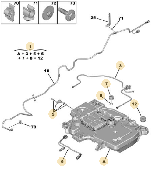

Adblue has nothing to do with the DPF John, it is for the SCR (Selective Catalytic Reduction) part of the treatment before the DPF stage. Have a look at this video -it should explain it:

So AdBlue is in addition to DPF Additive John. and as you have a Euro 6.1 standard X7 (2015) you should have a separate reservoir for the SCR system:JohnD wrote: 12 Aug 2019, 17:58Is the Adblue in addition to the Eolys fluid or in place of?GiveMeABreak wrote: 12 Aug 2019, 16:38 Of course from 2013 the Blue HDI models with SCR have further NOx reduction, so ADblue urea (cow pee) is used to convert 90% of NOx into harmless water.

No wish to derail this thread off topic but in the HGV industry the AdBlue has been about for years and when it dries it goes into salt like crystals which blocks both the injector and the pump, expensive to replace £2-4k depending on marque and that is using approx 22 litres every 3 weeks.
When it flows it is okay, leave it a stagnant it causes problems, HGV dealers are like Car dealers, replace do not fix
- x 6956
Re: Does anyone run a C5 X7 diesel estate?
Yes, but this doesn't go anywhere near the injectors Colin - it gets injected into the SCR Catalyst from a separate tank - nothing connected to the fuel or additive tank so I can't see how - it only treats the NOx gasses, nothing else, so I'm not getting that at all

Marc I meant the injector that delivers the Ad Blue gets blocked
