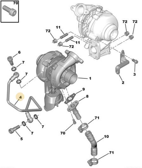

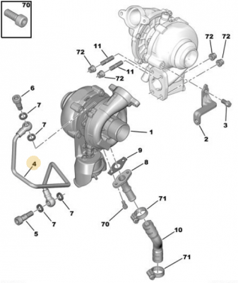

The mechanic's got back to me after fitting the turbo acuator diaphragm as he's discovered where the oil leak was coming from - the turbo oil feed pipe. There's some awful freeplay movement between the pipe and where it enters the banjo union sleeve (top end of the turbo).
I'm quoted £69 (from ECP) for the part alone so I'm trying to source it for less at the moment but I don't have the VIN to be sure of the correct part needed? I think it's 0379 68 which I've just looked up on service citroen (not using VIN) priced £58.34 inclusive.
However, I've also found the same part number listed on ebay for much less but when I select the correct car from the "garage" list, it says it will not fit.
x 6947
Re: C5 2008 (X7 ?) Turbo Fault
Is this Admiral's Ex C5 Mike? IF so I have that VIN still.
If it is then 037968 is the correct one.
These claim it's an original PSA one:
https://www.ebay.co.uk/itm/Peugeot-Citr ... SwUq9bNKy9
... and they quote the correct part number £32.80
MikeT
Posts: 4808
Joined: 11 Jun 2007, 16:17
x 232
Unread post by MikeT »
Yeah that's the one Marc, the car this thread is about where the VIN is obscured from me reading it :D
Stupid ebay car selector thinks it's the wrong part.
