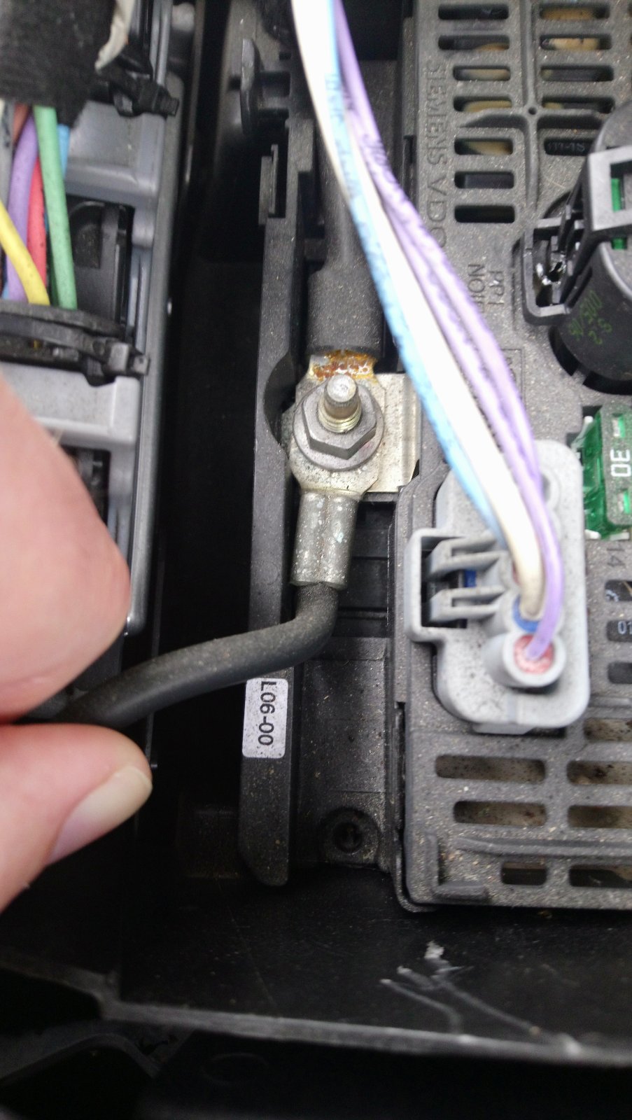

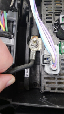

wheeler wrote: 05 May 2021, 19:58 Got it now, The part number is 6500CK & is priced at £266.36 + vat from Citroen.
Hi, so I've been searching ebay for a 6500CK but they not different L numbers. After looking at mine it states a L06-00 as per the attached. Is this all I have to look out for or should their be anymore numbers to review?
Thank you

6500CK is the PSA part number & is not normally stamped or printed on the actual part.
Breakers on ebay don’t normally have the PSA part number listed for this reason.
Is there a 96xxxxxxx number on the fusebox anywhere? This is your best bet for matching up a second hand part.

I can't see the 99xxxxx number I'm afraid as my current one is still installed in the car. Is there any other way of finding this number out?
Thanks again

The fuse box is fairly easy to remove, 1 or 2 nuts and you need to remove the plugs and also disconnect the battery.
Someone on the forum did post a picture of where the 96xxxxxxxxxxxxxx number is on the fusebox but cannot remember who or where.
It is probably only a 20 min job to remove and replace
