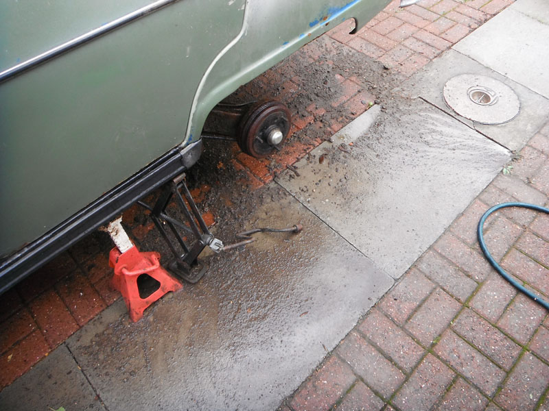

Right so, we have the Renault back at home now rather than at the unit. This is really useful as I now have all the bits of the car in an easy to get to location next to internet access so I can tinker or do larger jobs at my leisure much easier. No more the 8 mile round trip just to do a quick five minute job! Today, Mike and I pushed the Renault out onto the drive so we could have a bit of a sort of the garage and I could get the hosepipe into the rear arches to clean them out properly, the water pressure at the unit is very low so I couldn't do a great job there. Front arches proved to be quite clean as I'd had excellent access when the wings were off to really scrub everything properly.

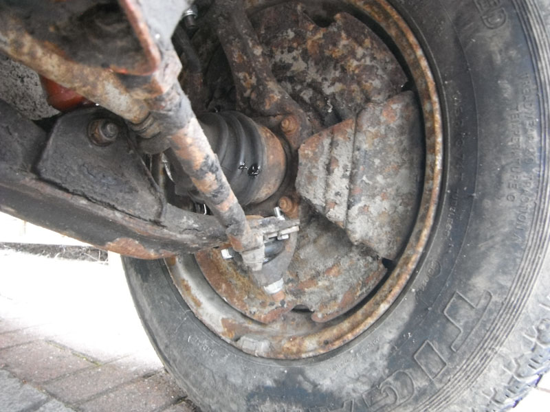

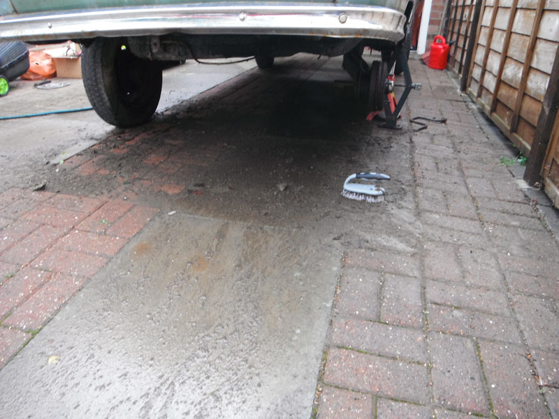

I wasn't really expecting quite as much mud as I found.

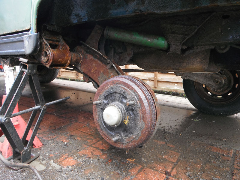

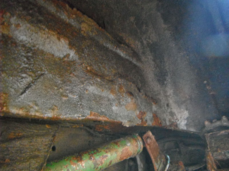

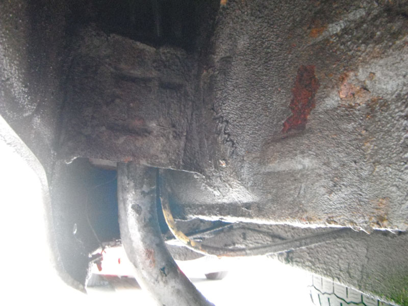

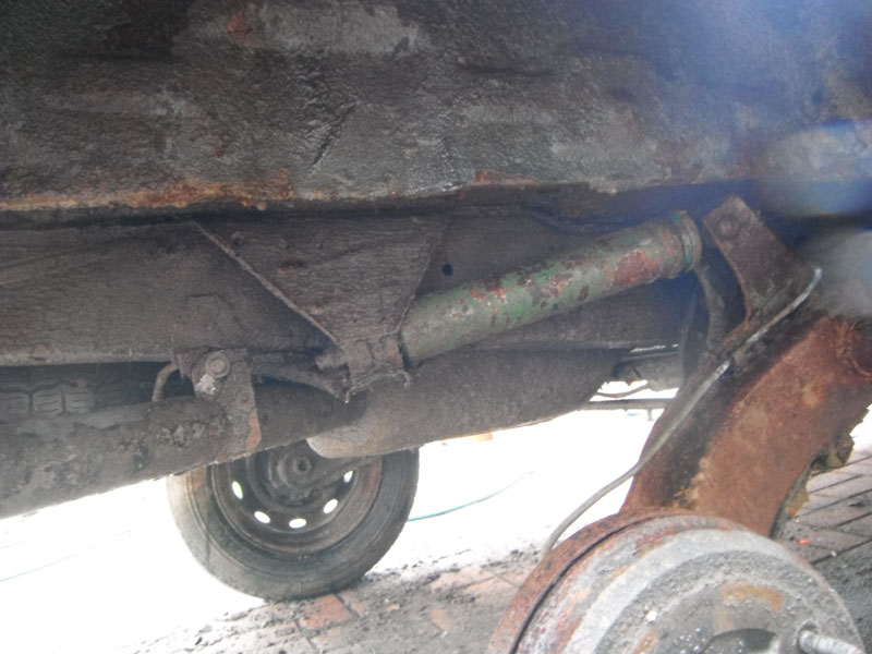

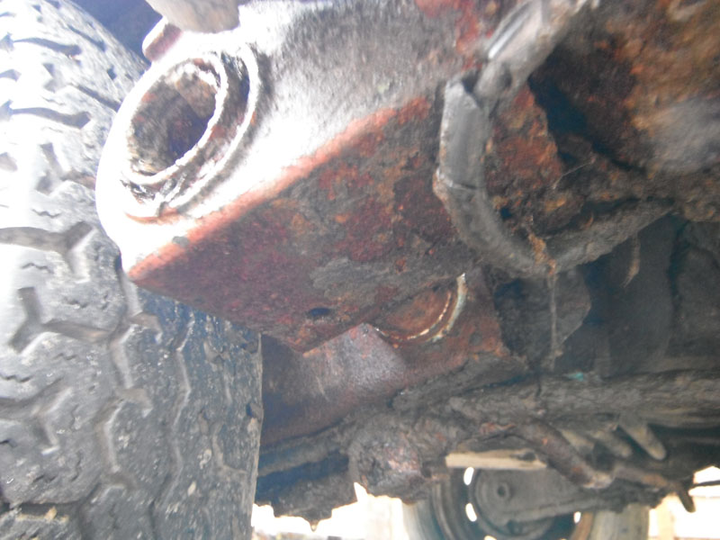

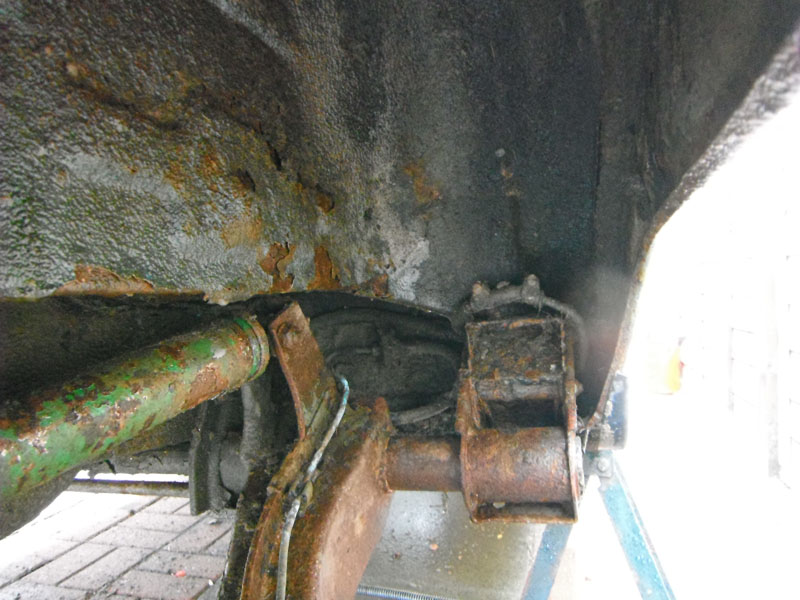

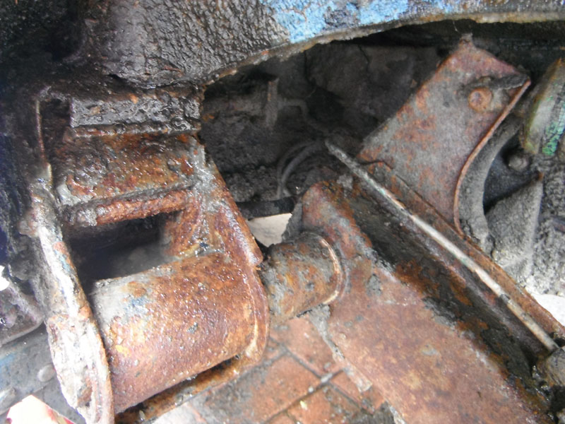

What was nice was discovering just how solid everything really is. The trailing arms and some of the inner wings could do with a lick of paint and some protection to keep things this way but it's all remarkably good. Check out my green rear shocks that were previously just mud coloured.

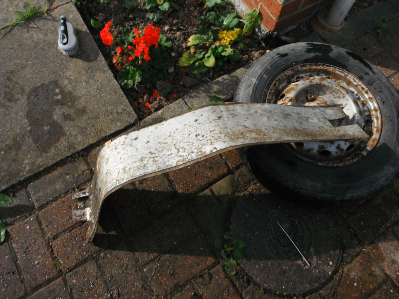

I pulled out the strips of aluminium that had been used as mud guards. I haven't binned these as they'd actually done a remarkably good job of keep the mud out of the upper reaches of the rear arches, there was barely anything above them.
Repeat the hosing and scrubbing on the other side, remove yet more mud.

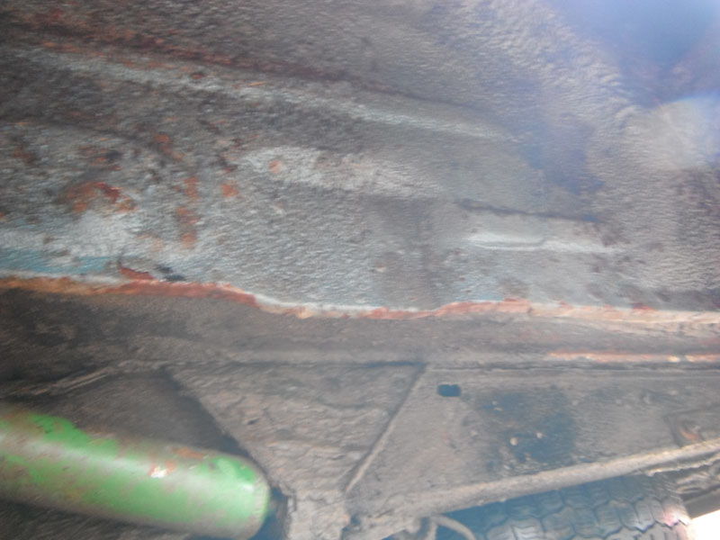

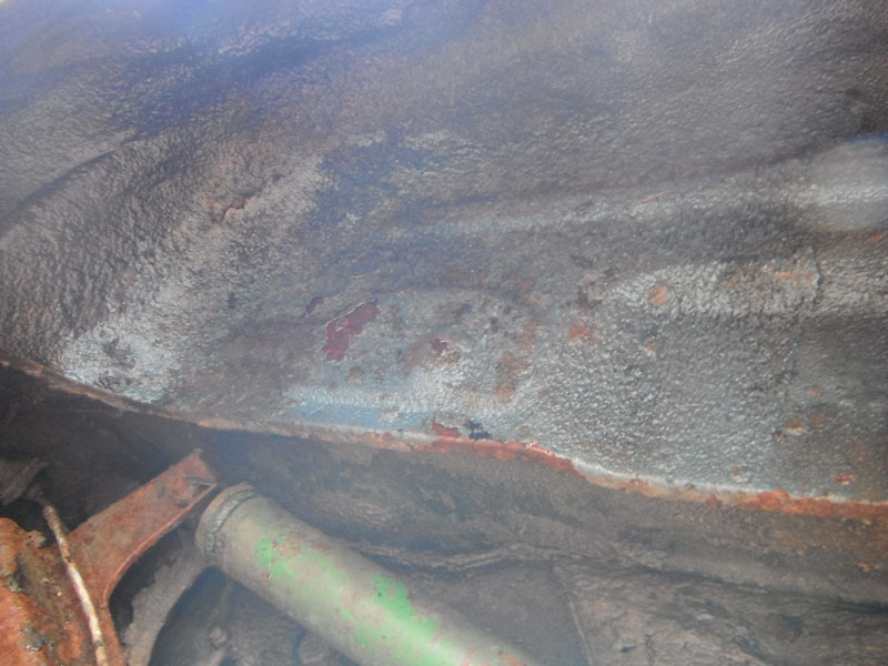

Same story this side. You can see the metallic blue of the bodyshell (which I'm now fairly certain is a replacement) and just a hint of the car's original metallic green on the trailing arm mount.
Again, the inner arch is in very good shape. What's confusing is that there appears to be no repairs or rust holes in the inner arch but there are substantially sized patches rivetted to the inside of the bodyshell. I had thought this was a single-skinned piece, perhaps it isn't?
Filler neck looked quite new compared to everything else, I wonder if it was replaced or if they just last really well.

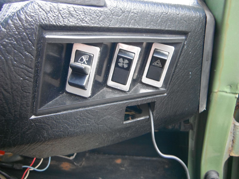

I also found out that the missing switch is for the rear screen demister. So I'll need one of those since mine appears to be wired up, there's just no switch present.

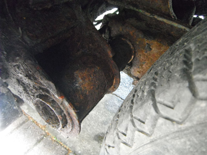

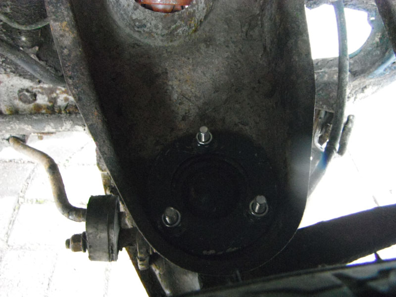

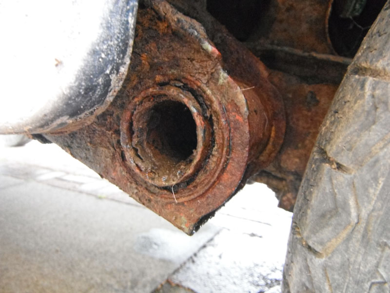

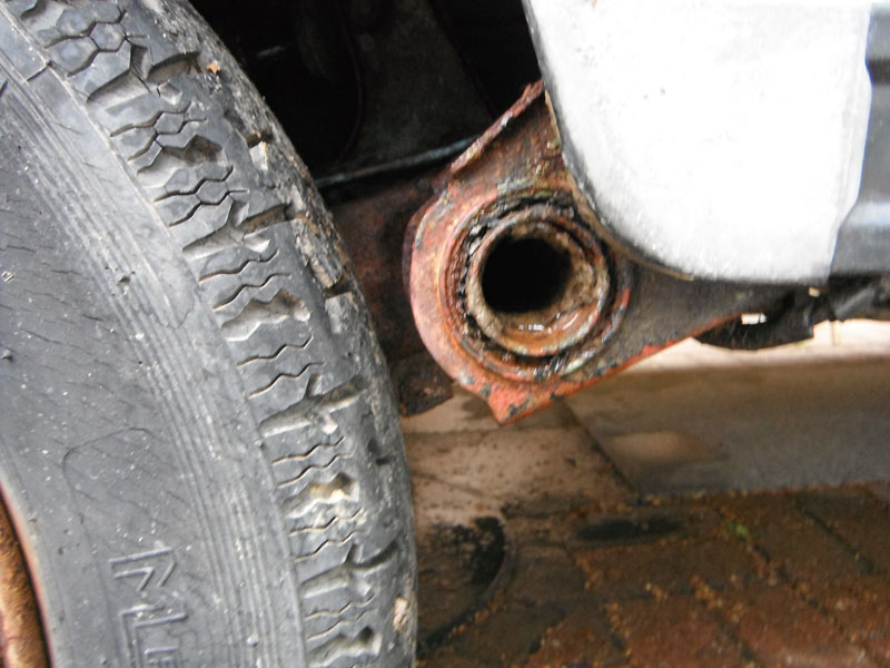

I wondered if there's supposed to be a cap or a plug for the trailing arm mount. I flushed all the mud and rust flakes I could out of the hole. Everything appears quite solid just devoid of paint. I'll get this area cleaned up and given a coat of something to keep it solid, I've been told this is one of the main weak points on these cars and I'd like to keep mine as solid as I can. They look a bit flakey in the photograph but they're really not, I gave them a good poke and it's just the remnants of underseal, mud and detritus stained with some surface corrosion.

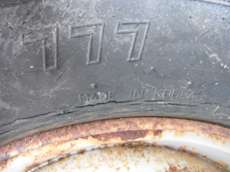

No expense spent on the one not-Michelin tyre. How cheap must this have been in the mid-90s? Marshal 777

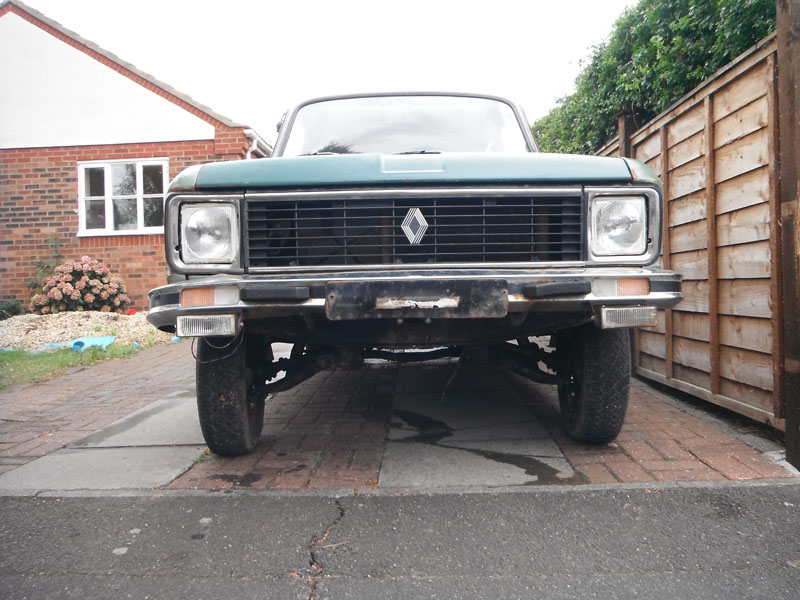

The tracking on the front is off, I think this is because there's no engine or gearbox in there. Lots and lots of toe in and positive camber which can make the car difficult to push to begin with. All the hubs spin quite freely though the brand new brakes on the front definitely need to bed in a bit.
Replaced the bolts fixing the ball joints to the wishbones that had got bent and installed them the correct way around. These are high tensile steel so should be fine. I was surprised the brake dust shields were still servicable as they're made from wafer thin steel.

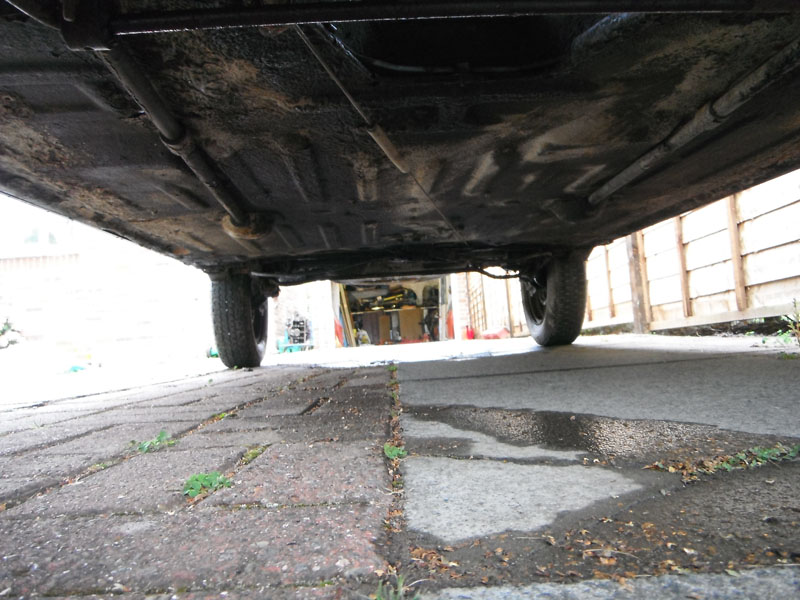

The floor is remarkably sound, well undersealed for the most part and relatively free of mud. This is a good thing.

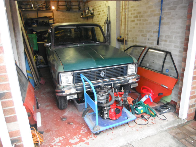

I have enough space in the garage to walk all the way around the car and work on the engine. I'd forgotten about my little blue trolley, it's ideal for moving the engine about. Didn't get as far as doing any measuring today, it was all about getting the Renault settled into its new house.

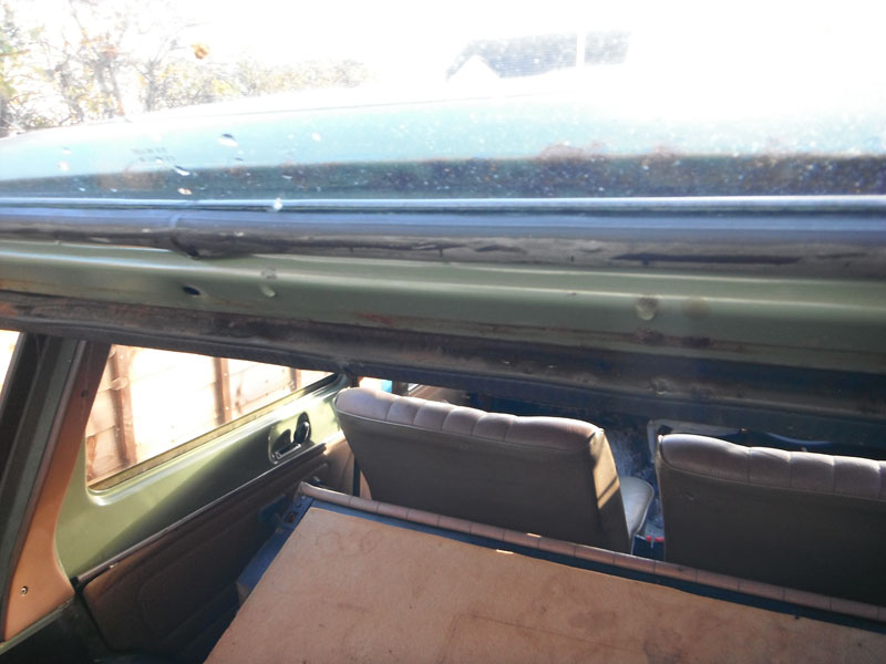

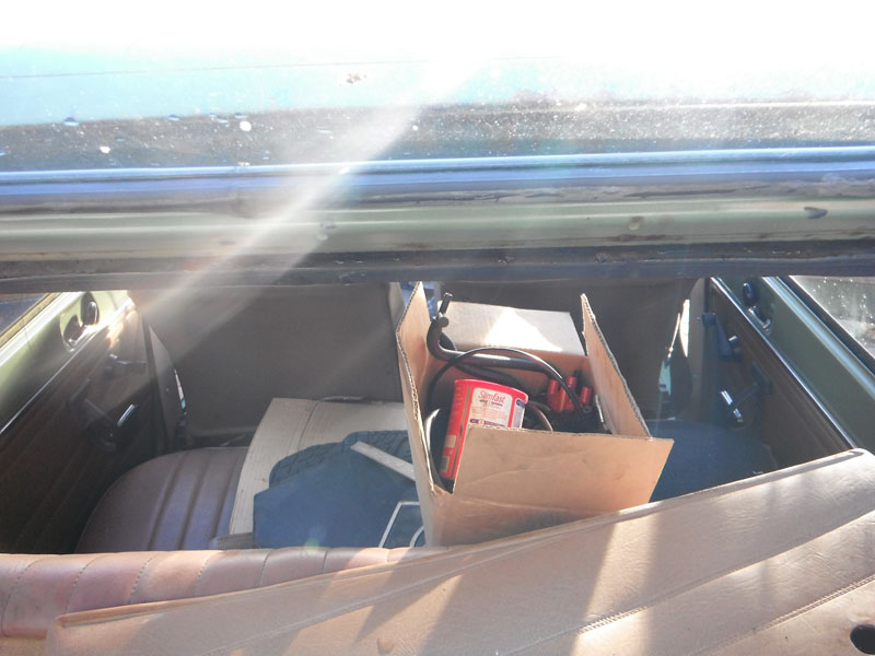

With the Renault outside waiting for the engine to come back, the weather decided to help me with some more leak hunting. Here we go then, a tour of the leaks and what I think I need to do to fix them.

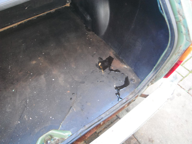

To start with, the boot is still letting water in, as evidenced by this puddle on the parcel shelf.
Taken me a while to figure this one out entirely but it looks like it's getting past the boot seal itself which has certainly seen better days. Looks like a generic profile on the seal so shouldn't be too bad to replace. It's coming in through the rear screen seal as well but nowhere near as badly as through the main boot seal.

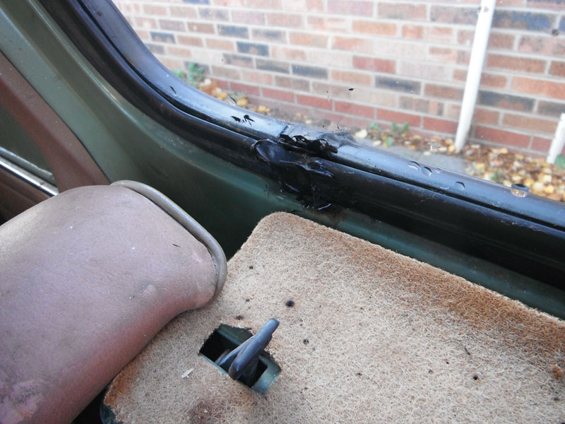

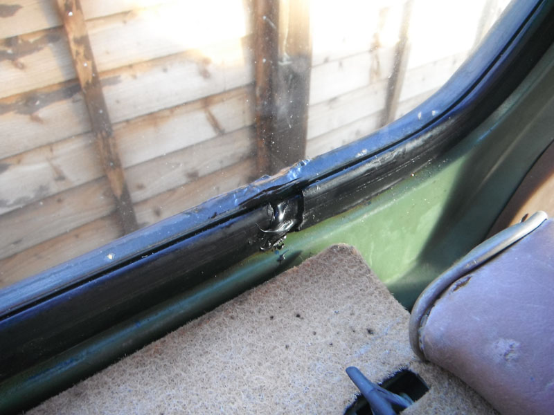

The other puddle is this one.
That's caused by the side windows which also don't seal well, partly because the seals are too short. They just need a blob more sealant where the gap is to sort this. Looks like it's getting through just at the bottom edge of the sealant bridge. Really I should fit new seals to these rear windows to resolve this and again they look like a generic profile so I might do that in the future.

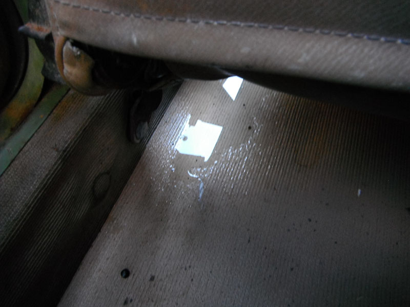

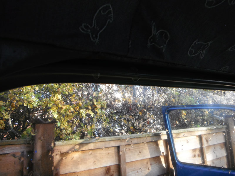

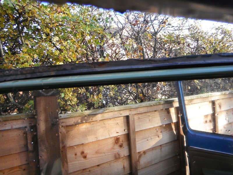

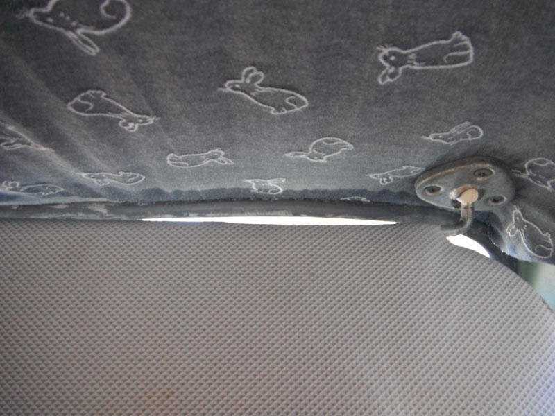

Next, this big old lake under the passenger seat. Here's where we get into the territory of difficult to locate leaks because on the passenger side there's a lot of them.
Most of it is coming through the top of the rear door.

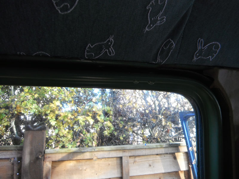

Mainly because the stick-on seal (factory standard as far as I can tell) is knackered on all the doors and more knackered than the rest on this one. Admittedly, having gutters on the car would help lessen this as the water would be channeled away from them and I have priced up replacement universal guttering to do just that. Door seals will help too anyway in keeping the water out on the move.
The windscreen had appeared to have stopped leaking. Unfortunately that isn't the case and it is still letting water in along the top edge. I'm going to squidge more sealant into the top of the windscreen seal as was done when I got the car. At least with a cloth headlining I can see where it's coming in and have some idea of where to put the sealant. So, passenger side first which again is the worst side.

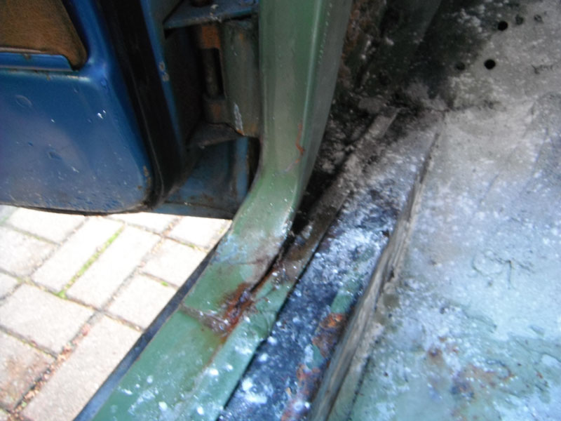

The door seal on the front door is also shot, the door doesn't fit as well as the others either, and that's letting water get in at the sill.

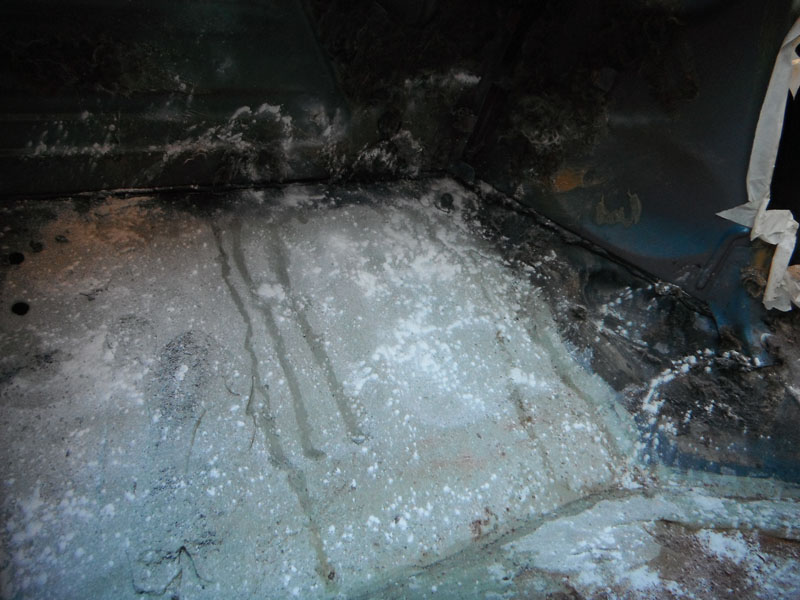

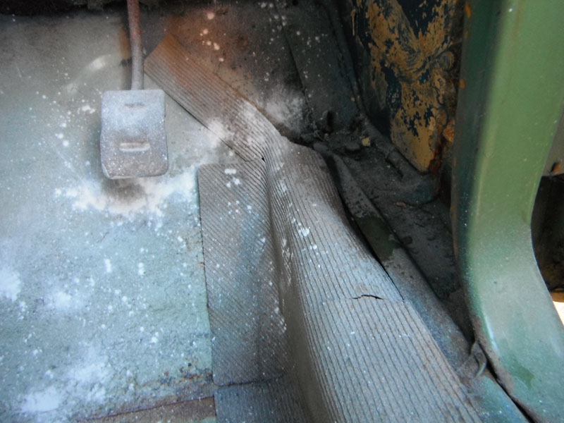

What was confusing me was that water did just appear in the footwell on the passenger side and I could never figure out how. Liberal poofing about of talcum powder highlighted just how it's doing it. Water is running down the outside of the bulkhead and then seeping through the body-to-chassis seam and into the car. That's more difficult to resolve, to do it properly it's going to be a body-off job so I can put some proper sealant/tape on before bolting the body back to the chassis. The bulkhead above this seam is completely dry.
Driver's side of the windscreen is also letting a small amount of water in.
As with the passenger door, the seal is shot and water is getting in and pooling on the sill. There is another drip from under the dash somewhere just to the right of the pedals and I've not figured that one out yet. I might have to fix the other leaks to find it. There is a small splash to the right of the pedal that highlights the leak, it's not massively clear in the photograph.
