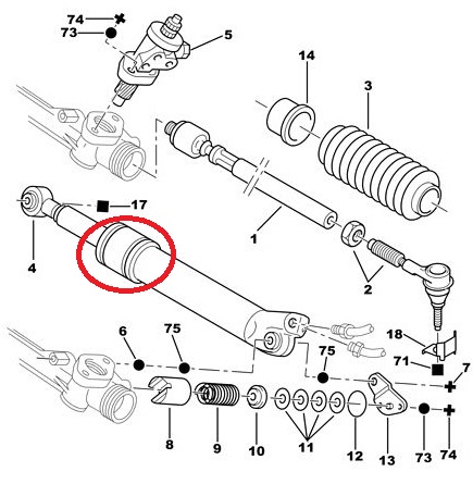

Anyone knows if you can get this part (marked red)? It's the return collar from servo cylinder, just like one for activa cylinder repair, but it's different in diameter.

Found it (http://www.frenchcarforum.co.uk/forum/v ... hp?t=33056" onclick="window.open(this.href);return false;).
Part number: 95 640 212, cost: 9,66 eur.
Jolly nice.

That's the XM one. It's identical (as far as I can tell) to the Xantia one but never listed. Odd
As you say, the one used for ram repairs...

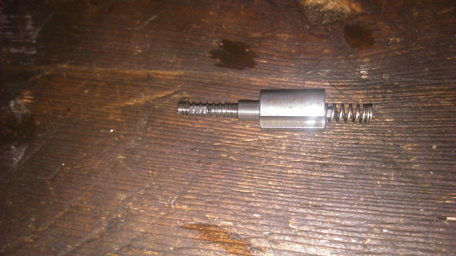

Well I finally managed to fit tecnosir valves to my spheres. First I tested each sphere to see if they have enough pressure and the fitted the valves. Surprisingly none of the spheres was ruptured as I was sure that the front hydractive sphere is dead. Just the anti-sink and front sc.car were a little low (-20bar). I also had spare spheres that I salvaged from the hydractive Xantia that went to bits and also bought a set of 8 spheres for 50eur from a friend of mine. They were in unknown condition, but when I tested them all but one were ok. They are new series (grey) and have three dimples on (multilayer membran if I'm not mistaken). As I had 2 pairs of front wheels spheres with multi-layer membrane, I decide to put one pair on the back wheels. I believe they are the same, as the valve and the hole looked the same to me...
Also adjusted the height. Front was high about 3cm and back was low about 2,5cm.

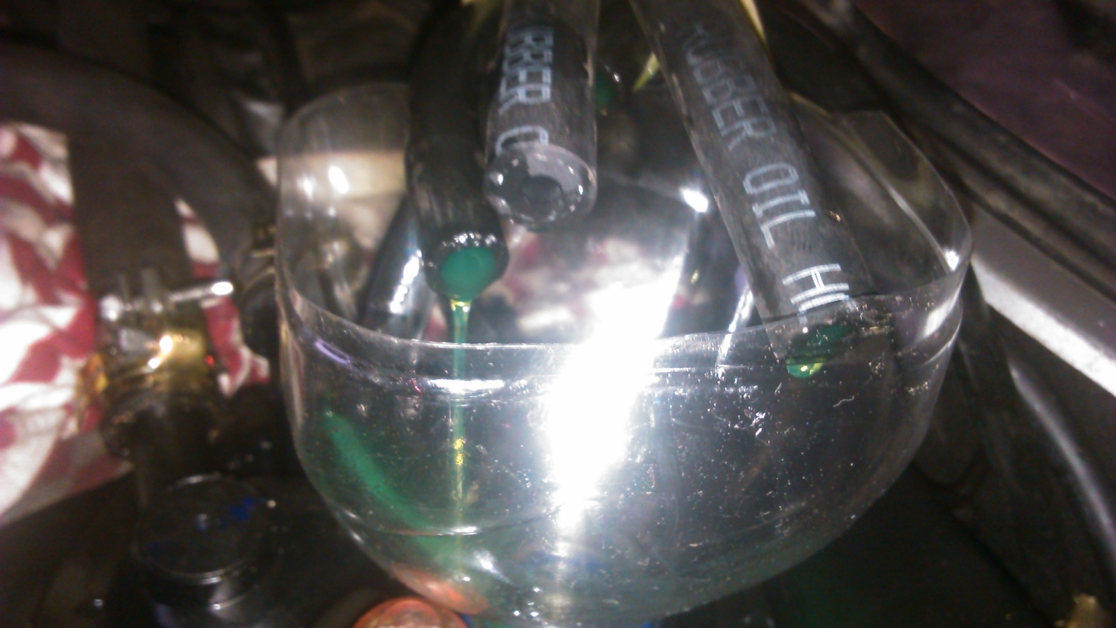

I also played with return pipes that go into LHM reservoir, to try and figure out where I have an internal leak... This is how it looks:
It's pouring out of the two pipes that come from the brake doseur. I changed the o-rings in the doseur about a year ago and I don't think I made something wrong. Maybe the doseur is too worn... Also the front and back electrovalves are leaking in soft mode (only when engine off), although I stretched the springs in the valves:
And the main return pipe (the one that comes from high pressure regulator) is leaking heavily also... I would say that about a litre per hour (engine off of course). I made quite a mess as I forgot how much it leaks and didn't put it in a bottle to leak in peace
Regulator clicks one time per 2 minutes...
And finally I found where it's leaking LHM. Not much, just a drop here and then. I needed half a year to find it! It's the high pressure regulator that is leaking where it's bolted to the engine mount. And LHM slowly creeping down the engine to the sump and then all the way to the back of the sump where it accumulates to a drop. Is there an o-ring that's leaking?

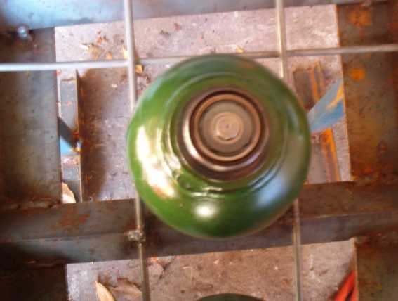

So you don't think the cause for crashy ride is over pressure in the spheres? Well I believe I have the correct spheres as they were taken of a hydractive Xantia which suspension worked fine...
Here is a pic (not mine, but it's the same):
I don't have a pressure gauge, so that's the next thing I must fabricate... Makes sense that if there's not enough pressure in the system cylinders in the suspension bottom out. Is a faulty high pressure regulator a common fault?

I would wait for an Activa expert to update you re. the spheres. I bought 6 spheres off AEP recently, and they asked for my car details to make sure I got the correct spheres.
I just looked in my Citroen manual, and the Activa does use different spheres. The front strut spheres are part number 434510, the rigidity regulator sphere is 395010, and the suspension rigidity regulator is 435501. Other spheres appear to be common, either to hydractive or normal Xantias. Still, I would wait for somebody who knows the Activa inside and out.

We could be waiting a long time JamesHell Razor5543 wrote:Still, I would wait for somebody who knows the Activa inside and out.
On my Activa I use standard Xantia Hydractive Spheres on the from corners and Hydractive Xantia Estate Spheres on the Rear Corners...
It works nicely for me...
